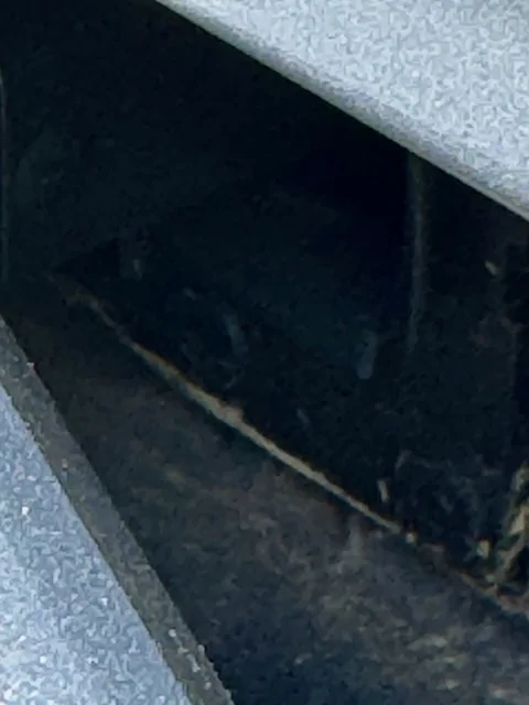

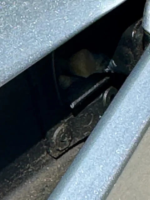

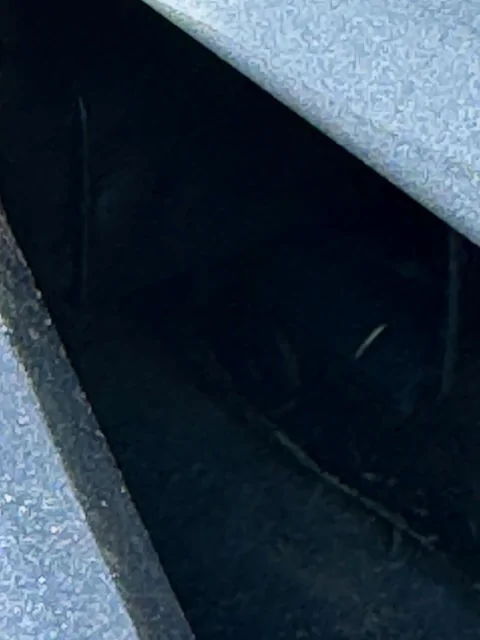

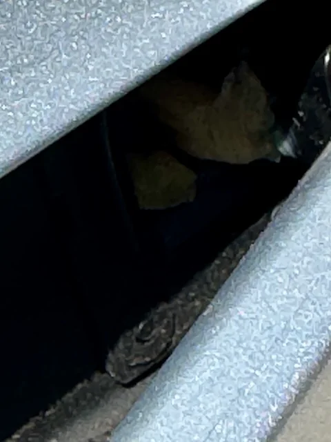

My R1T G1 door handle interior hinges were absolutely packed with grease when I picked it up. Today 18 months later the passenger side is still packed, the driver mostly gone, melted away from the sun probably. Guess which side is a bit noisy.
This thread made me think to dab some grease in there with a long Q-Tip when the temp gets under 95F. Maybe I'll even clean out the passenger side and refresh.
Passenger Front

Passenger Rear

Driver Front

Driver Rear
