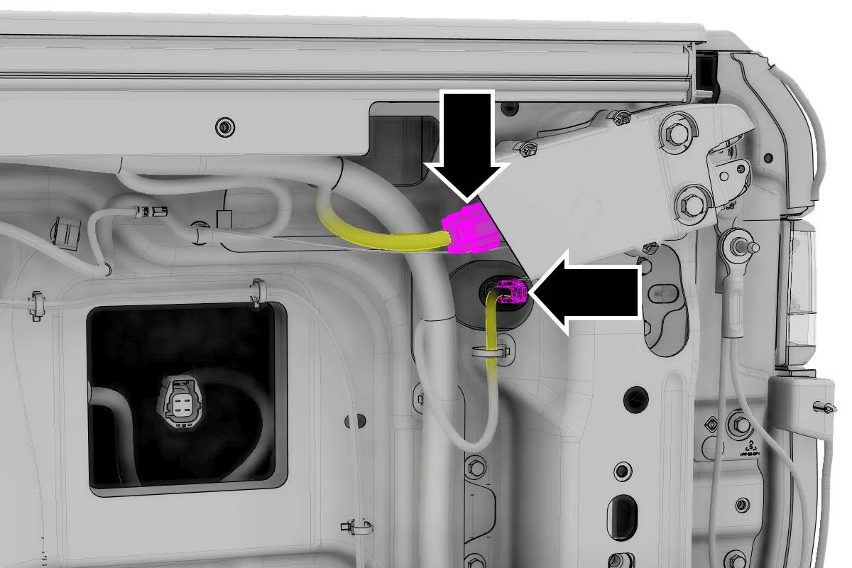

I'm back to having a faulty tailgate latch. Once again, it's only the passenger side latch, and it showed signs of failure before completely going out. Since I'm out of warranty, I assume they'll charge me for any repair despite getting it serviced 4 different times for the same issue, so I'm going to try DIY before asking them. And since they didn't figure it out after 4 tries between 3 different techs, I've lost faith in their abilities with this problem.
Facts:
-Latches have 3 positions; open, semi closed, fully closed
-Driver and passenger latches are the same part, just installed upside down from each other
First sign of failure: Passenger side doesn't fully open, goes to semi closed, so I press again and it opens.
Testing results:
-Once it partially failed the first time, I got about 5 more closures and openings before it completely failed
-If I unplug the latch and replug it, it'll actuate normally from either semi or fully closed position to open no more than 5 times; I tested it like 10 times and it was random how long it lasted before failure, but never more than 5
-Once it completely stops opening, if you manually push it closed, it'll read the tailgate as closed
-Tucking the latch away in the body void and using just driver side latch doesn't affect it, and keeps me from having a tailgate down annoyance
The fact it reads as in the closed position tells me the electrical/comms are fine. Power cycling the latch enables it to work a few times, but it always fails, makes me think it's a software issue. Next time I mess with it, I'll swap the passenger and driver latches, that'll tell me if it's an actual part issue or a wiring/software issue.

For those suffering from latch madness, check to see if your wires are exposed on the connector pinned into the latch. Apparently those are NOT supposed to be showing, and older harnesses have less give/more tension, resulting in tears, rips, and bends. My first repair was a zip tie holding it tight to the latch, which bent the wire, and has caused these signal problems.
Harness is replaced, hopefully no more problems with this! But I feel validated for diagnosing wiring issue, and I'll likely try DIY fixing any wiring problems myself in the future. The harness itself is only $221, and looks pretty simple to replace.
