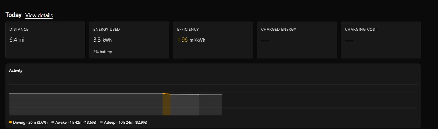

Do you have a Rivian Roamer account? if not, create one (free should work but I would definititely consider the pay subscription and it adds lots of value for the money)and monitor your truck for 24hrs and watch the Activity bar on RivianRoamer's dashboard:
Rivian R1T R1S Tail lights keep blinking 1775064827400-37
You can clearly see the SLEEP/ Driving/ AWAKE /SLEEP cycle mine has here. This is perfectly normal.
But, if it goes (let's say) 12hrs straight without a long sleep session, then you might have an issue.
Last time it was solved by a OTA pushed update (no involvement from the service center) and I believe it only affected Gen1.
One test I would do, is try opening and closing the Tonneau Cover and see if that works normally (mine and several others didn't operate normally while having this issue).
This might not solve your issue but it'll give you more info on what you're dealing with (Same issue as last time? maybe a new one?)
Finally, if you want to sign-up for Rivian Roamer and you would like to use my referral code, https://rivianroamer.com/join?with=mudo you can do so and we both get a $5 discount :)
Keep us posted!!
-Aldo

Cool, then monitor the sleep time during the day today and if it doesn't sleep at all, then I would keep it plugged into an L2 charger. Otherwise the 12V battery will suffer

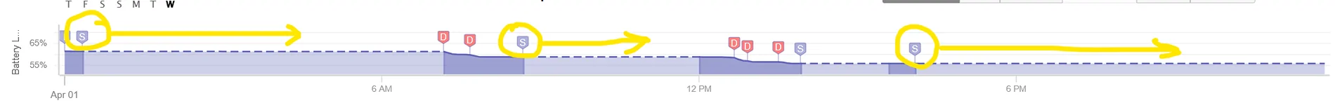

If the vehicle is not going to sleep, then yes - you're going to see that high drain and potential 12v battery damage. RR, ElectraFi, etc., can help you monitor.
Iirc, this issue last year was caused by vehicles trying (and failing) to communicate with the cloud server. It was a back-end issue that they resolved quietly, but not before several people needed their 12v replaced.
Here's how normal sleep cycles look on ElectraFi, for reference:
Rivian R1T R1S Tail lights keep blinking 1775102048348-6d
