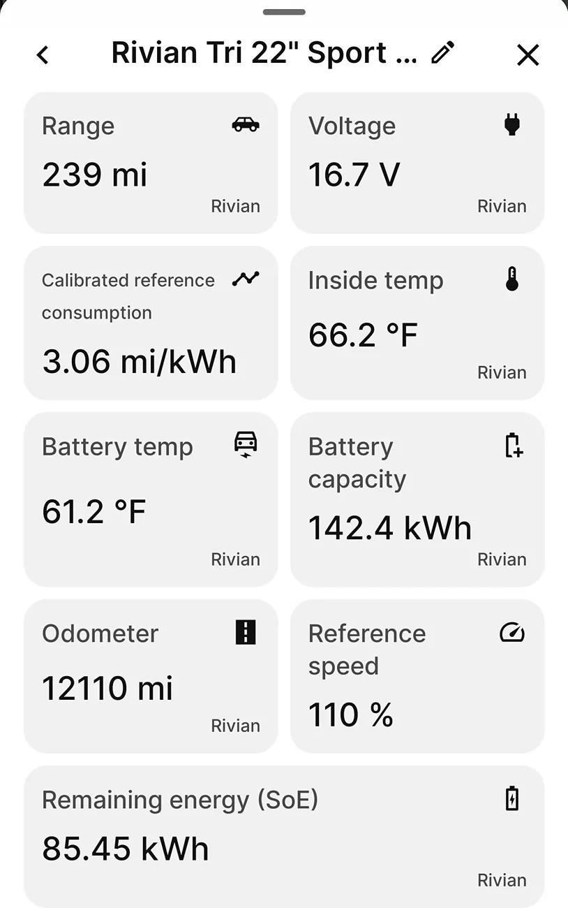

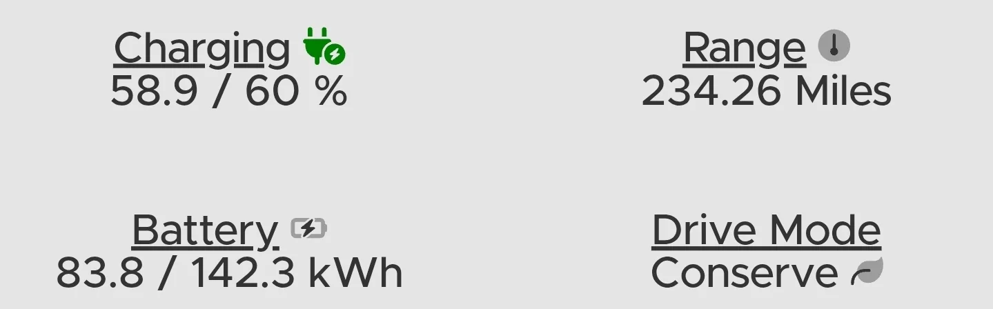

the number of total KWH is identical to ABRP app which owned by Rivian?
