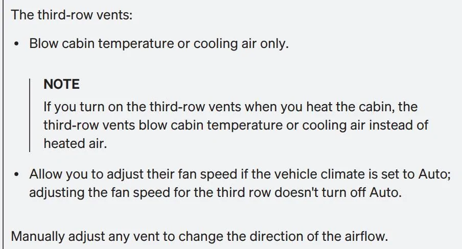

The third row fans just circulate cabin air. They are not ducted to heat or cooling air from the climate control system.

Did you read the thread? It can also do cooling air.
Yes it is...

Yes it is...
I understand this for Gen1 - where there's separate resistive heating elements for heating AFIAK - for gen2 it would be interesting to see the duct/heat exchanger layout - as this would be a pretty interesting design to only support active cooling.
I do wonder if they are using `cooling` to refer to the effect that moving cabin temp air has (ie increased convective transfer), but then it would seem odd to call out cabin temp air. Alternatively there must be a plenum/active blend doors somewhere to redirect the air source for the rear vents depending on if cooling or `heating` - but that seems unlikely..

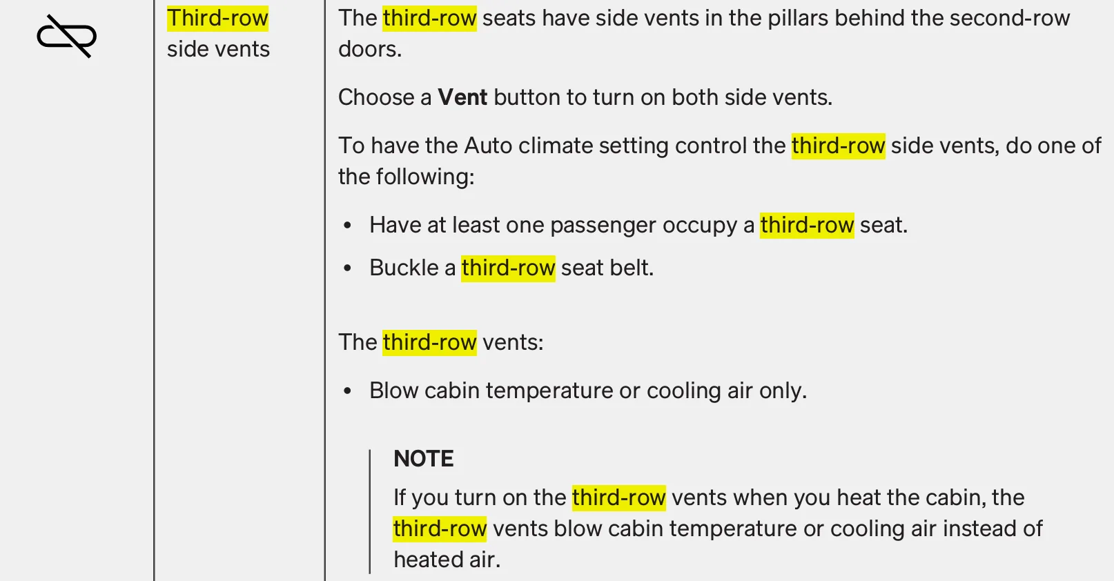

Same note for Gen 2...
The portion saying you need a passenger in the third row is old and no longer applies. I use the vents all of the time with the third row folded to keep air circulating in the back for the pups. It changed when they added the third row tab on the HVAC screen.
Yeah - I checked that as well to see if different. Honestly I think it’s creative phrasing from Rivian - our rear vents in our R1S don’t appear to be connected to the HVAC in any way and just recirculate cabin air. Folks that have installed a new subwoofer should probably be able to answer authoritatively what the ducting looks like behind the panel.
