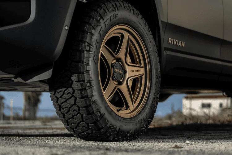

Just ordered some Maxxis RAZR AT tires. Love Maxxis mountain bike tires, so had an emotional attachment.
They’re 60lbs… so hoping they don’t completely ruin my range!!
Rivian R1T R1S Time For Some New 20" Tires IMG_0257
Greg Chick
Greg
Jan 27, 2023
916
654
Tehachapi Ca. 93561
diyplumbingadvice.com
R1T Quad, large battery, 21" Adventure
Retired Plumbing Contractor
Do they come in 21"?
