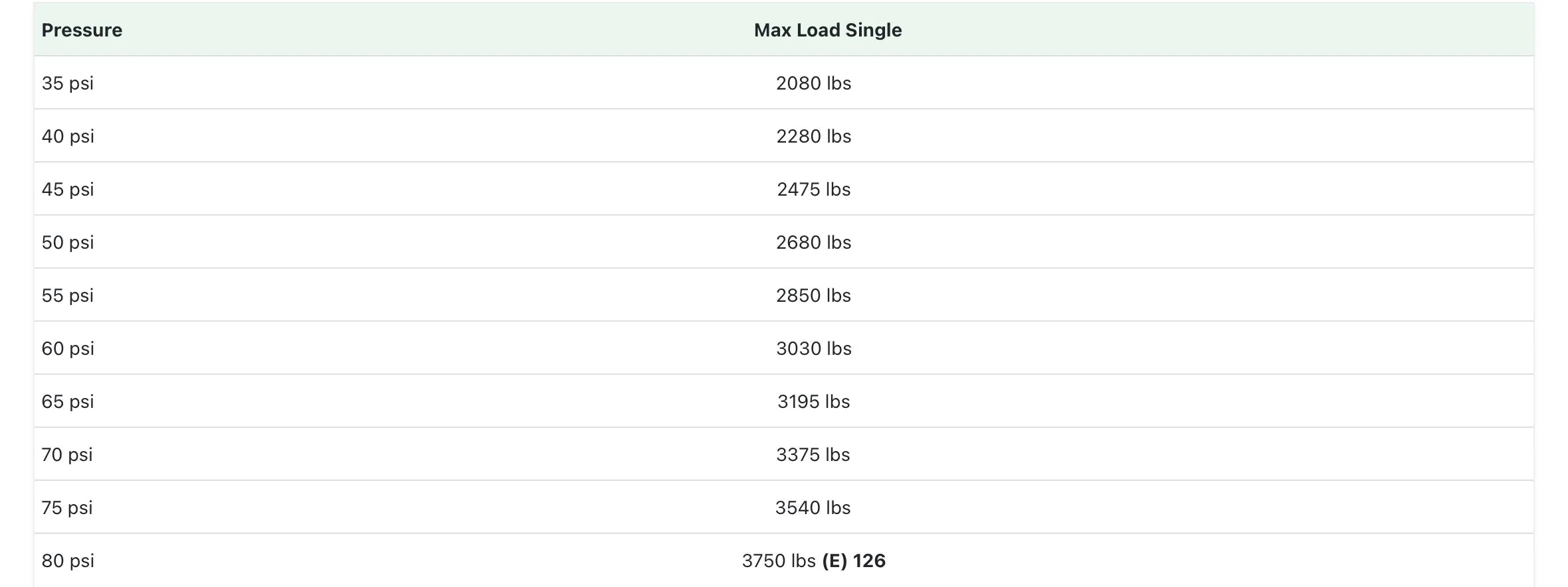

You should inflate to 50 psi because the weight of the vehicle you are mounting them on has not changed from the old tires. Air is what carries the weight from a simple physics perspective. Empty tires at zero psi carry zero weight no matter what is written on the side of it. You can go through the math which is pretty simple. Contact patch in sqin * 50psi *4 tires will give you the carry capacity in pounds. If your GCVW is higher you need more psi. If your tires are only rated at 50 psi you need tires rated to a higher maximum pressure.
The rated contact patch should be available from the manufacturer and is based on the speed rating of the tire. You can run the tire at a lower pressure of course. For instance off road you can run them at 25psi for more traction. The tire still carries the weight because the contact patch has gotten larger. However the speed rating has gone down by a large amount and exceeding it will overheat the tire and it will blow. You can run the tire at a low pressure if the vehicle is lighter or the contact patch is very large due to it being a larger size tire.
Changed to LT tires (AT Revo 3) and they carry 2475 lbs @ 45psi, which is good enough for the rear GAWR of 4960 lbs (/2= 2480).

That doesn’t seem quite right, suggest you do the pressure - temp test. Make sure cold is ~46, and hot is 50 or less. If you get more than 4 psi change then your pressure is too low. Move to LT should increase your pressure by at least 5 psi (so 53 - 55 cold would be ideal). Some run the LTs higher to achieve better economy. That tire looks like a great choice at only 51 pounds, would like to see what kind efficiency you are getting. Past 1,000 miles of mixed driving I have 2.36 mi/kWh on the 20” AT Scorpions. Guessing yours will drop slightly (maybe 2.2?).
Ced
Mar 16, 2019
57
New York
2023 Rivian R1S AT
I get 45 cold / 47 hot. Have some efficiency data I’m working on before/after install. Btw, was able to go back to soft suspension setting with the LT stiffer sidewalls and have nicely controlled handling vs the all-seasons they replaced.

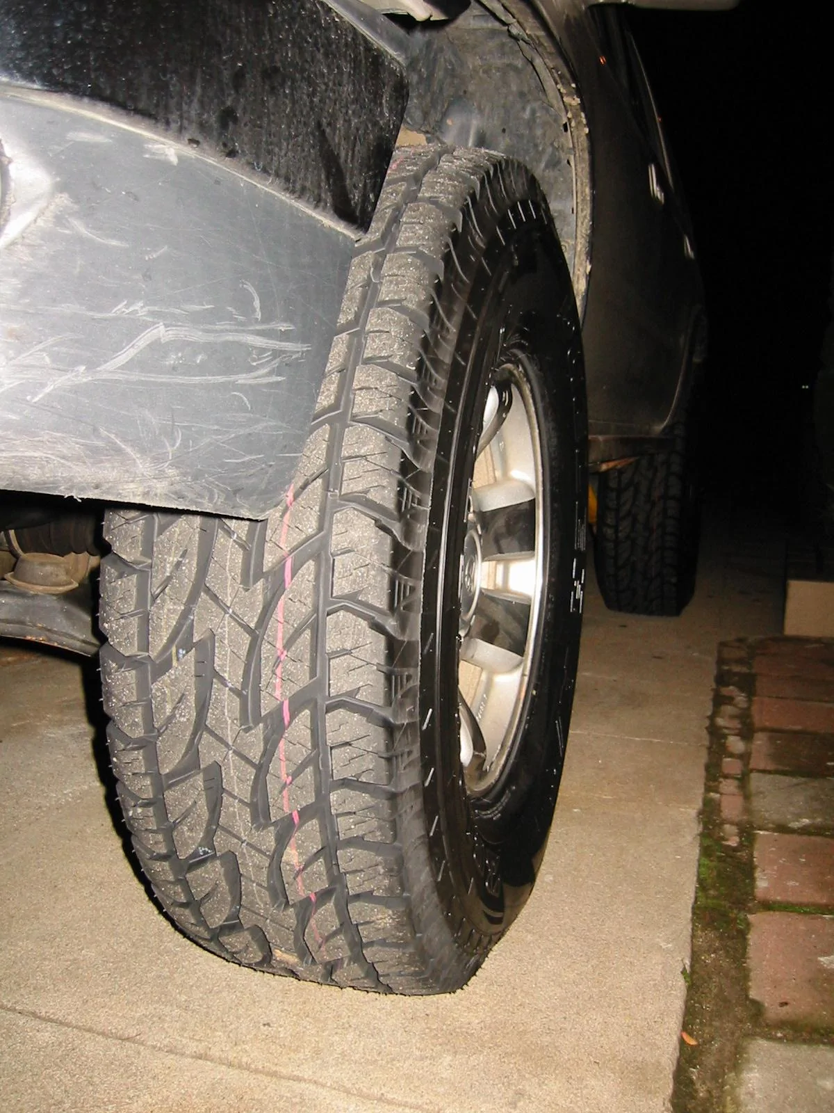

I had a few sets of revo tires. Really well made and a serious AT tire. Road manners were good for and aggressive AT. They have a lot of tread and last so will eventually go out of balance. It's worth getting heavy tires rebalanced every 20k-30k or so. Passenger tires don't have that kind of mass and tend to keep bal better. That's independent advice from the Bridgestones themselves. Many tire shops will say it's not needed but you'll notice a big difference again. Worth the little money to do it when you have them rotated.
