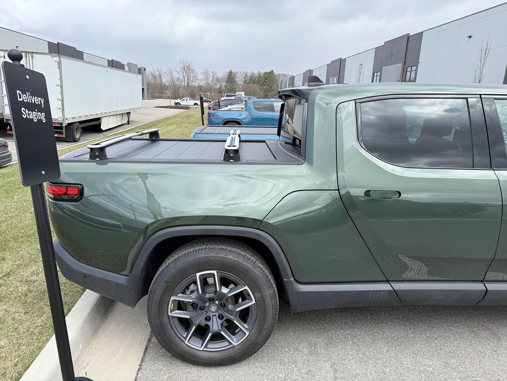

Hi all, I searched and didn’t quite find the answer I was looking for.
So I just swapped over to some gently used 20” wheels with Michelin LTX 275/60/20/s
The truck previously was running the 21s that it came with (275/55/21)
The service center switched my truck to the 20” wheels in settings, but it looks like the 21s are much much closer in size to the 20s with these tires.
Would you run the 21 settings in the settings menu to keep speedometer etc most closely calibrated?
my speedometer was 3-4mph off compared to google maps on the way home which I wasn’t crazy about. I think 2 off is normal
thanks in advance!
