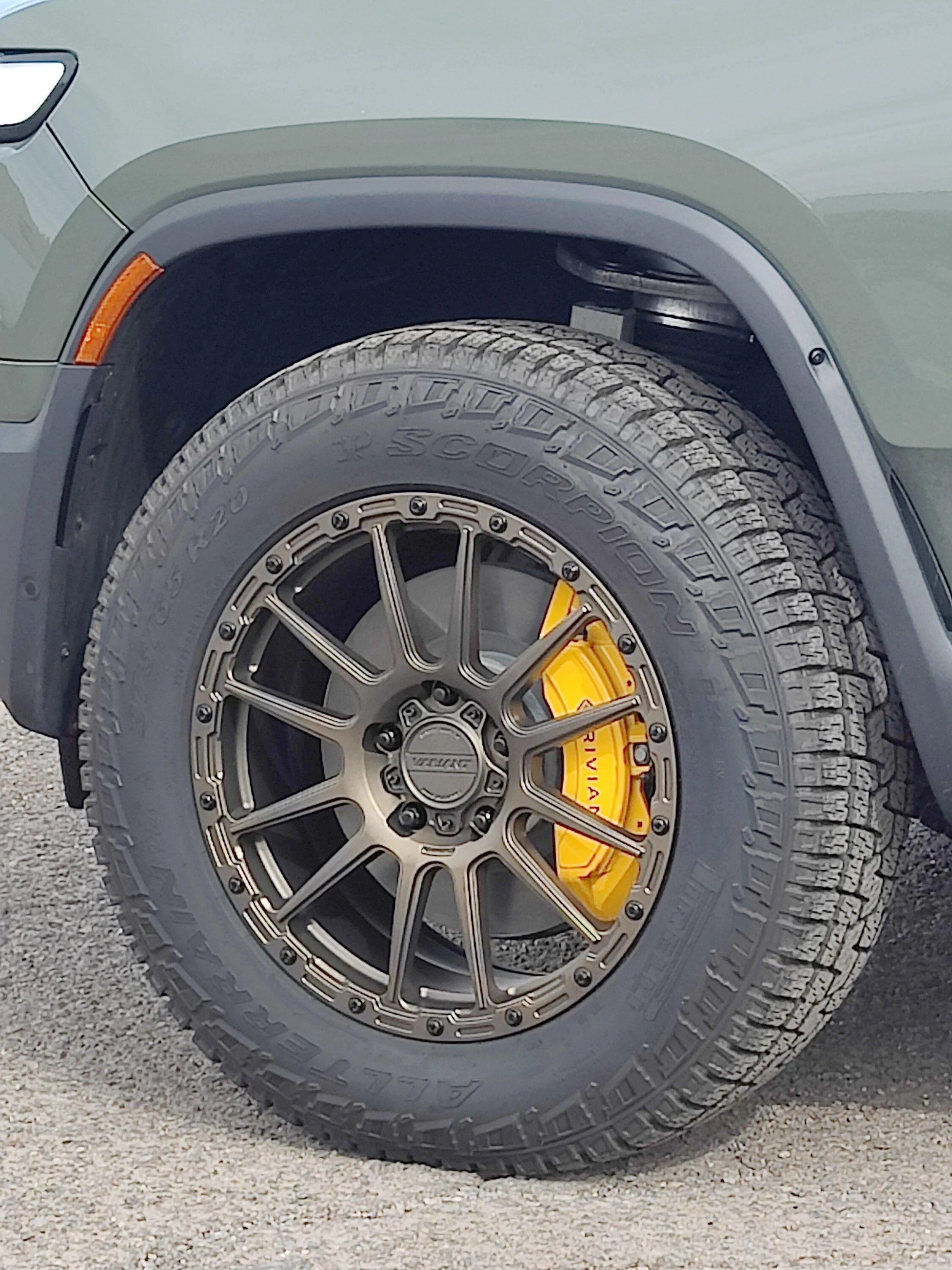

I rotated mine when I installed my new wheels (5K miles). I tire gauged all four and they looked perfect. I'm going to move up to 6K miles (20" A/T) now based upon great wear patterns.
