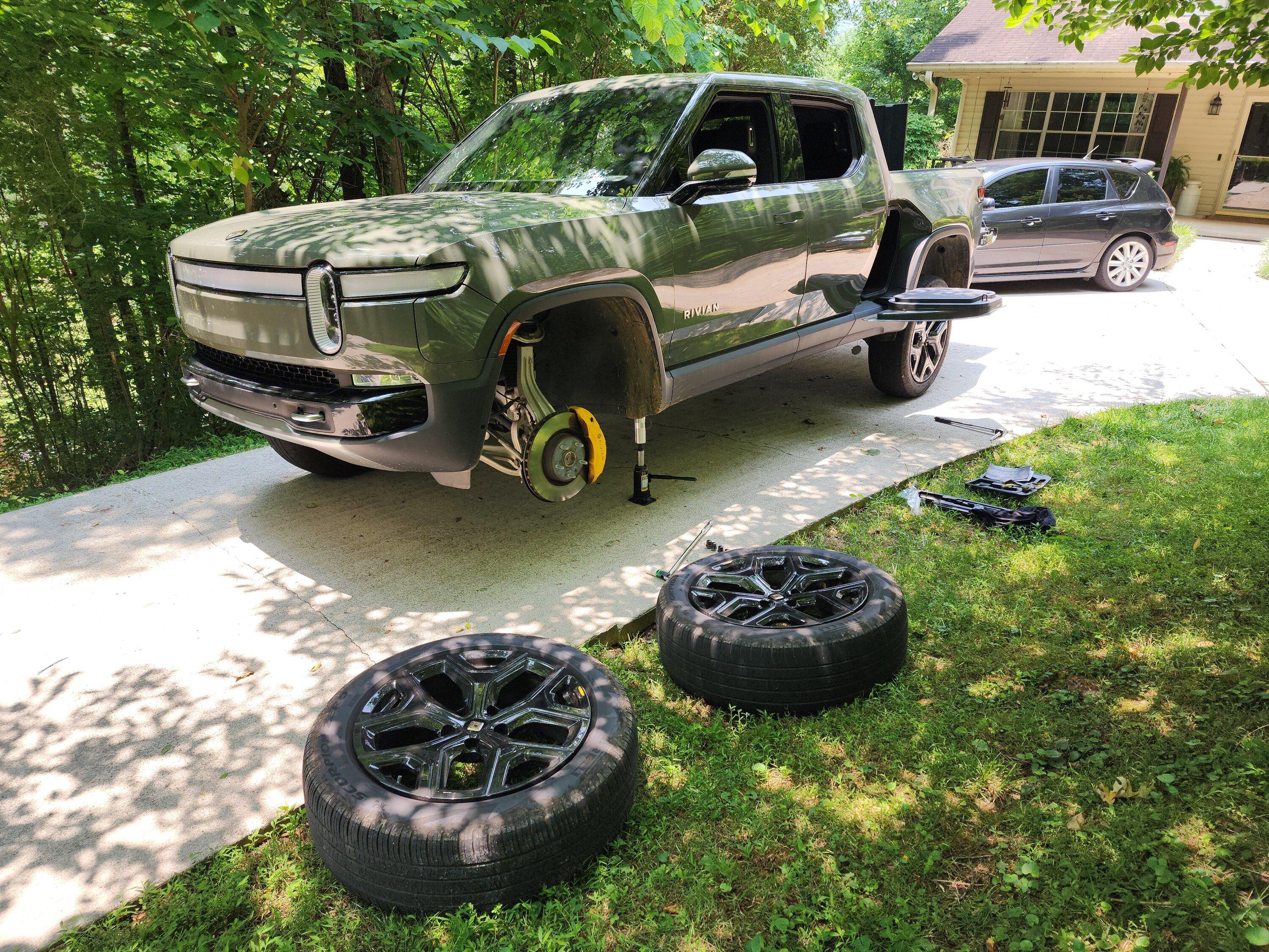

I have done two rotations now myself.
Only real notes would be...these wheel/tires are HEAVY. Use caution.
And...lug nut torque spec is much higher than I am used to in my other vehicles so just be ready for that.
Well done, sir. What hardware do you use for rotations? There are several other threads about bottle jacks and lifts. I'd be interested in the DYI rotation (and winter tire vs. all season swap, with each on its own set of wheels) if there's not a lot of extra hardware I have to buy (and fit in my garage.) Thanks in advance.

I was fortunate to be able to put a 2 post lift in at my house a few years ago, so I am cheating. But...used to always do them myself before the lift on all my cars(dont like shops touching my wheels more than they have to, as the tend to mess them up), so I would jack up a corner, put the temp spare on, drop it, move to next, etc...if no temp spare or full, then leave one corner on a jack stand and jack up other.
I do have the magnetic Jackpucks from jackpucks.com and they work awesome.
I use a torque wrench on the lugs that I got at Harbor Freight.

Very good, thanks for the info. Will have to look into the jackpucks and bottle jack options.
