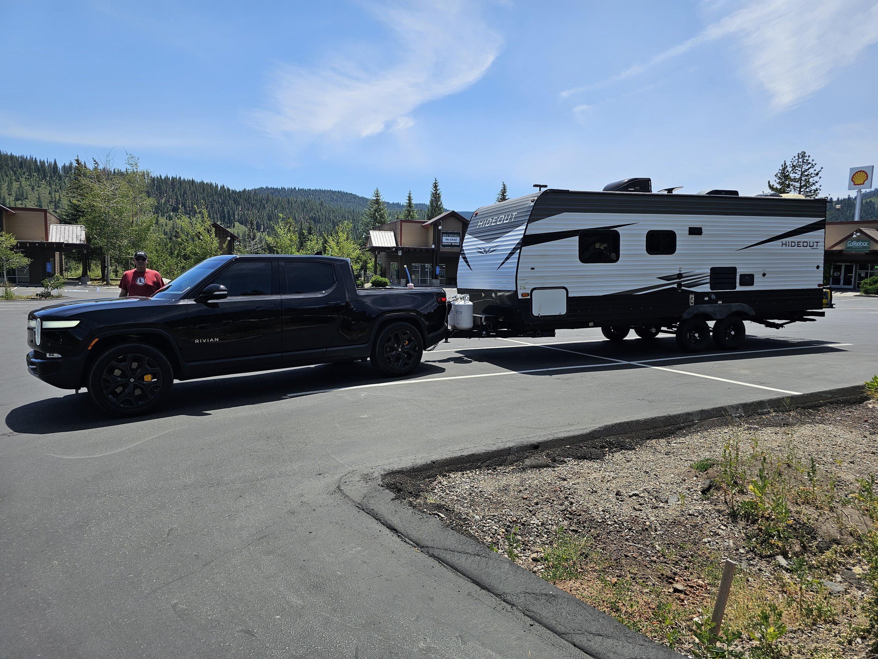

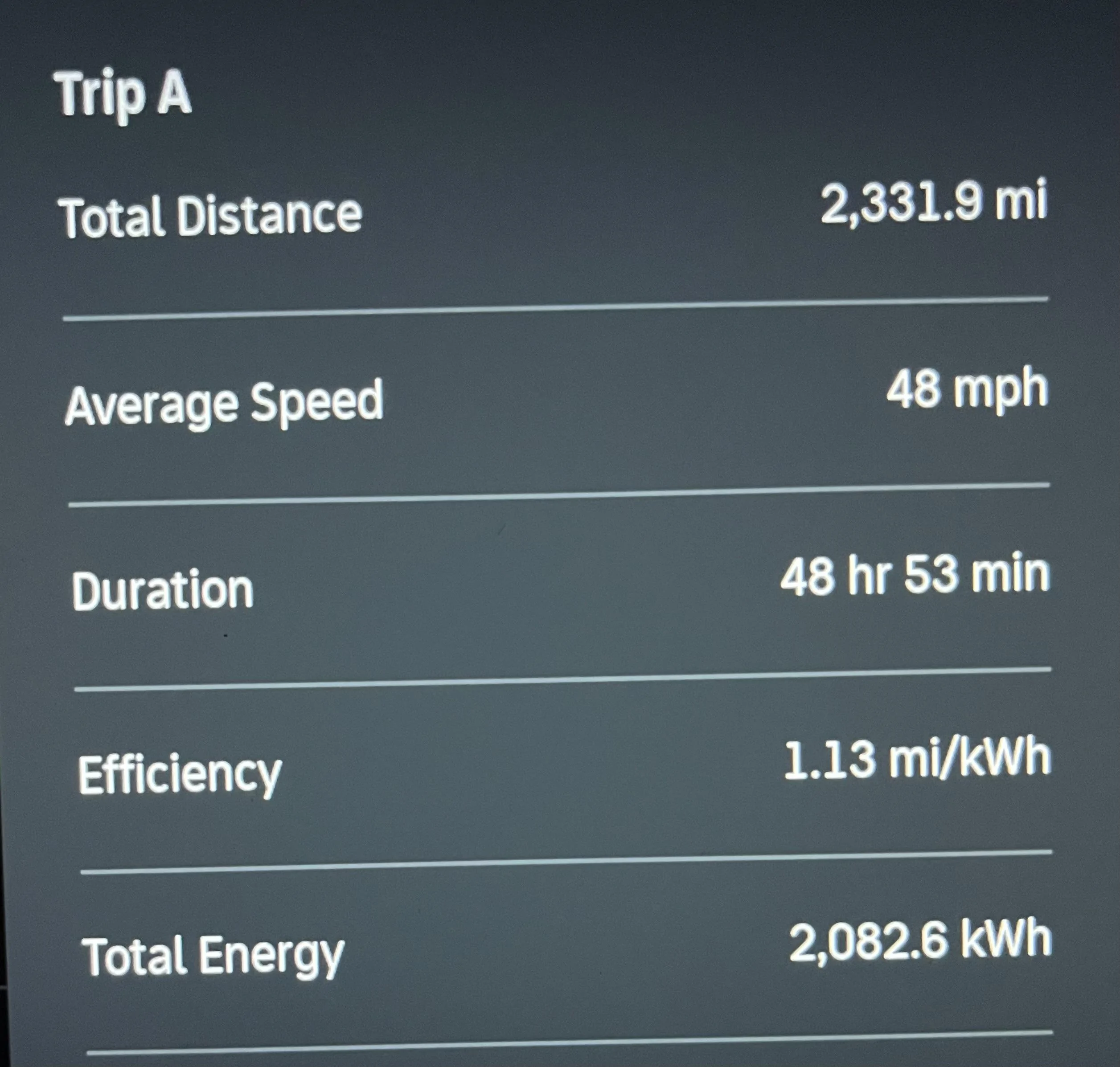

I'm waiting for my R1T to charge in Truckee. This morning, in Truckee, towing a roughly 5500#, 21' trailer I rented, I charged to 100%. I then drove 68.6 miles to a destination in Auburn about 2 miles from I80. Messed around for about an hour or so in camp mode before heading back toward the same rivian charger. 8 miles from the charger, I dropped the trailer at a pizza joint in hopes of making it to the changing station. W/o trailer, now, approximately 3/4 of a mile before the 7227' summit sign the % gauge went to 0. Moments later, the range gauge went to 0. I had been drafting a semi for a couple of miles at around 38-42mph but as we crested the summit he sped off. I I was unwilling to keep up. Another semi merged onto the highway causing me to slow some but the 6% for 5 miles sign gave me hope. Cruise set at 48, I watched nervously as the range came up to 1, then the percent followed. I pulled up to the charger still with 1 and 1.
This is not the first time I've ditched a trailer to make it to a refill. Supercharged Quadra-steer suburban the first time.

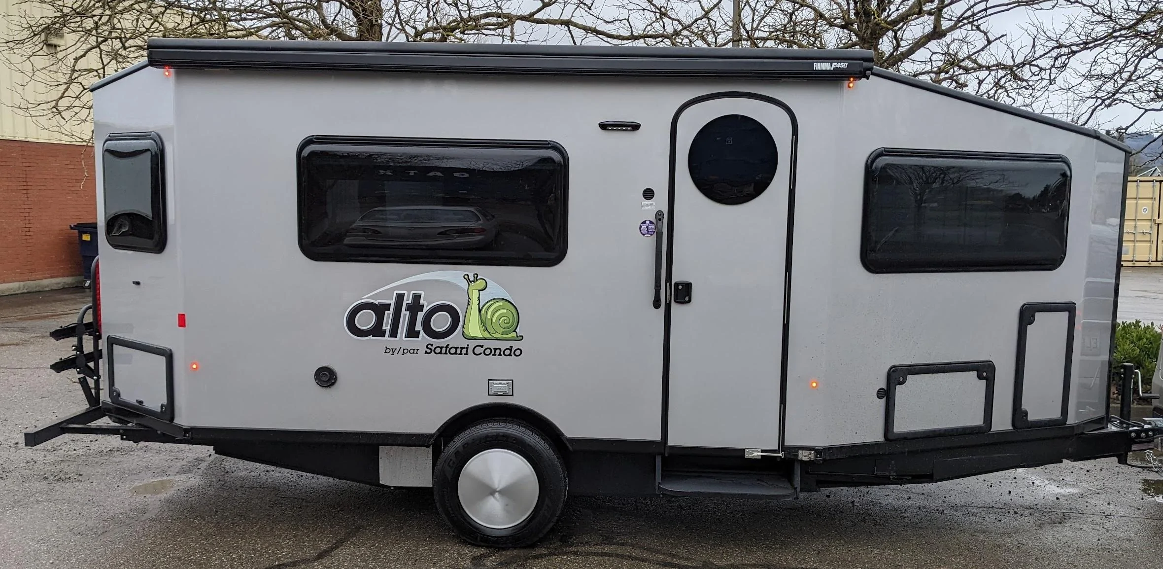

My wife just towed her trailer behind our R1S for the first time. It wasn't a long trip, but she got 1.55mi/kWh.
Rivian R1T R1S Towing + Efficiency: Please post your experience! PXL_20211210_202938953
The trailer is a 21' Safari Condo Alto A2124, which is about 3,000lbs empty (it was very much not empty on this trip!). It has a somewhat aero-friendly design - it's likely near the best of "full-size" trailers for aero; though of course something collapsible or half-height would be better.
The route didn't involve much elevation.
Temperatures were in the lower 60's; with a tiny bit of rain.
Speed limits vary from 35-60 along the route, which was just over 56 miles (plus a ferry ride).
Our R1S has 20" wheels with Michelin Defender all-seasons, and Team1EV's aero caps.
1.55mi/kWh is great; that's a theoretical range pushing 200 miles while towing (though of course we'll never try that; I always leave a large buffer if for nothing else than to allow for unexpected headwinds).
We got even better efficiency towing the same trailer with our 2017 Tesla Model X 100D. We've seen anywhere from 1.67 to 1.91 with that (though the routes were different, and of course conditions varied). For reference, the X is rated at about 3.0, and our lifetime average before towing was about 2.7. Towing the A2124 on average was about a 40% hit with the X.
But the Rivian's pack is 1/3 larger, and it's several years newer so no degradation yet. It's less efficient to start with, but that means the percentage hit from a trailer should be smaller (indeed with this trip it was likely around a 30% hit), so the effective towing range - the key metric! - is longer. And the Rivian is easier to hook up and has an integrated brake controller.
Now if only I had a working 12V outlet so I could use the screen for the trailer's rear-view camera...

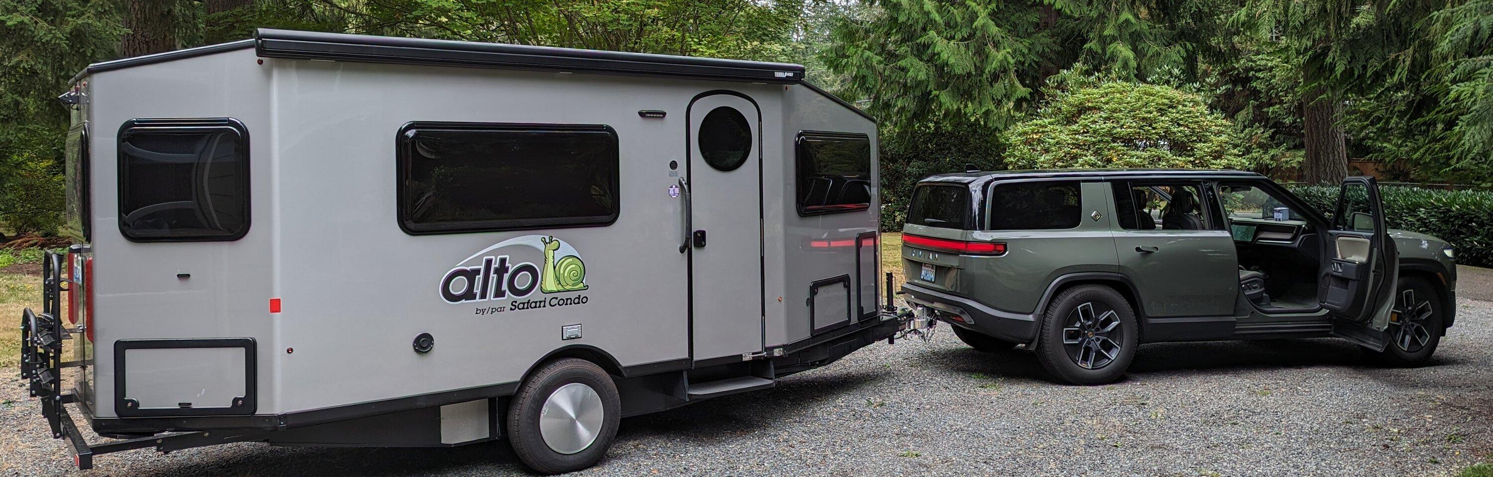

The trailer is a 21' Safari Condo Alto A2124, which is about 3,000lbs empty.

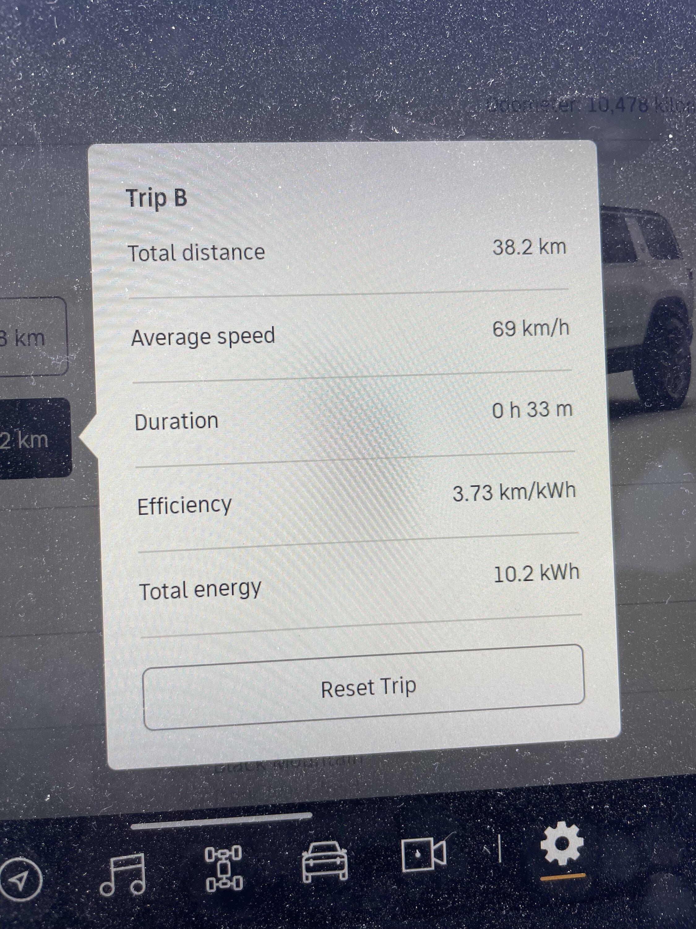

Towing a dump 4000lb (empty) dump trailer with a net loss of 1300' I netted 2.32m/kw they same route going up with max load was 1m/kw.
The average was 1.66m/kw.
