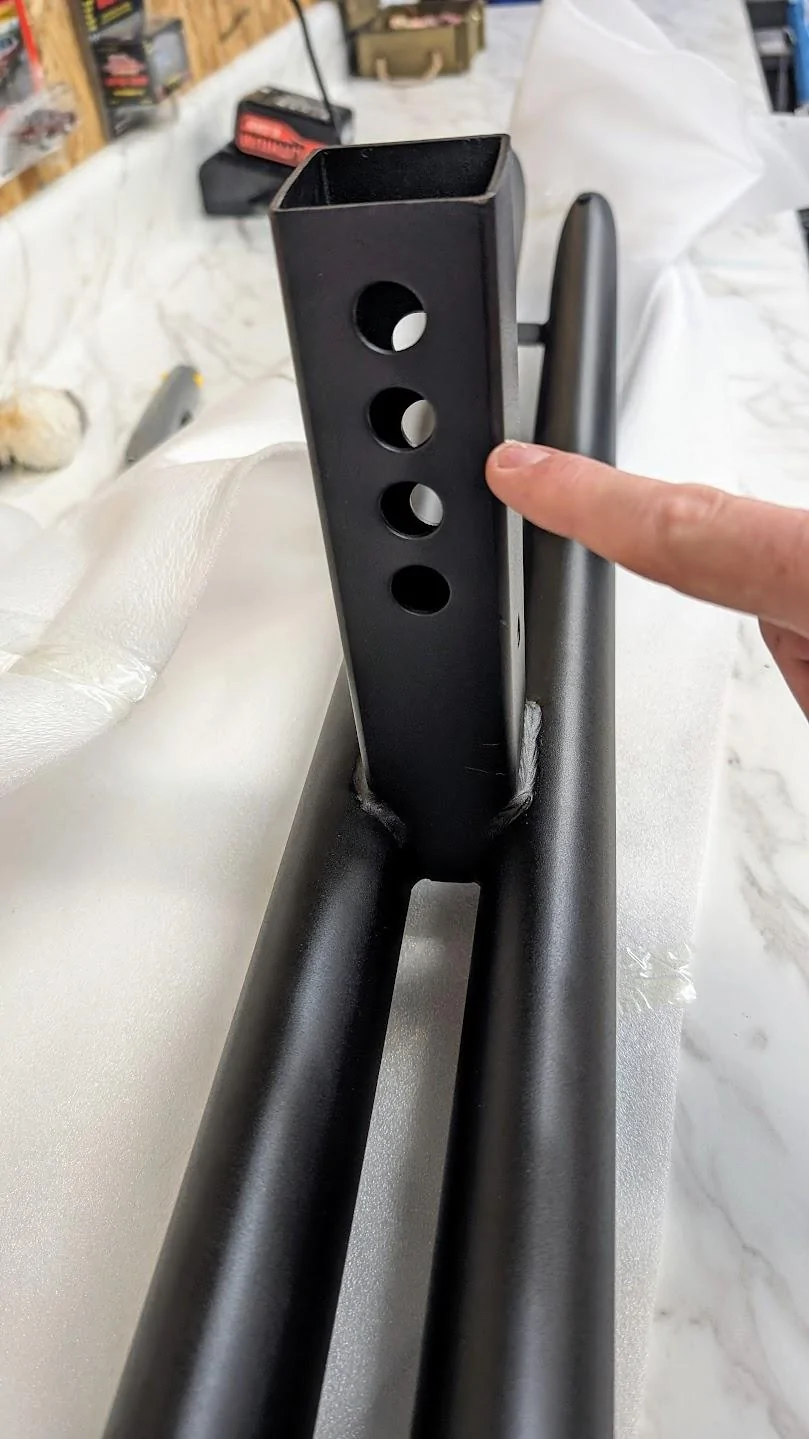

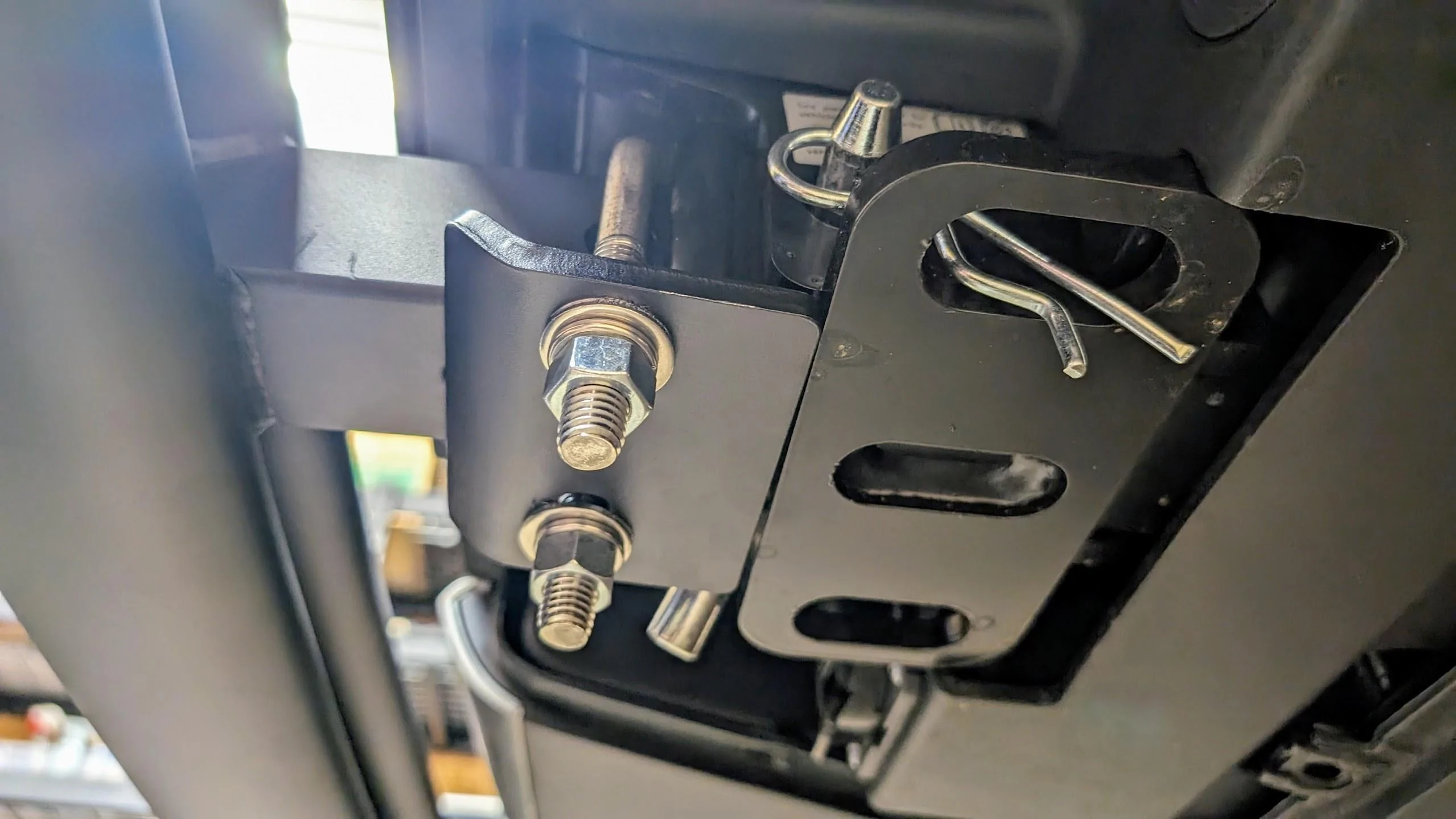

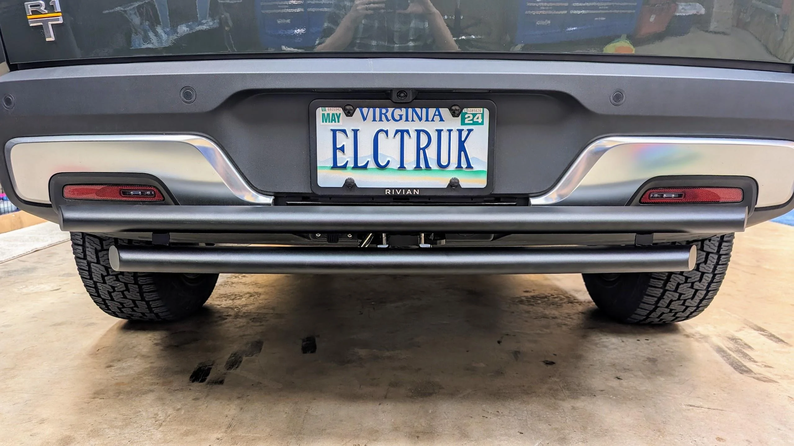

Have been looking at products to "up armor" the rear of my truck. Was dissatisfied with the fit of the "Go Rhino" bar. Trying the "VANGUARD VGPDB-1919BK Black Powdercoat Classic Double Layer Hitch Step" now. The included anti-rattle clip did not fit (same problem I had with the other bar), but used a U-bracket to prevent it from rattling. I'm torn on it. It seems better than the other product, but still not in love with it. Will probably keep until I have time to try something else.
Link to product and photos below.
Hitch step: https://www.amazon.com/dp/B07DG2N6Z2
U-shape anti-rattle bracket: https://www.amazon.com/dp/B01KZ25Y26
Rivian R1T R1S VANGUARD VGPDB-1919BK Black Powdercoat Classic Double Layer Hitch Step installed 1700861034415
Rivian R1T R1S VANGUARD VGPDB-1919BK Black Powdercoat Classic Double Layer Hitch Step installed 1700861047037

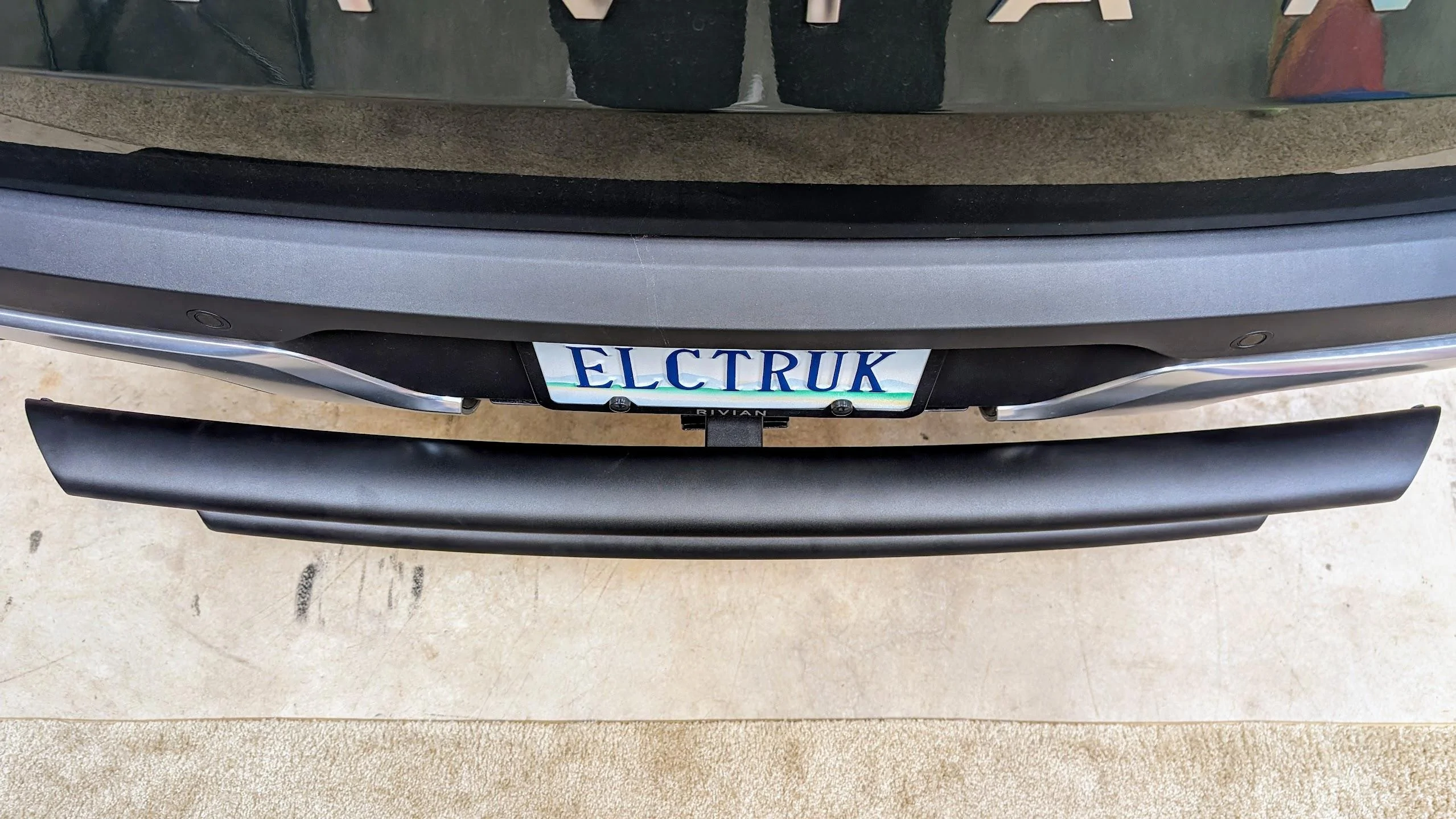

Wish these were about an inch longer:
Rivian R1T R1S VANGUARD VGPDB-1919BK Black Powdercoat Classic Double Layer Hitch Step installed 1700861067222
Rivian R1T R1S VANGUARD VGPDB-1919BK Black Powdercoat Classic Double Layer Hitch Step installed 1700861087817
Rivian R1T R1S VANGUARD VGPDB-1919BK Black Powdercoat Classic Double Layer Hitch Step installed 1700861100038

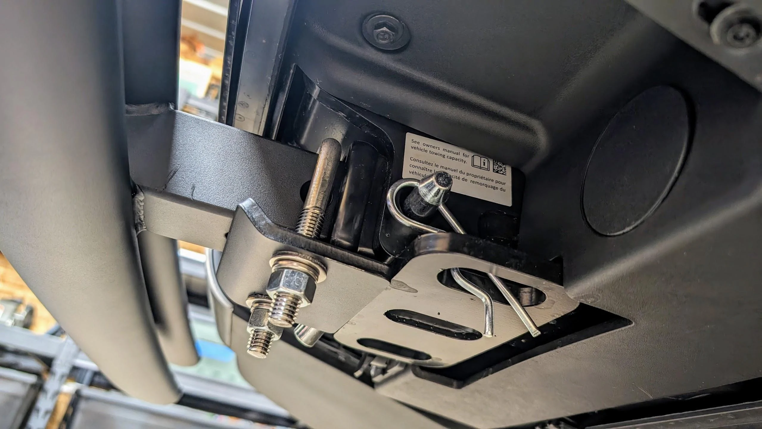

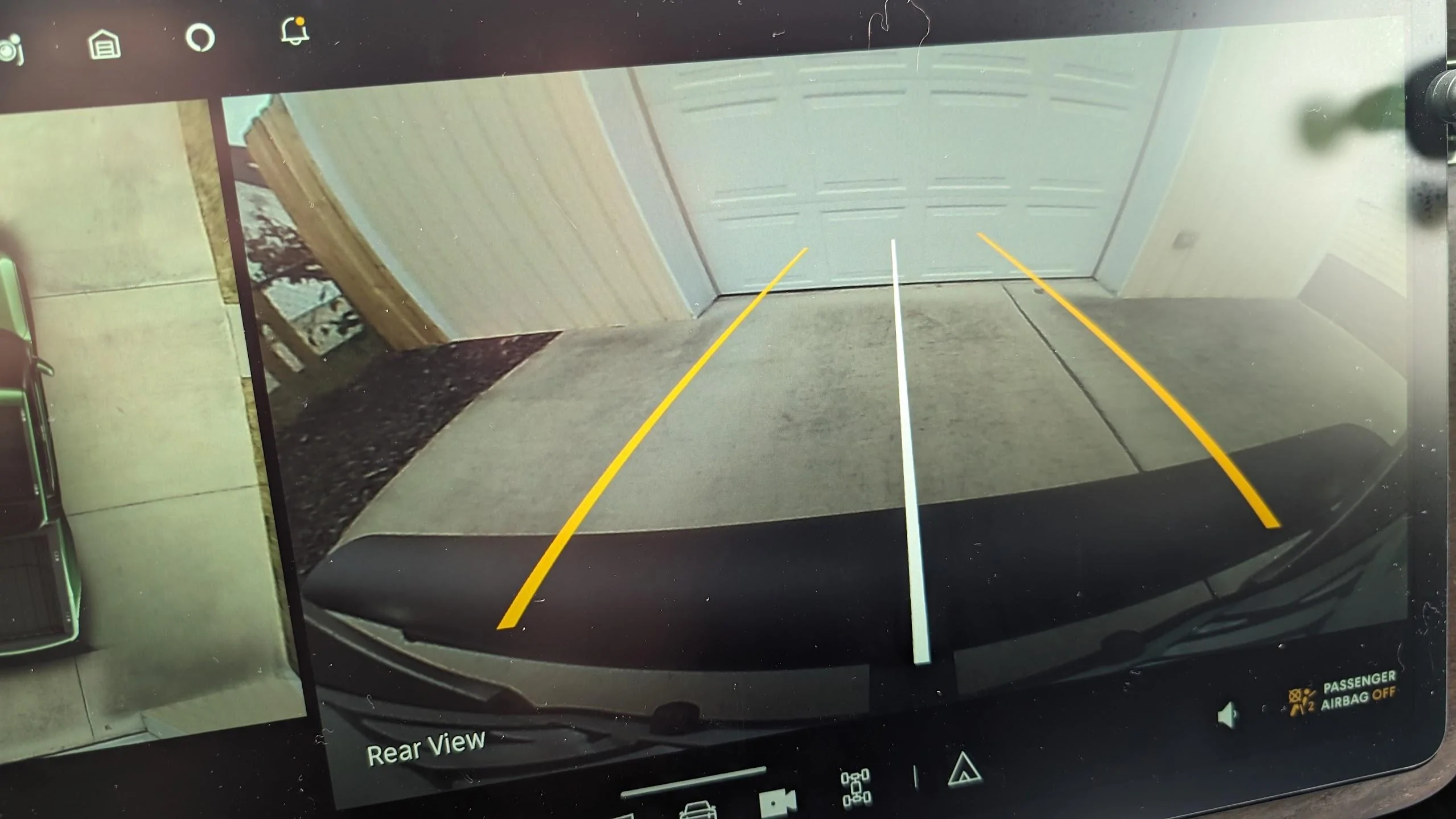

View from camera:
Rivian R1T R1S VANGUARD VGPDB-1919BK Black Powdercoat Classic Double Layer Hitch Step installed 1700861208135
Thoughts or suggestions?

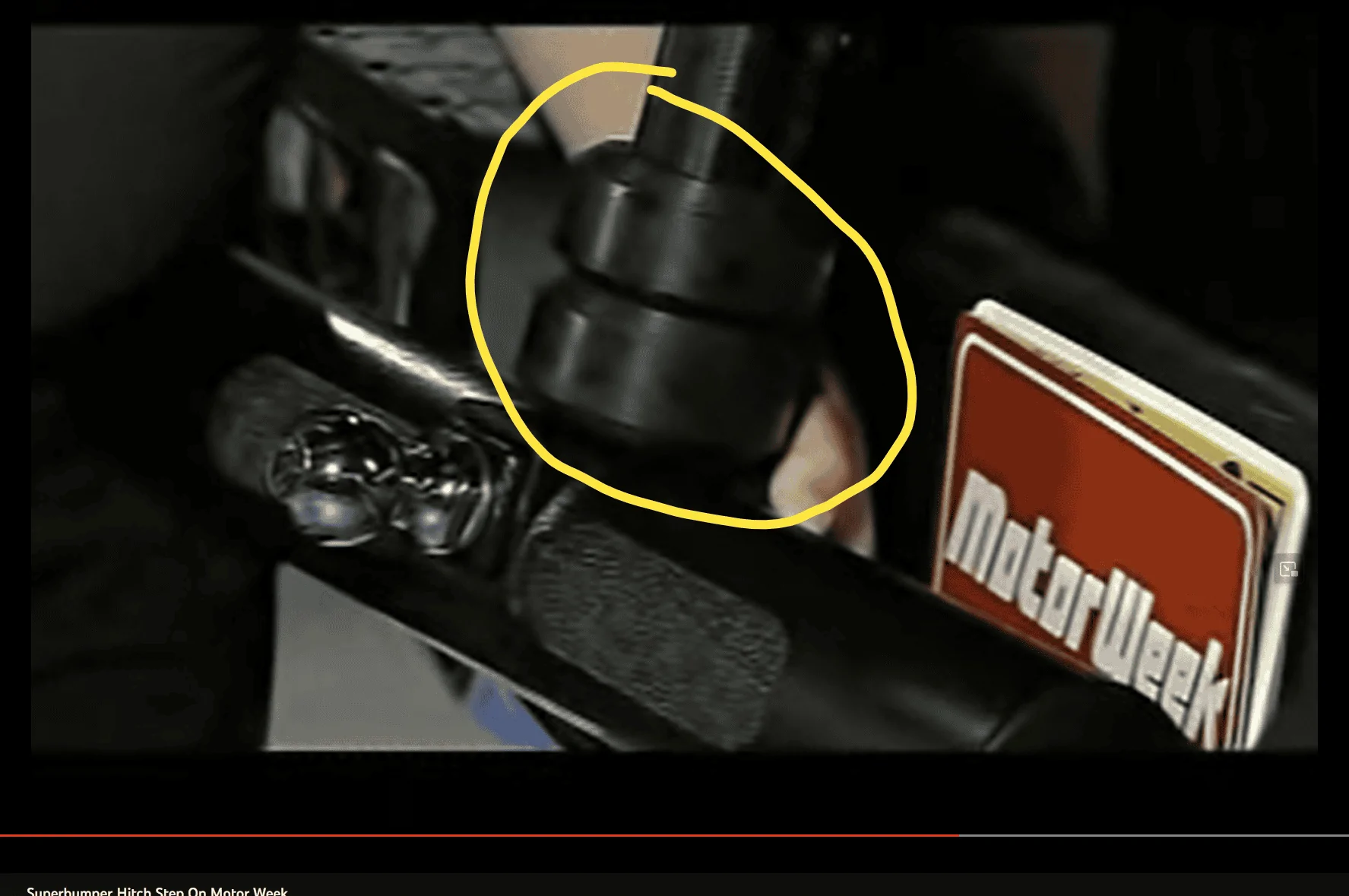

4- It's really easy to use Google, friends. This was one of the top results from "accidents with a hitch" https://kfblaw.com/trailer-hitch/
Being condescending is not really going to win you any fans. Also, they're ambulance chasers. I would pretty much discredit anything from a law firm. Again, just my opinion. ?
TL;DR. This one includes "energy absorbers". That's what I really want. Need to look into this product more:

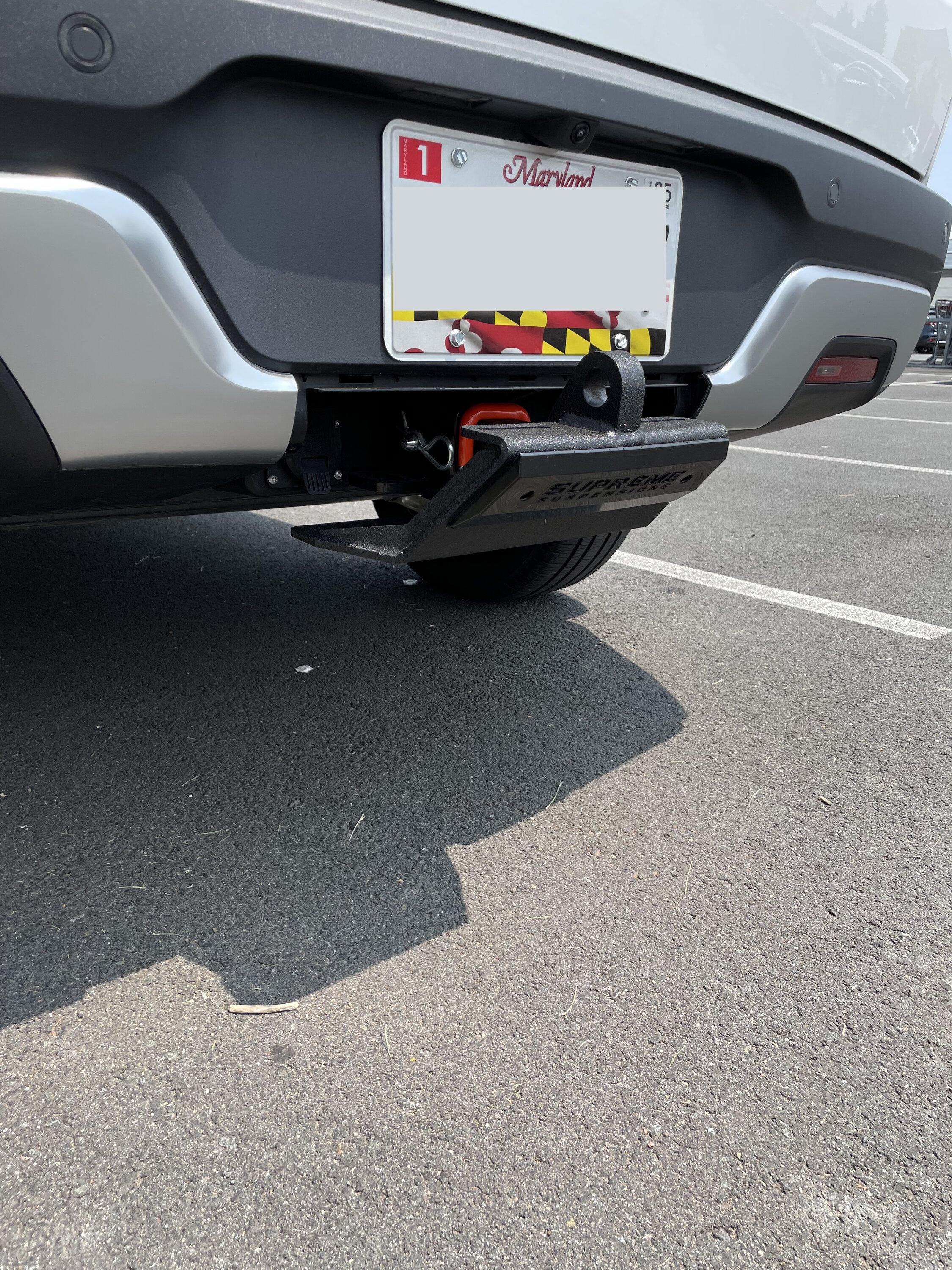

Some internet know - it - alls must exert their opinion upon you rather than just moving on.
This is the one I put on mine in hopes of deflecting lower front end cars under the truck for small taps. Think civic or corvette.
Another upside is I have an attachment point ready to pull me out or to pull others out of a stuck position
I like that your's provides a wider impact area where as mine will probably punch right through a grill/radiator and then still get bumper to bumper collision.
