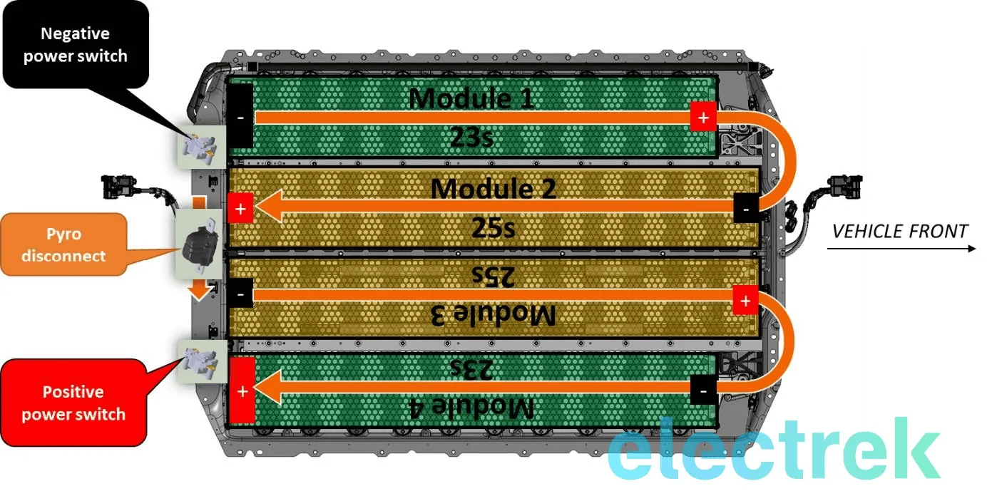

One possibility is they stuck with the very large modules and reduced the number of cells in them. In this scenario they would them operate at a lower voltage (96s vs the original 108s as an example).
The original 15 kWh "blocks" are awkward to fit into a vehicle due to their physical size and standardized (presumably) shape. A block of 864 cylindrical 21700 cells is going to less flexible when installing into a vehicle than 4 blocks of 216 cells. It makes more sense to me to work with smaller "modules".
Another possibility is they ditched the standardized large block/module idea completely and are separately engineering/designing the different pack sizes (this could explain the 400 mile variant delay).
Here is the SR Model 3 pack as an example:
Rivian R1T R1S VERY DISAPPOINTED!!! No 400+ battery until Jan. 2022?!?!?! 1605720330520
Tesla uses "bricks" to make up "modules" which make up the pack. The "bricks" that make up this each pack contain 31 cells. The modules are not all the same physical shape and the number of bricks and cells vary. Two of the modules contain 23 bricks (each with 31 cells), the other two 25.T his example shows that Tesla connects the modules in series and the battery then becomes 96s (23+25+25+23).

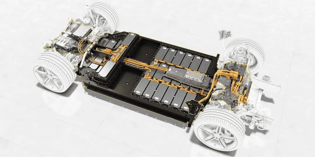

They Porsche Taycan uses pouch cells, but you can look at each pouch as equivalent to a "brick".
Rivian R1T R1S VERY DISAPPOINTED!!! No 400+ battery until Jan. 2022?!?!?! 1605721967929
There are 33 modules, each with 12 pouch cells (bricks) for a total of 396 cells. These are electrically connected as 2p 198s. Notice the the 33 modules is an odd number. The modules are not treated as a separate battery with a single =/- connection, but half of the pouches in each module are connected in series (6 x 33 = 198). 198 x the nominal 3.65V of the LG pouch cell gets you the nominal 723V of the Taycan with a max voltage of 832 (198 x 4.2V).
Both of these examples show that you can electrically connect batteries differently than their physical "modules" might indicate, and that in fact not all modules need to be identical. It is not necessary to treat each of them as a standalone battery like putting AAs into a device where the only choices are in series or parallel.

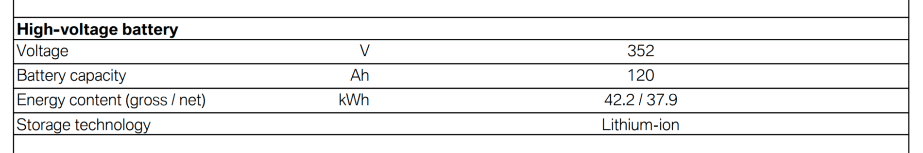

This gets us into the perennial discussions as to what the capacity number represents. Is it the charge capacity or the discarge capacity? Is it from max safe to min safe or 80% or 78.65% of (max_safe - min_safe), at what charge/discharge rate? What is important to us is that the car deliver nominally the rated miles. Rivian has said that the 300 mile pack performed "better than expected" in the recent rally,
The capacity (energy) rating is likely what you refer to as "discharge capacity" and is the amount of energy the cell/battery can provide.
In the case of the LG 21700 its energy rating is derived from discharging from 4.2V at a constant current of 0.2C to 2.50V at 25 ºC ± 2 ºC
There is no standard for what an EV manufacturer has to report in relation to the pack kWh. Ideally, all would be like BMW and give you the rated capacity and the useable capacity:
