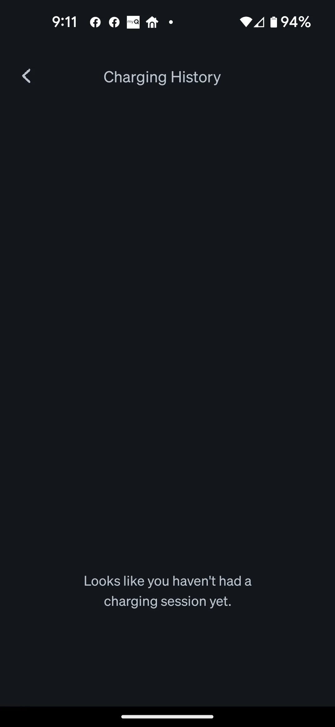

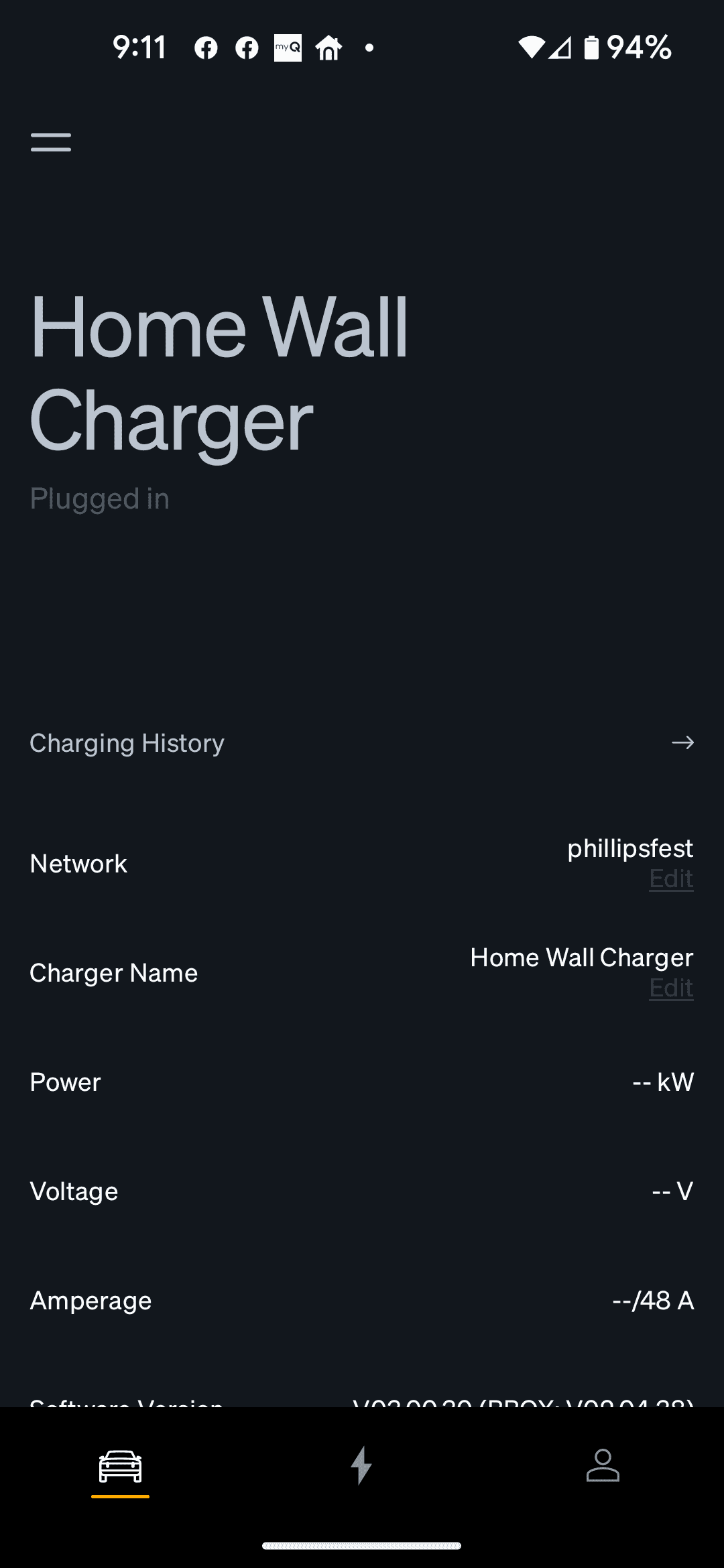

I installed my Rivian Wall Charger last week when I took delivery of my R1T. It is connected to bluetooth and wifi, and the onboard charger is noting that it charges the vehicle appropriately, however when I look at my app it records no charging sessions despite the fact that there have been 3. Any suggestions?
Rivian R1T R1S Wall Charger connected and working but not populating session history on app 2022-09-05 09.11.18
Rivian R1T R1S Wall Charger connected and working but not populating session history on app 2022-09-05 09.11.49

I have the same issue. I’m hoping that after I receive the new update to the truck, it will begin populating the data. The good thing is that the truck is charging and everything is connected and working as expected - just no history. Mine shows up just like yours.

I contacted support about this yesterday. It seems there is some issue starting 9/1 and there is an upcoming app update to fix it. I had history up until 9/1, then it stopped.

Just got off the phone with service. I reset my truck (left control plus hazard button for 15 seconds) and force stopped my app and when everything restarted it worked.
