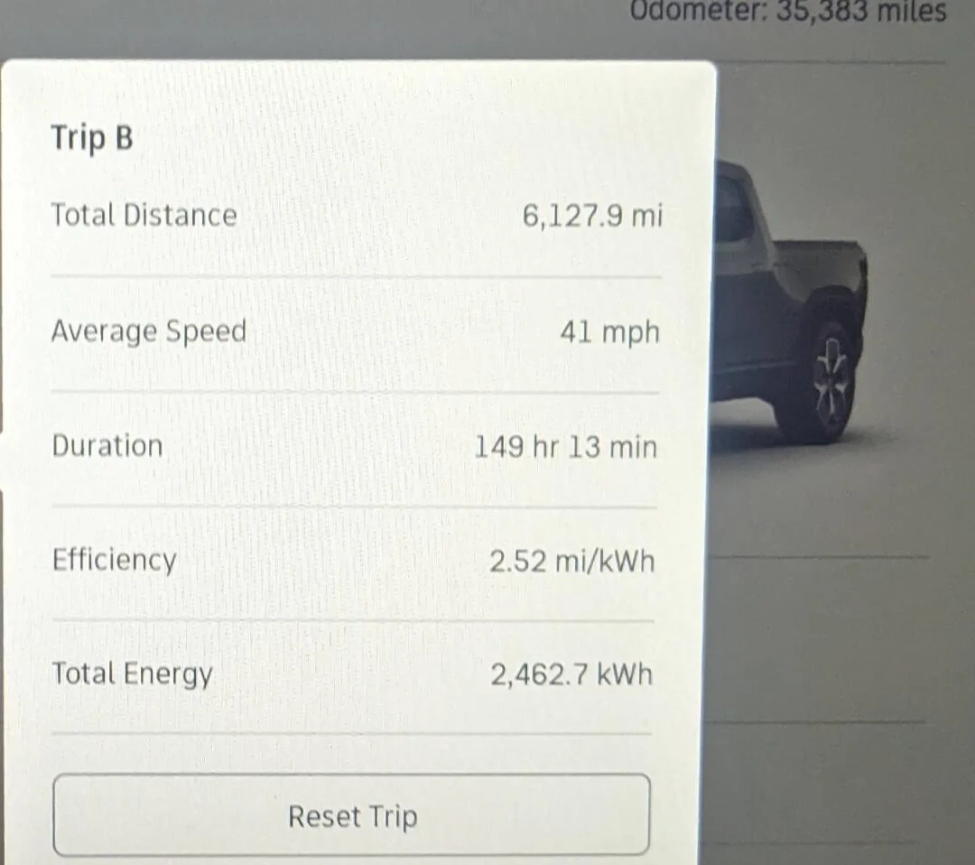

275/60R20 AS+3s, 2.47MPK in 2023. 6k miles are a mix of road trips, cabin trips, and 80/20 freeway/local commute.

I plan to switch to a 116 option when these run out, I'm split between HTS60s and LTX MS2s. Both in 275/60R20 of course.
