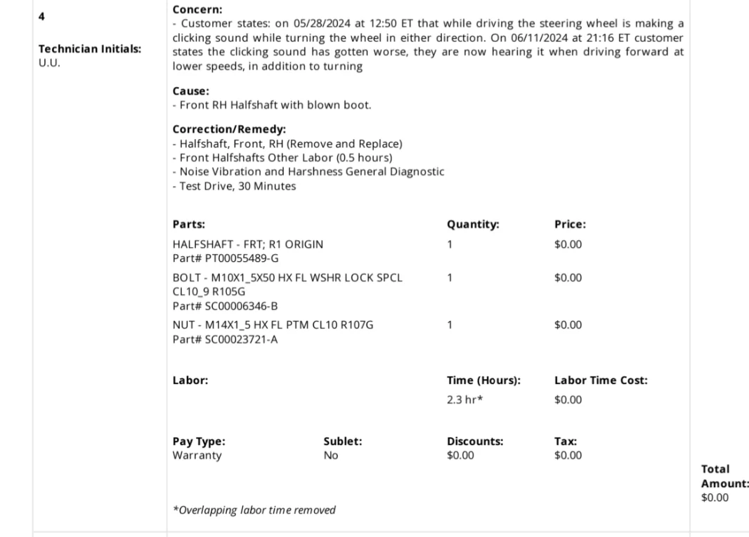

Had the same issue almost 1 year back and was fixed under warranty. While it was not a major issue which should require immediate attention, will be better to get this serviced soon specially when it's under warranty.
Just to follow up you were right. At first the just suspected the Ting Washer but they ended up replacing the half shaft, output seal and hubs. They also found that the front drive unit was leaking. Sorry I don’t have a prize for you 😉
