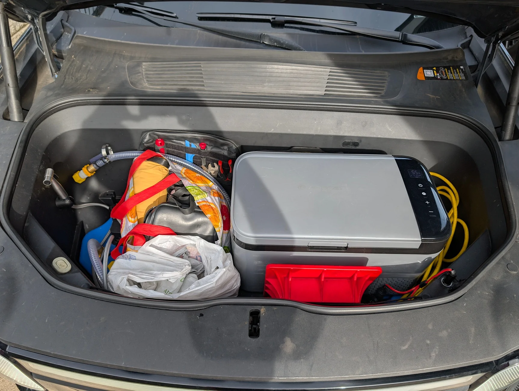

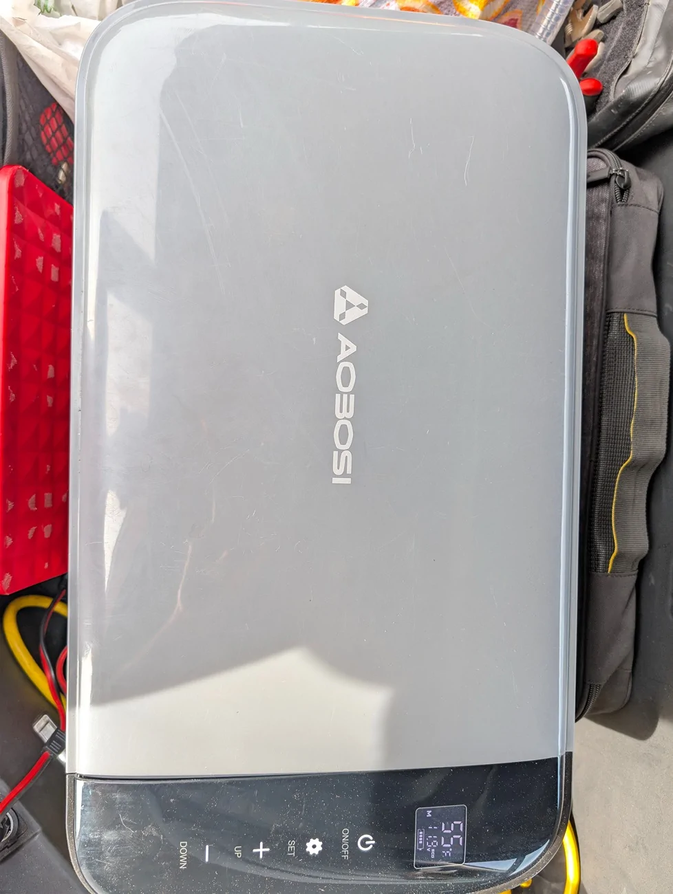

I've been running the pictured cooler continuously for two+ years in the frunk. It's plugged into the 12v 24/7. Power turns on automatically when truck is driven/unlocked. On longer trips, it'll run three days continuously with the outlets-stay-on setting.
The 2023 truck has 51,000 miles; original 12v batteries; never an issue.
It's a great setup. I always have an assortment of drinks in the cooler.
