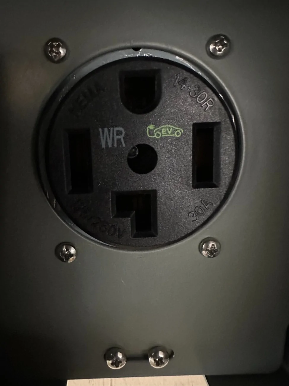

I have seen some discussion that Leviton revised their 14-50 plug in 2024 and made it more heavy duty, or at least made a different kind for EV charging. Looking at home depot this has replaced the type you can see in the picture I posted.
It also costs $50 vs the $15-20 for the typical big box special. I think conventional wisdom holds true, the cheap ones are cheap for a reason. That said if you want the exact same thing to compare without the Hubbell brand premium, look for the Bryant one. It's a Hubbell-owned brand but it's cheaper and seems to be exactly identical.
The one I have is made for EV charging, which I think is what you are referring to, but it was available prior to 2024. Home Depot still sells the cheap ones that should not be used for EV charging.

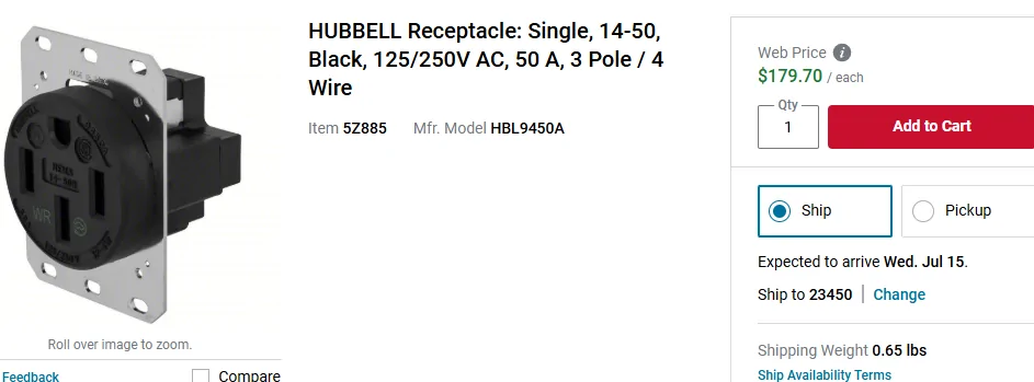

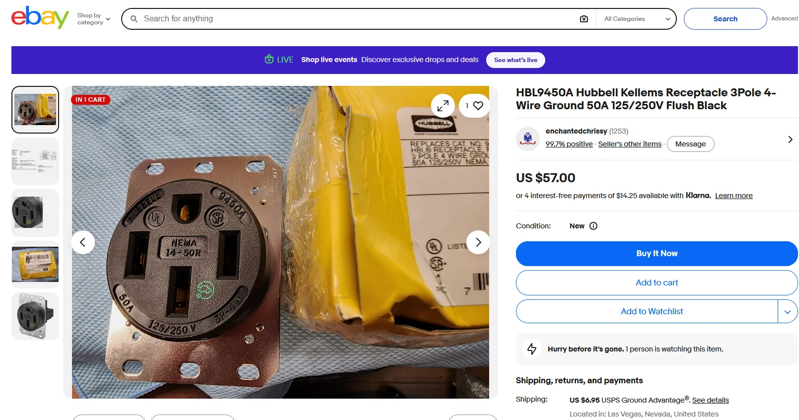

Your advice is good, as definitely industrial outlets like the one made by Hubbell are more robust than the cheap 14-50 outlets sold at Home Depot. But discounting problems due to installation is a mistake. And discounting the risk of connections that loosen over time is also a mistake. A Hubbell with loose wires can overheat and melt, just like a cheap one can.

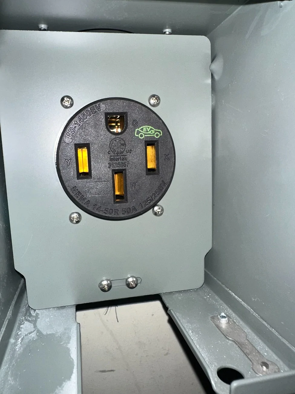

I purchased a Leviton 14-50 EV outlet from Home Depot to replace the cheap Home Depot one I installed before I knew better. It is built almost identically like the more expensive Hubbell outlet and it is very robust. It is not "junk", IMO. What evidence do you have that makes you think it is junk?
Here are a few pictures of the outlet I have yet to install. (I am not using the 14-50 outlet so I have not prioritized installing it over other house projects.)
You can plainly see it has very robust connections for the wires, and it is just as substantial at the Hubbell outlet. If you have some evidence it isn't, maybe you can share what you know. I can trash it and get a Hubbell if you are convincing, but evidence instead of opinion is what is needed.
The Hubbell is made out of polyester which has better overall thermal performance compared nylon. Depending on formulation (which explans variations in the data below) nylon can start to melt at 210 C, Polyester is 250 C. Since these devices are subject to repeated thermal cycling in an uncontrolled environment, and our #1 concern is overheating failures, it's a factor.
From the manufacturers specs:
Leviton Operating Temperature: -40°C to 60°C
Hubbell Operating Temperature: 75°C, minimum -40°C (w/o impact)
Leviton Contact Material: Copper
Hubbell Contact Material: Brass
If ambient temperature is 38 C (100 F) on a hot day, we start there and add heat from charging. That 15 C difference could matter after 6 hours of additional heat from charging.
Brass is more durable than copper and does not oxidize as readily as copper. When thinking about a plug contact, IMO durability and no oxidation (resistance which creates heat) is preferable.
I have held both the Leviton EV and the Hubbell 9450 in my hand and inspected them. Unless Leviton has changed the design recently, the brass mating connectors used inside the front of the Hubbell receptacle are visually much more robust compared to the Leviton. Leviton is made in China for the mass market at Lowe's, Home Cheapo, etc. Hubbell is made in the US for the industrial market. I've done controls and automation engineering projects in dozens of customer factories in my career. I've seen Leviton devices fail electrically in homes. I've never seen a Hubbell device fail electrically in a factory (where continuous duty is common), but I've seen burnt wiring connected to Hubbell devices.
Is my standard of expectation and performance high for electrical components? Yes, so to me lots of stuff is junk.
Will the Leviton work? Yes.
Will most people never have an issue with the Leviton? Probably.
Do I think saving $25 is worth the potential risk? No. Food for two people at Chik-fil-A costs more than $25.
