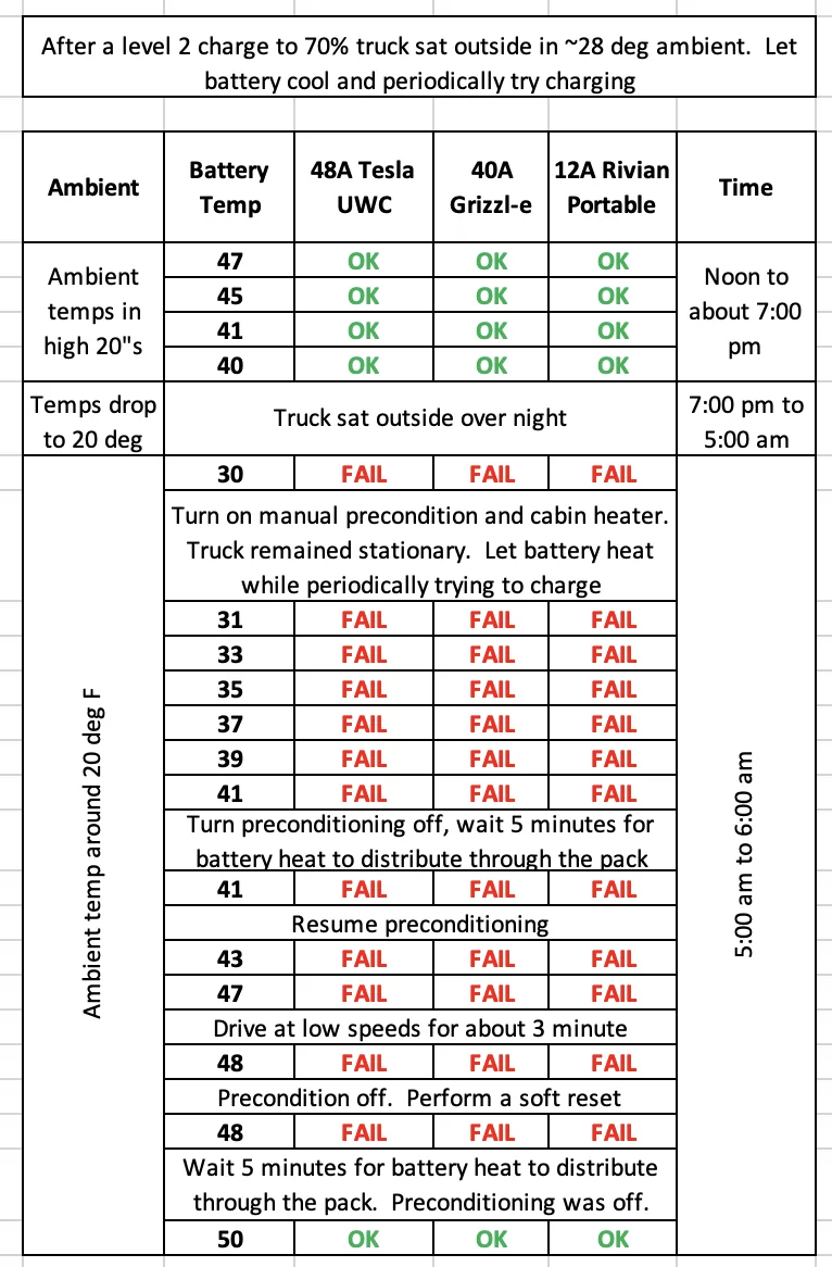

I've been experiencing Level 2 charging issues as well in cold weather. Yesterday and overnight I ran an experiment to try and determine if there is a certain battery temperature that is needed to allow level 2 charging.
I used three different level 2 chargers to rule out charger hardware issues. I gradually let the battery cool from the initial 48 deg battery temp with the SOC at 70% and periodically tried level 2 charging as I recorded battery temps. All was good down to about 40 deg battery. By then it was bed time so the truck sat outside overnight. In the morning the battery was 30 deg and would not charge. I used preconditioning to warm the battery gradually while periodically trying to charge. Went all the way back to 48 deg with no luck charging. Did a soft reset, still not luck. Let sit 5 more minutes without preconditioning, battery want to 50 deg then I was able to charge.
So, just doing a soft reset did not fix it, it took sitting time/temperature increasing to enable charging.
Maybe Jose @Kryptonlogic can elevate this to his engineering contacts within Rivian. I will also open a ticket and provide this info to Rivian that way.
I have a 15 month old R1T Gen 2 Dual Motor with MaxPack battery.
Rivian R1T R1S Question: L2 and  battery preconditioning. Screenshot 2025-12-06 at 9.05.27 AM
Ultimately I was able to do a level 2 charge but the exact procedure to do so is it a bit of a mystery. I consumed 6% of the battery while doing this testing.
Urg: https://www.rivianforums.com/forum/...n-to-2-7kwh-at-24f-should-i-be-worried.37845/
@RivianRoamer was a massive help on this last year, and able to get Wassym to look into it. It seems the battery thermal system in gen2 is just not what it was in gen1. You can ignore my capacity theory in that thread - luckily it turned out to be a red herring, and Rivian provided the same overhead between gross capacity and addressable capacity in both generations.
Edit: on a personal note - this will impact me less than last year, as now we have a garage where we charge… so though it’s in the low 30’s it’s not hitting 20 and bellow this time around.
Thank you for this testing.
I just had to do this to get my gen2 to start charging. Battery was at an indicated 29 degrees with the snowflake. Warmed it up to 60 degrees/50kw fast charge. Tried to plug in, still got the error.
Let the truck go to sleep (less than 5 minutes, it has serious narcolepsy...), after that, I'm charging. Seeing as I'm a hour and a half from a fast charger at the moment this is a good thing...
