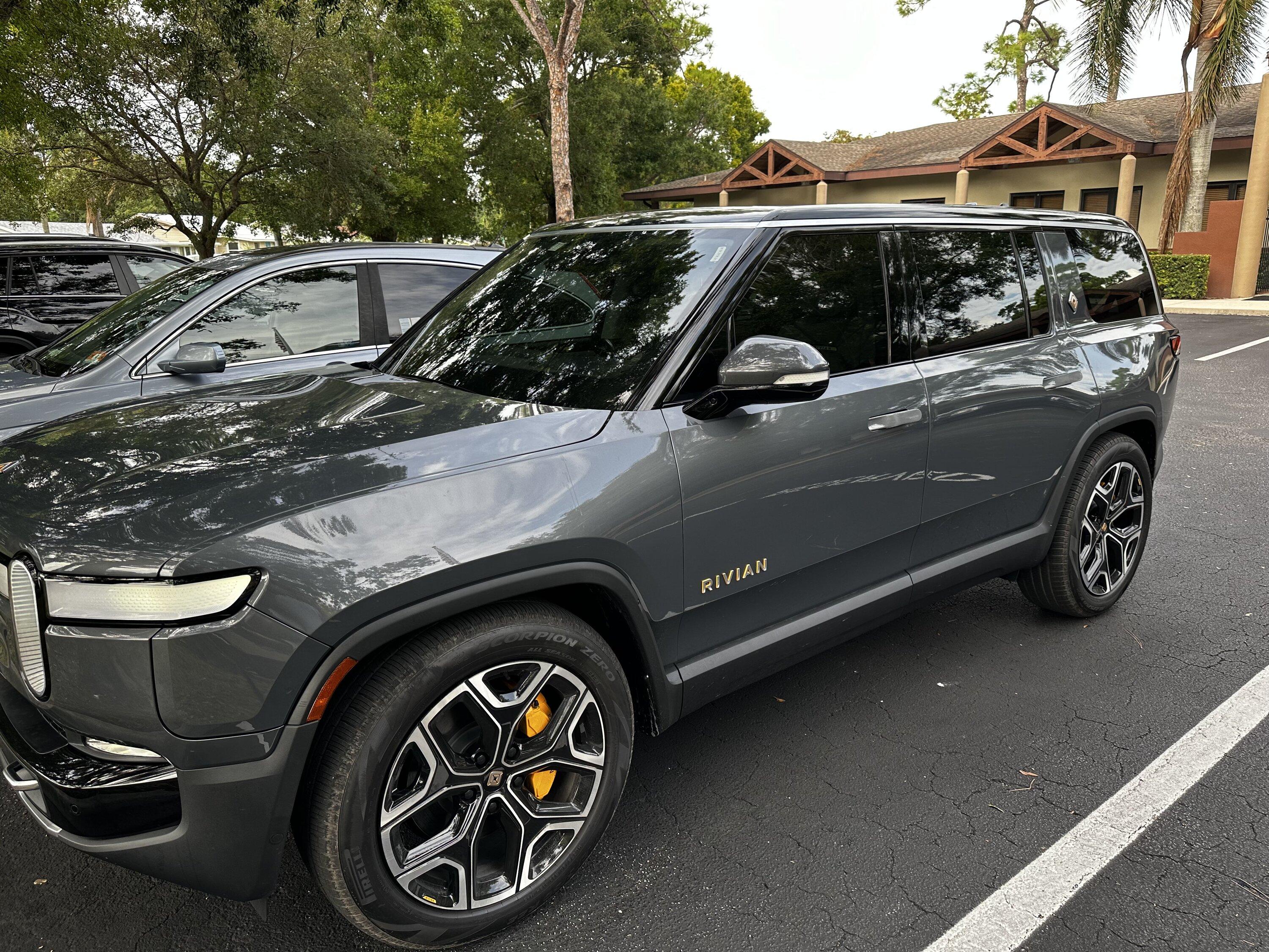

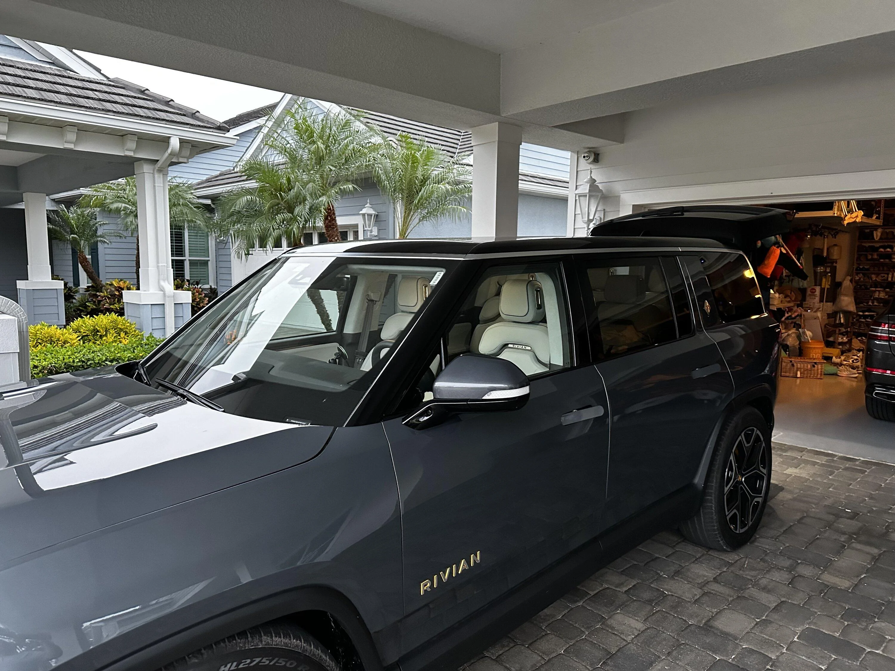

I can just comment on the fact I have done standard high quality dyed tint on my previous cars. Reality is it did not block any heat.
I decided to go with ceramic (86% UV block) on the R1S as I felt like I was being booked alive down here in Florida. Long story short it has made a dramatic difference. I also have noticed about a 10% increase in miles per kWh as I don't think the AC is having to work nearly as hard.
In terms of shade, I had the fronts match the rears (25%). Rears + rear windscreen in clear ceramic and I also did the front windscreen in a lighter tint that did not scream pull me over šŸ˜‚. Tint on the fronts is legal. Front is not supposed to have tint in Florida so could have gone clear ceramic, but as long as it is not completely blacked out cops down here don't care.
I did 86% as the shop owner was super honest and explained he had 99% on his car but prior he had 86%. Yes it makes a difference but not massively over the 86%. He basically said if you park every day directly in the sun like he does 99% is great. If you park in a garage/ car port/have shade do the 86%. Tint came with a 12 yr warranty. Total cost was $610.
Final thing is there is another benefit to ceramic. It reduces you UV exposure which reduces your risk of skins cancers and melanomas which for the extra 50% cost over standard dyed film is worth IMHO.
Before and after pics attached.
