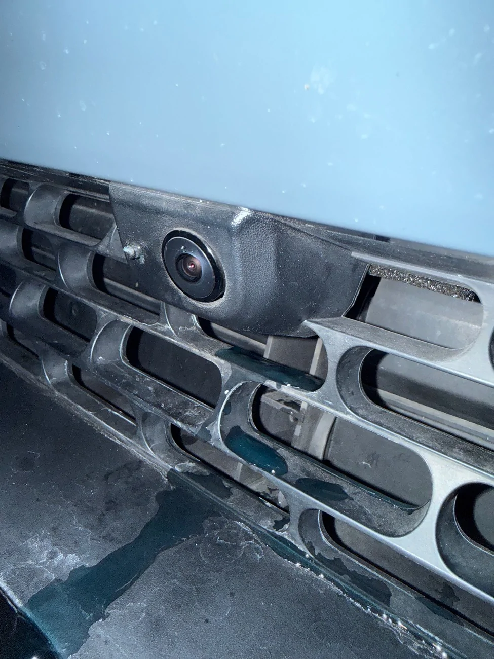

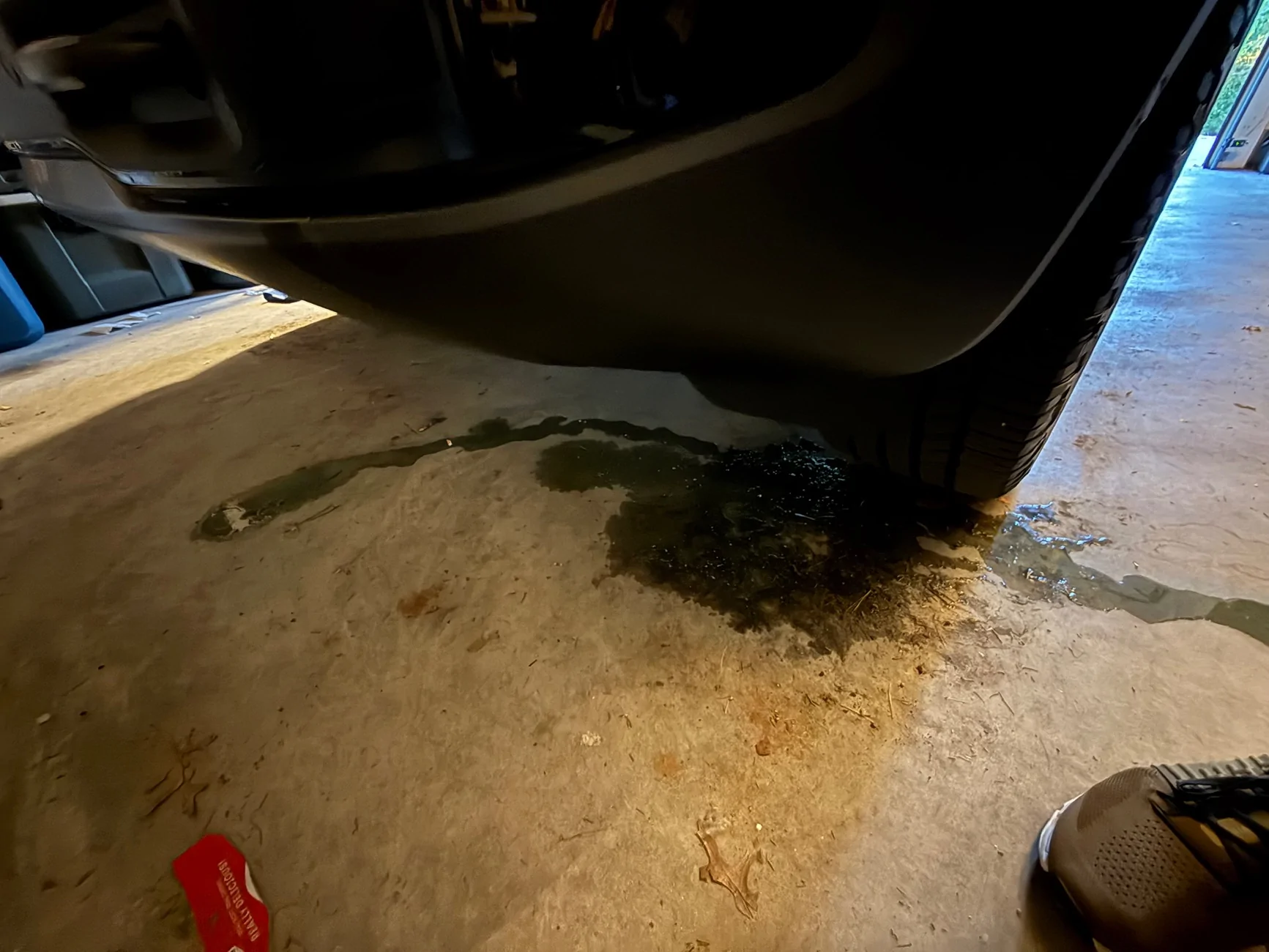

I recently noticed that all of my windshield washer fluid is draining out of the housing for the front camera that is inside of the grill of the car. I got a notification that fluid was low so I filled it up. Went back in the garage. About an hour later and noticed a large puddle underneath the car. Traced the leak back to the front camera housing. I believe that the washer fluid sprays on this camera whenever you spray the front windshield. But something is allowing it to leak out at a fast trip. I lost all of the fluid within less than a day.
Has anyone else had this issue? If so, is there an easy fix? It’s going to be annoying waiting two weeks to take it to my local service center to get repaired. (Soonest appointment)
Rivian R1T R1S Windshield washer fluid leaking from front camera- easy fix? IMG_6860
Rivian R1T R1S Windshield washer fluid leaking from front camera- easy fix? IMG_6858

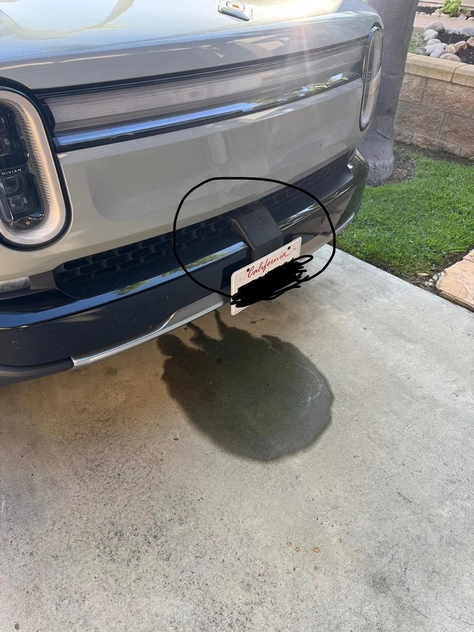

I just picked up my R1S from service yesterday for this issue. I was told they replaced the grill and sprayer. It was a quick fix.
Rivian R1T R1S Windshield washer fluid leaking from front camera- easy fix? IMG_6917
