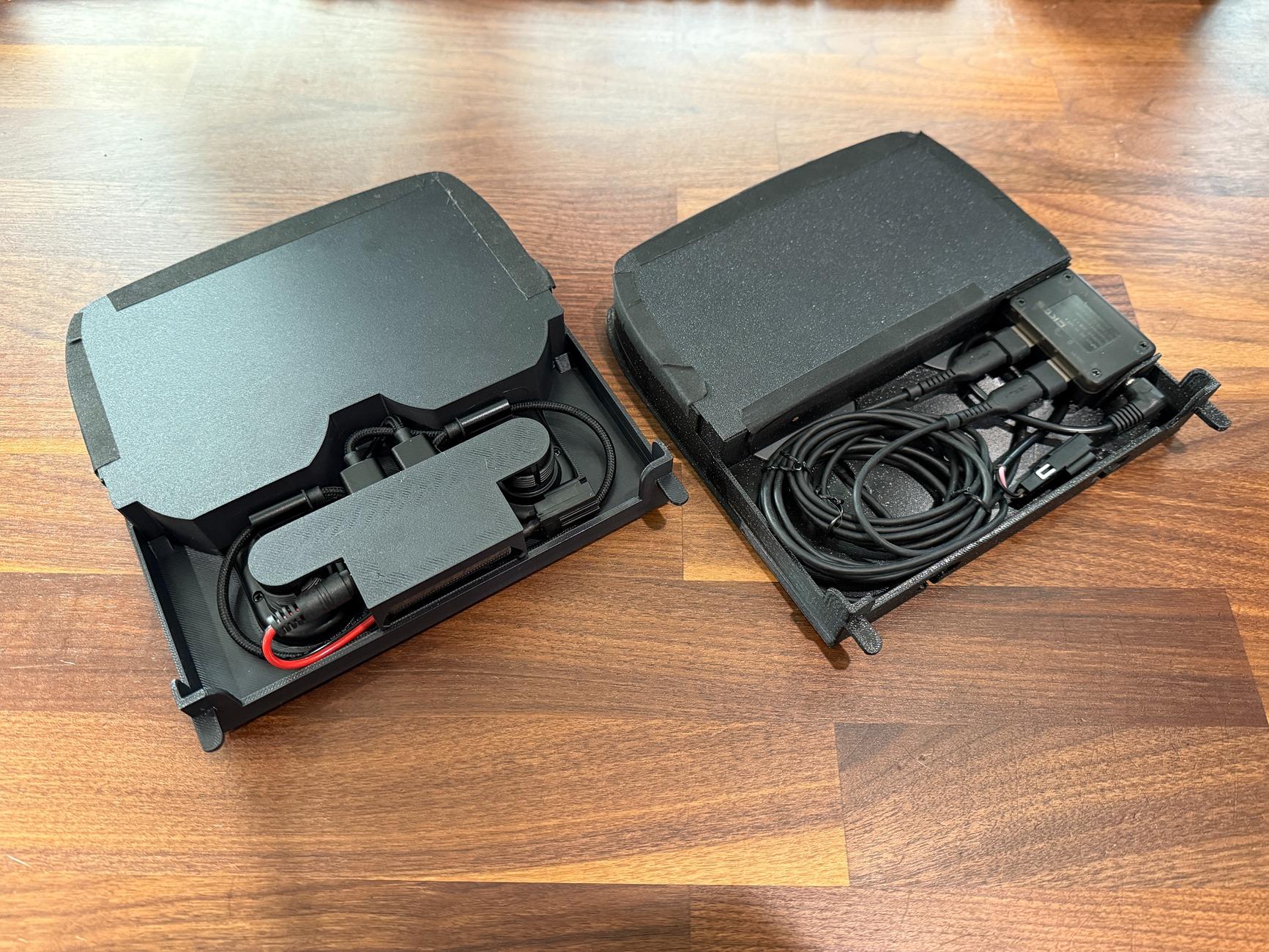

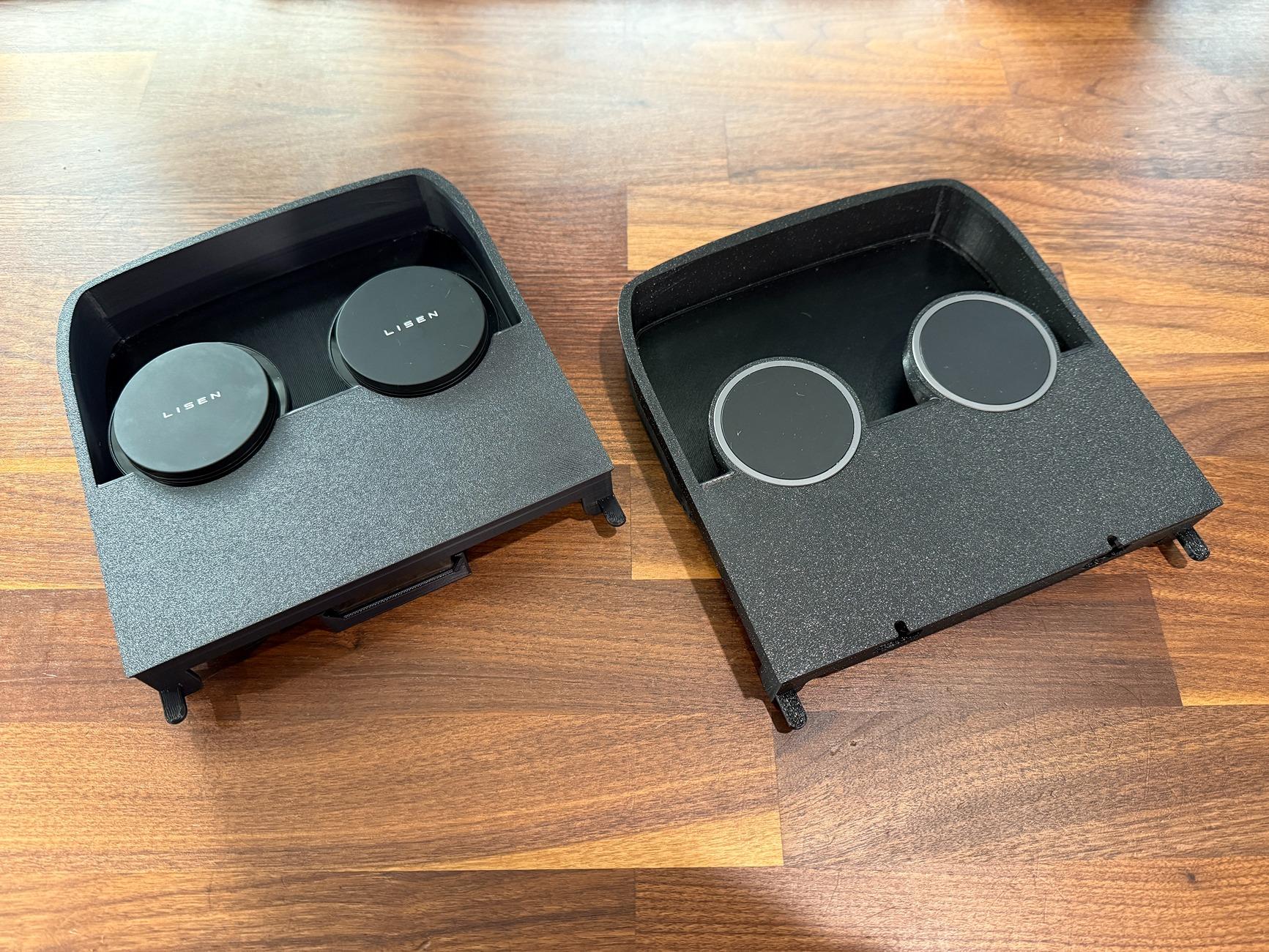

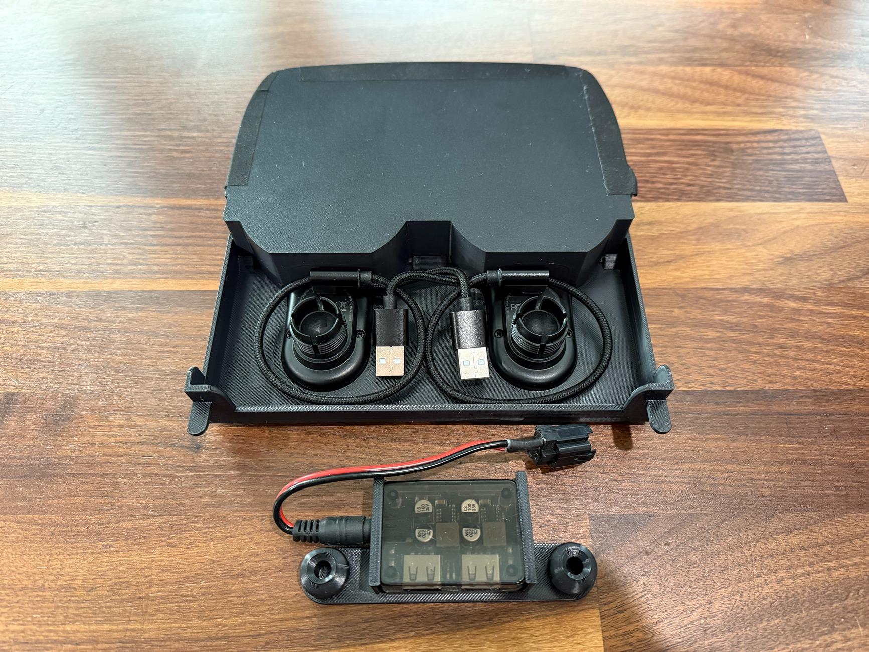

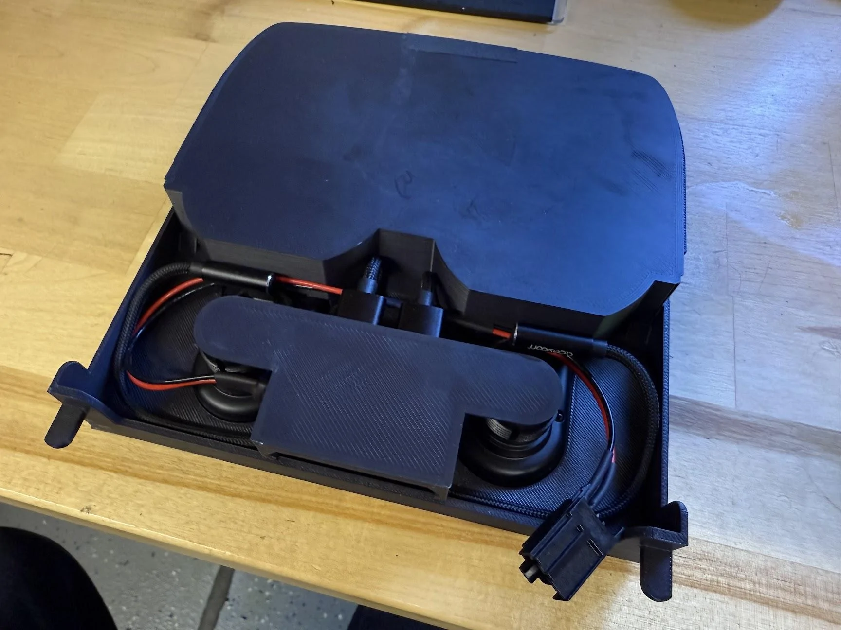

And so I made it. Here is what some of the prototypes look like:
Rivian R1T R1S Work In Progress: Charging and Cooling Pad Replacement for Gen 1 Rivians ADCD4F77-F6DD-4689-A4A9-9855BC8FC476_1_201_a
Rivian R1T R1S Work In Progress: Charging and Cooling Pad Replacement for Gen 1 Rivians 6D6D0794-58F3-486D-BA58-43445B34529F_1_105_c

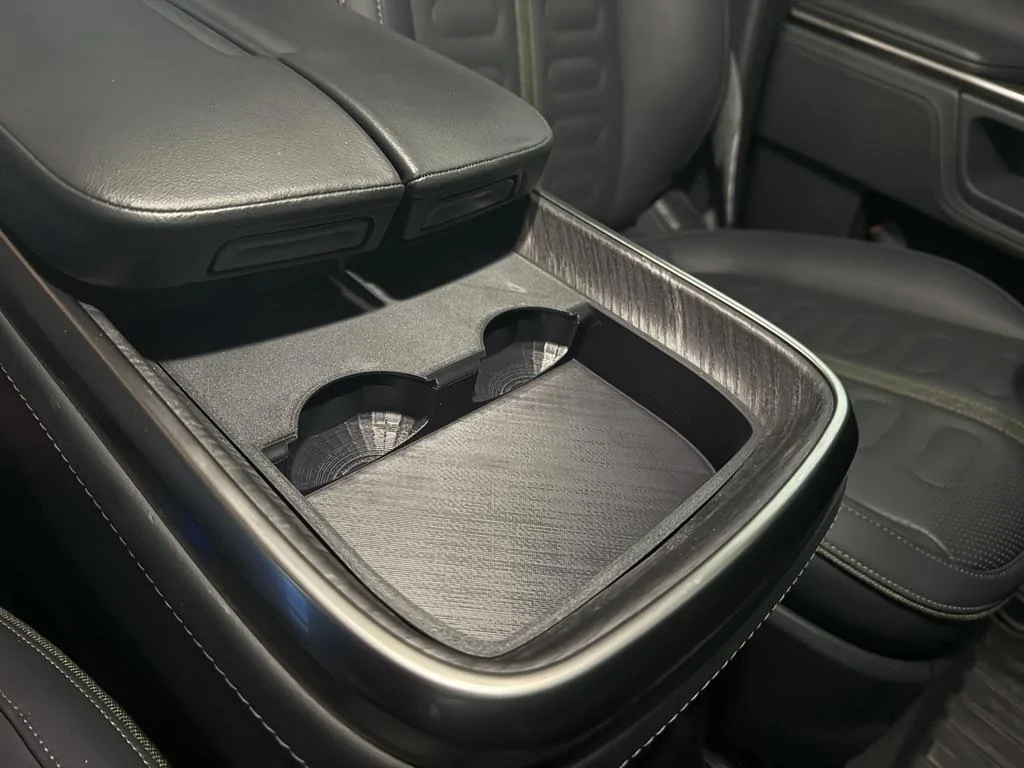

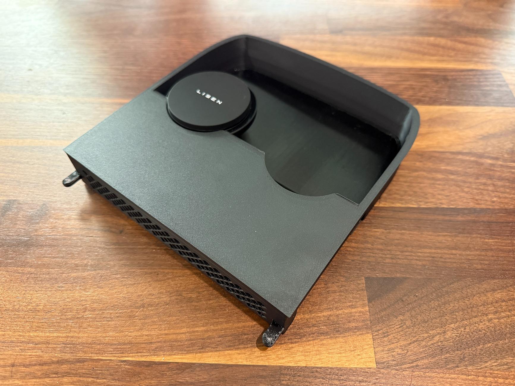

The process was actually remarkable simple. The ball mount was just shallow enough to fit under the plastic surround. I've carved out secondtions so that the air collected by the fan on the underwside of the charging pad is pulled from the large, carried over storage tray (not from inside of the thing itself)

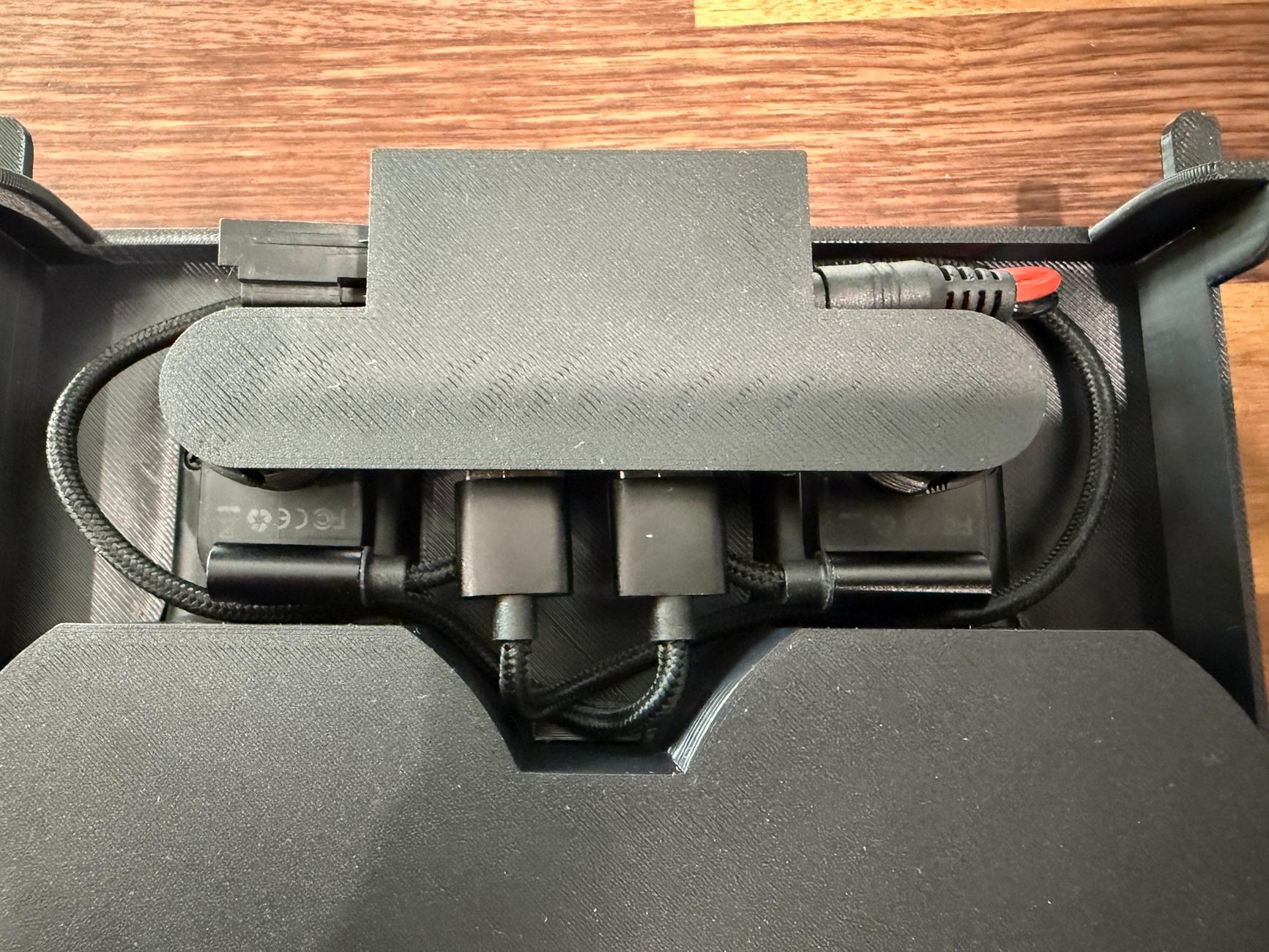

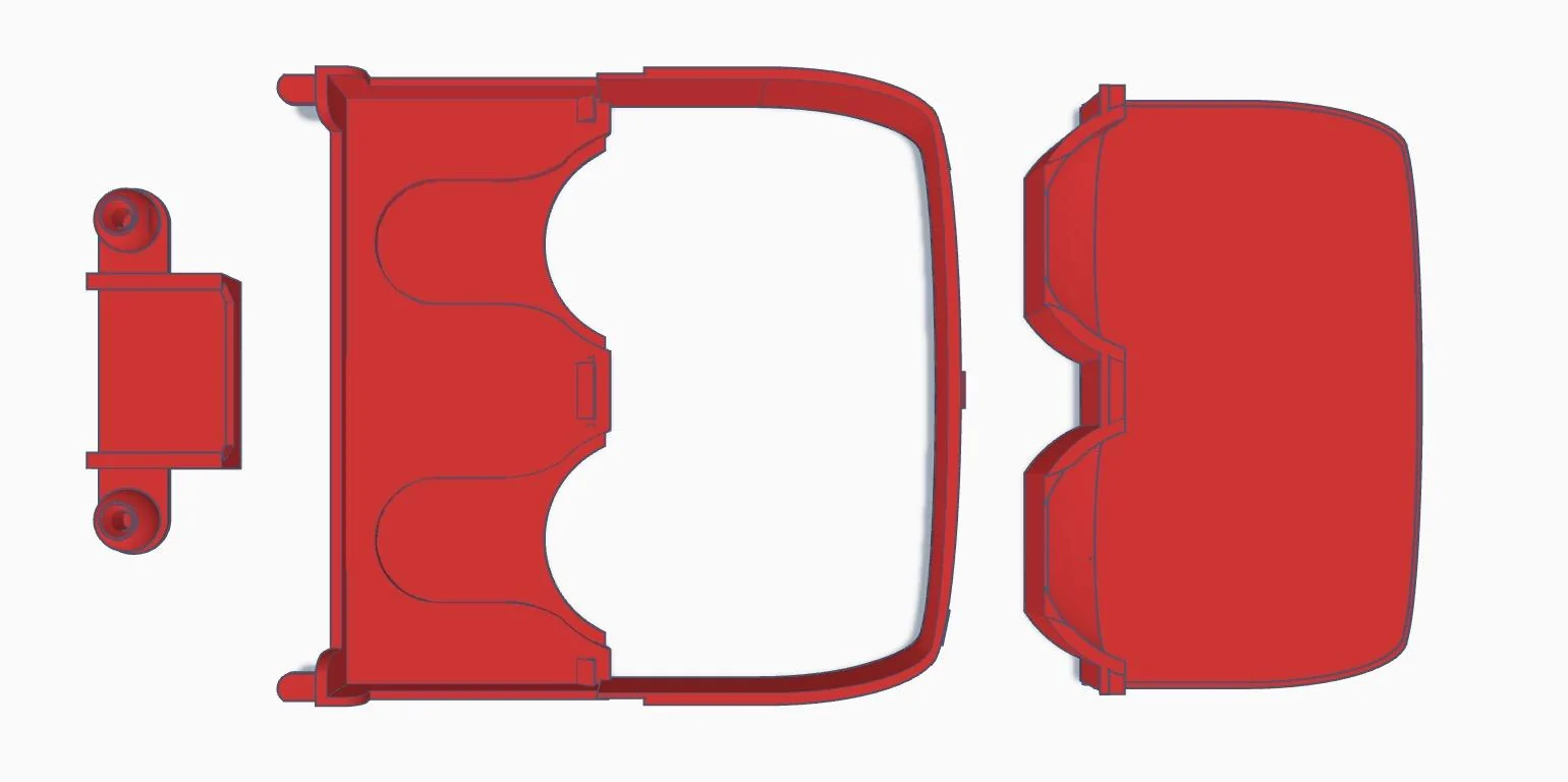

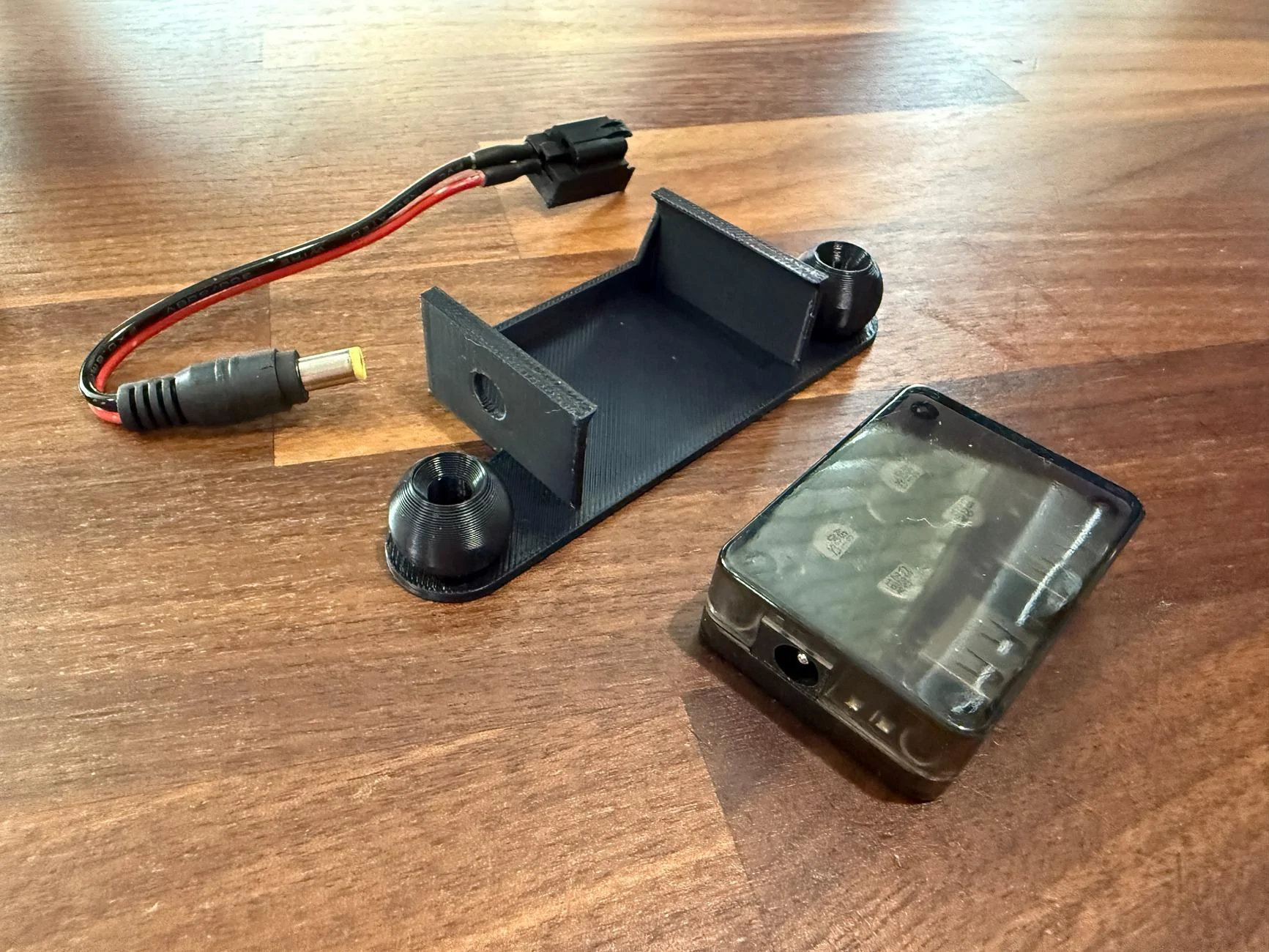

Construction is straight forward . You have the top section along with a clamshell setup that clips into the bottom, and a third, smaller bit that snaps into the ball mount. (all pictured below) That third bit functionally does a few things - holds the 12V to USB-A QC hub, and functions as a cable manager.
Rivian R1T R1S Work In Progress: Charging and Cooling Pad Replacement for Gen 1 Rivians Screenshot 2025-03-24 at 5.40.15 PM
Beyond that, I've reused the old style plug for power along with the same 3A/18W x 2 USB buck converter thats proven itself in the non-cooling setup for the last year or so. The cabling is slight different as the 90 degree barrel plug is swapped out for a straight version. Ironically, this is easier as the hubs come with this cable to begin with - I had to swap in the 90 degree cabling to clear in the old unit.

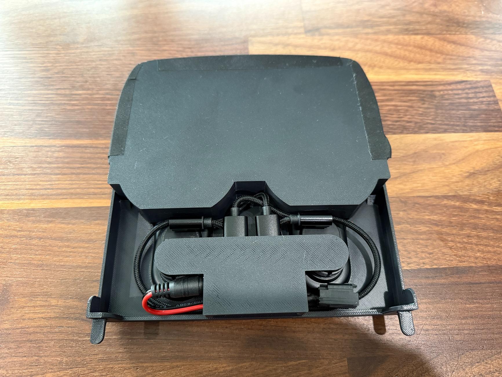

Essentially what is shown here is the clamshell tessa-taped together (these are compressed tighter when installed), the third bracket that holds the USB buck converter, 2 x 1ft USB-C to USB-A cables, and the Molex connector soldered to the included cabling. It's all pretty tidy when assembled. Assembly only takes a minute or two.
As you can see, everything is modular. Nothing is janky, glued shut, or shrink-wrapped nonsense. The cable is probably the closest, and that is due to be replaced with the correct, Tyco GET automotive connector setup like what we already sell.
Here is what it looks like compared to the Ultimate MagSafe Charging Pad V2:
Rivian R1T R1S Work In Progress: Charging and Cooling Pad Replacement for Gen 1 Rivians E49707EB-16AC-4F86-B0BF-685E380097A1_1_201_a
Rivian R1T R1S Work In Progress: Charging and Cooling Pad Replacement for Gen 1 Rivians EB558679-343D-4505-8195-FD9F85926518_1_201_a
That non-cooling setup is the prototype model which has been installed in my R1T for about a year.
I'm looking to upload the OpenSource STL files after do a bit more testing and tweak whatever is needed. (the USB holder / cable wrangler is a bit sharp, for instance) I'll be sure to post the parts list when that's done. Tentatively, here is what it looks like:
  • 2 x LISEN Cooling and Charging MagSafe Phone Holders
  • 2 x 1ft USB-C to USB-A cables
  • 1 x USB QC 3.0 (18w x 2) 12v Buck Converter
  • Tape
  • 3D Printed Parts
    • Upper holder
    • Lower clamshell
    • USB holder / cable wrangler
    • TPU liner

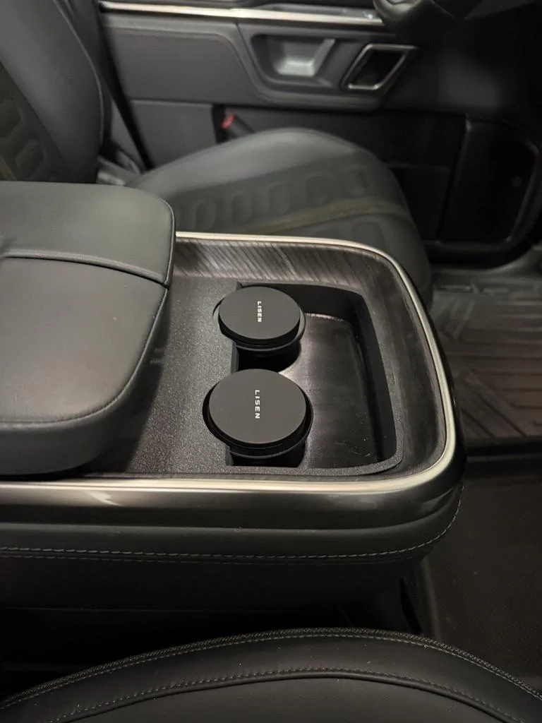

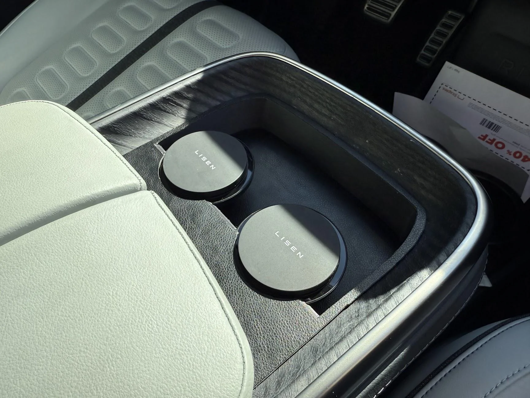

Thank you for designing this. I've been using first design with the Apple chargers but induction charging doesn't do well in a car due to heat. Hopefully this active cooling will do better. I've noticed that the magnets for these chargers stronger than the Apple ones too.

I like the covering!
