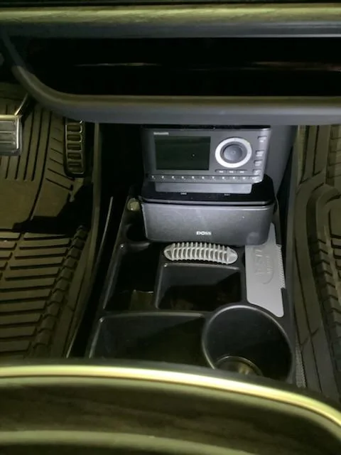

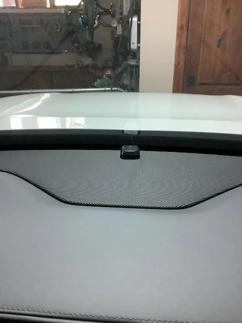

I tried the FM route too much static. My Rivian would not recognize the SMX BT radio or cradle. Here is what I did. Hope it helps. This is a repost.
Not being one to give up - nor wait for Rivian to act I have found a workaround. I installed a Sirius/XM Onyx Plus under the center dash next to the cigarette power socket and placed the magnetic antenna inside the vehicle centered on top of the dash by the front windshield. I ran the antenna lead between the windshield and dash (there is a foam strip there) to the passenger door pillar and down behind the plastic side of the dash. Fishing the antenna lead from there was a little more difficult. I needed to remove the passenger side fuse box cover and thread the lead back to the center and behind the plastic trim to attach it to the Sirius/XM receiver. Because I tried a Bluetooth cradle for the receiver and the Rivian infotainment center would not recognize let alone pair with the Sirius BT cradle I bought a Kindrm 2 in 1 USB BT 5.0 aux receiver/trans to see if it would work. The Rivian infotainment center would not recognize it either. So I bought a DOSS Soundbox portable BT speaker and did a direct AUX connection from the Sirius/XM receiver to the Soundbox. Forgot to mention I also used an Ainope 4.8A USB flush charger and a Sirius/XM 5V USB charger cable in putting this together. The pluses- if you don’t use the AUX direct connection to the Soundbox and use BT transmitters you can connect the Sirius/XM receiver to the Rivian camp speaker or the Soundbox by BT. Contrary to the Rivian infotainment center they will recognize and pair with the BT transmitters. By using satellite radio you don’t have Tunein constantly loading a new song in the middle of the song you are listening to nor needing to rely on ATT’s marginal cell tower coverage. The downside - you don’t have access to Rivian’s infotainment system to control the music nor the Meridian sound system. But surprisingly for being so small, the Soundbox does deliver an OK experience. The antenna placement on the dash provides an acceptable signal. Lastly, none of this modifies the Rivian in any way and is completely removable. As an aside the organizer in the photo is from Walmart. I attached the Soundbox to it by Velcro. One last comment the cigarette socket does time out when not in use so no need to power off the receiver. But the Soundbox has rechargeable batteries and stays on unless you power it down.

For those who may be interested here are the photos from the original post. Because of the angle of the photo the distance between the SMX receiver and the speaker box is a little distorted. This distance is actually a little greater. The receiver mount is next to the 12v outlet. The speaker box is mounted on top of the organizer.
