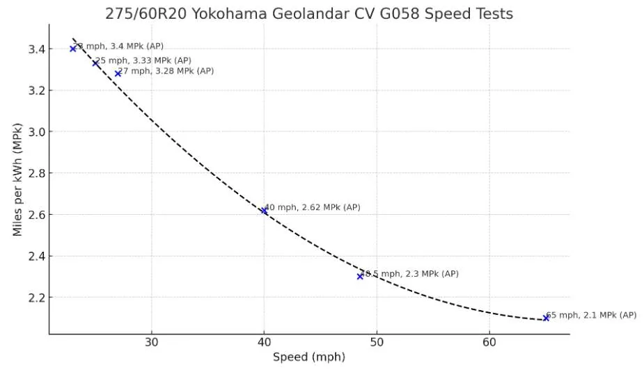

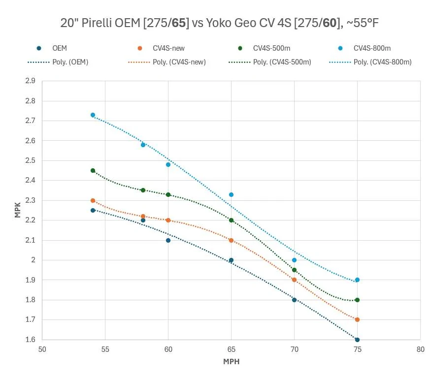

Update: June 26, 2024 - 2,400 miles on tires: 176 mile one way; temps in high 70s climbing to high 80s. Average speed of 60 mph (Conserve 100%). Consumed 81.2 kwh. Average efficiency of 2.17 MPK.

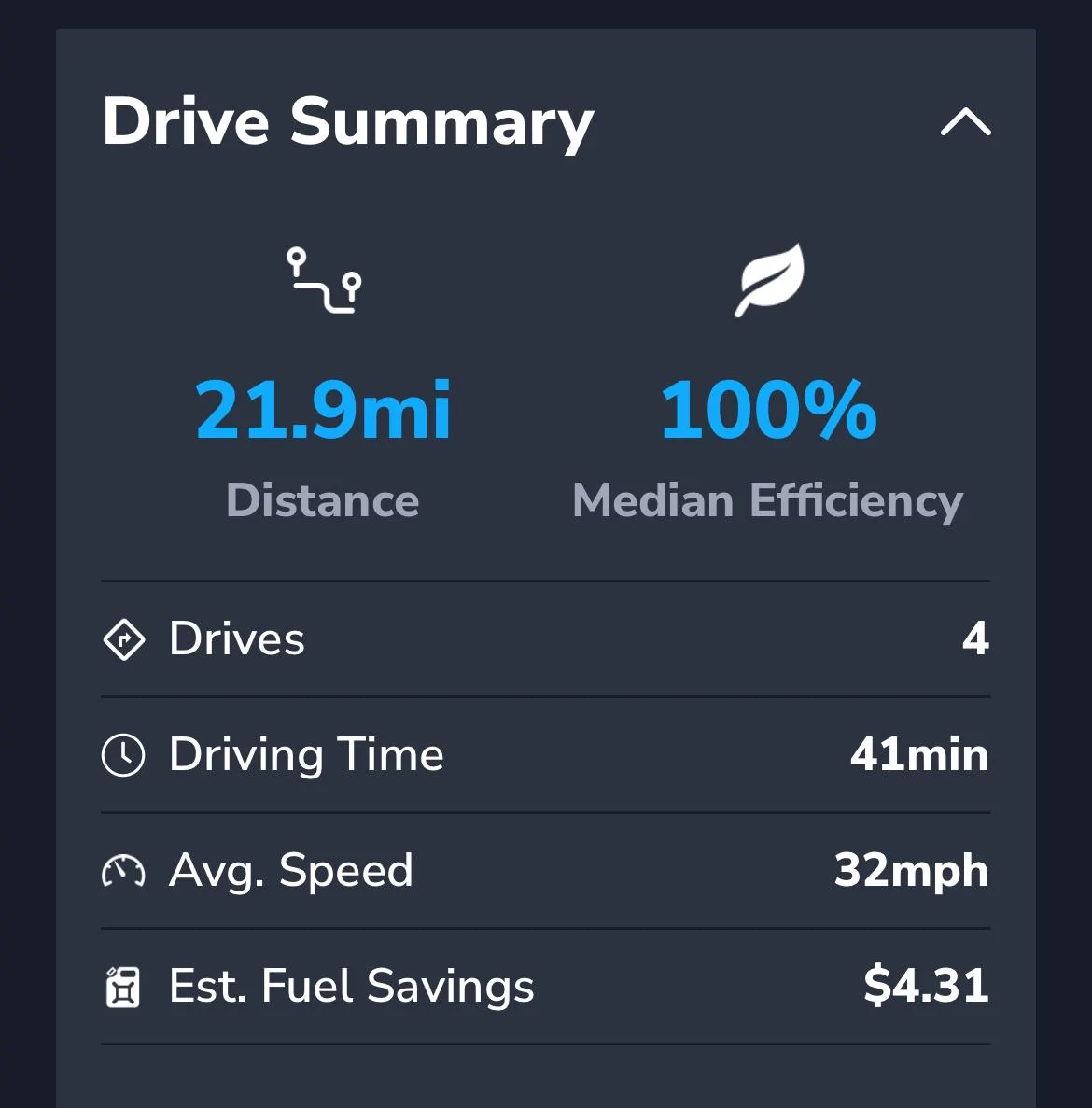

Update: June 11, 2024 - 1,800 miles on tires: 20.8 mile roundtrip; temps in low 60s. Average speed of 37 mph (All Purpose 90% non-highway). Consumed 8.3 kwh. Actual distance travelled of 20.2 miles. Average efficiency of 2.4 MPK.

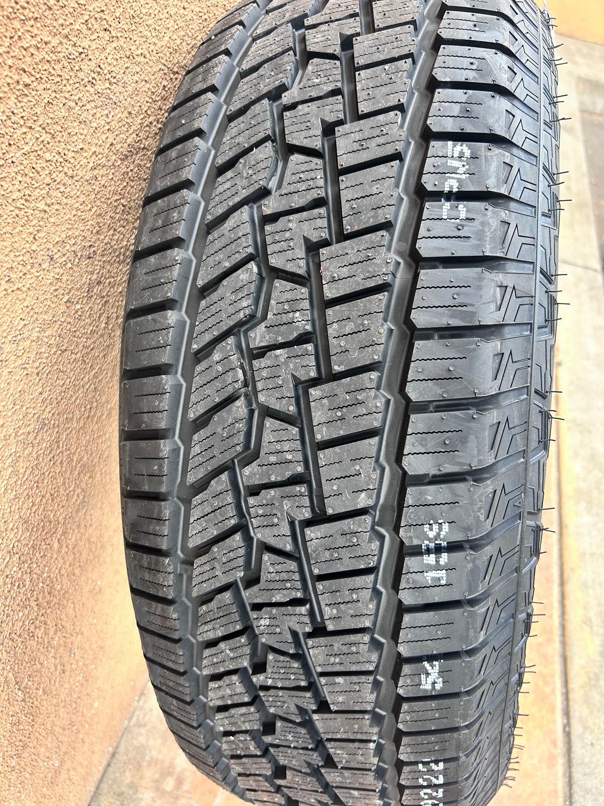

Installed the Geolandar CV 4S on 20" OEM rims, updated with performance and MPK...$245 per tire (simpletire.com). At 800 miles of wear, CV 4S are 11.7% more efficient than the 20” OEM Pirelli, primarily due to being 16% lighter weight (41.4#):
TireMPKAP RangeConserve Range
20" OEM2.15~275~315
CV 4S2.35~300~340
Tread wear: 12/32 @1,000 miles
11/32 @2,400 miles

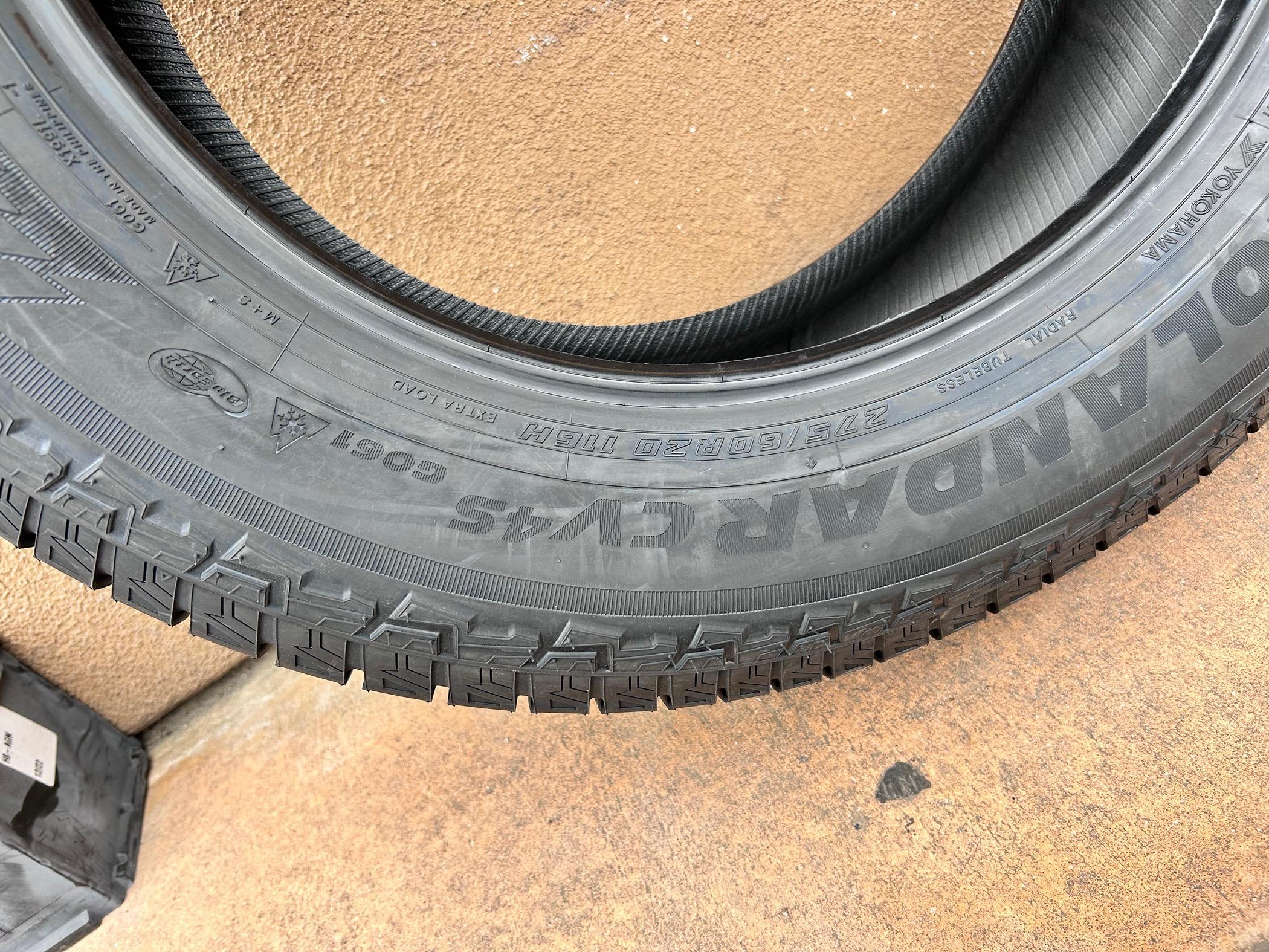

GEOLANDAR CV 4S SIZE & SPECS
Warranty: 60,000 miles
275/60R20 116H
Part # 110156136
Load I.D. XL
UTQG Rating 660/A/A
Unit Weight (lbs.) 41.4
Rim Width (Meas.) 8.0
Rim Width (Appr.) 7.5 - 9.5
Overall Width (inches) 10.8
Overall Diameter (inches) 33.0
Tread Width (inches) 8.1
Tread Depth 13
Static Radius (inches) 15.1
Rev/Mile 629
Max Load at Cold Inflation Pressure (Lbs. @PSI) Single 2756@50
Type BW

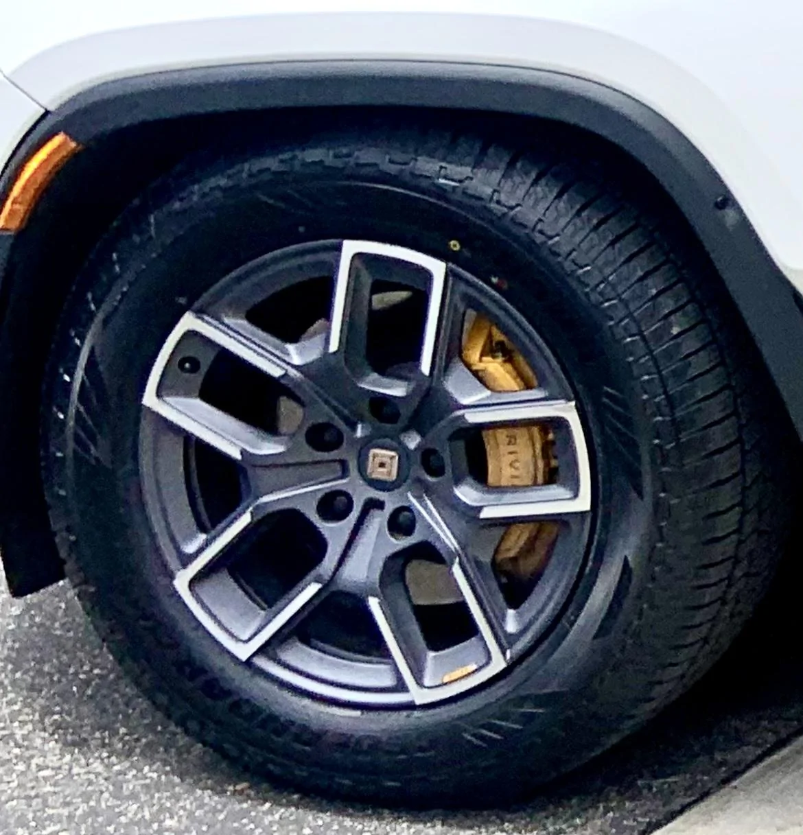

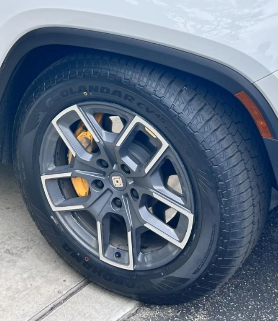

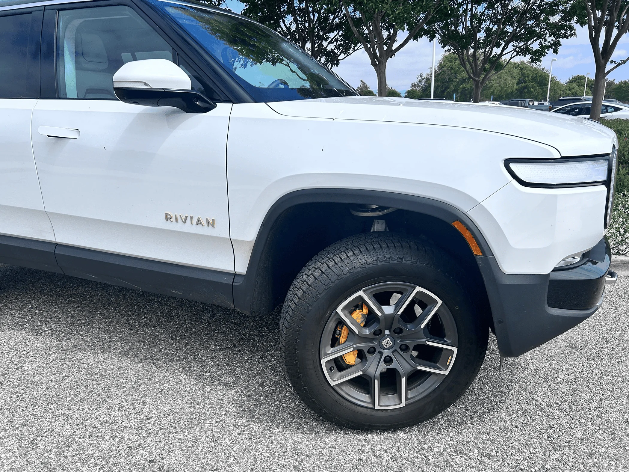

CV4S INSTALLED:
Rivian R1T R1S YOKOHAMA GEOLANDAR CV 4S | 275/60R20 - 116H - 660AA - 3PMSF IMG_3538

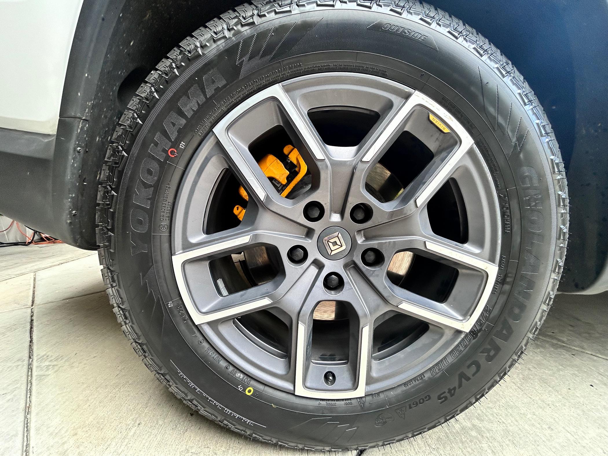

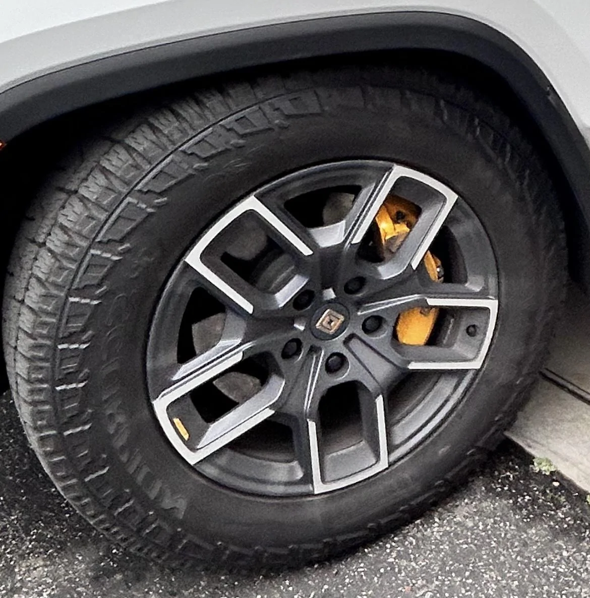

oem:
Rivian R1T R1S YOKOHAMA GEOLANDAR CV 4S | 275/60R20 - 116H - 660AA - 3PMSF IMG_3537

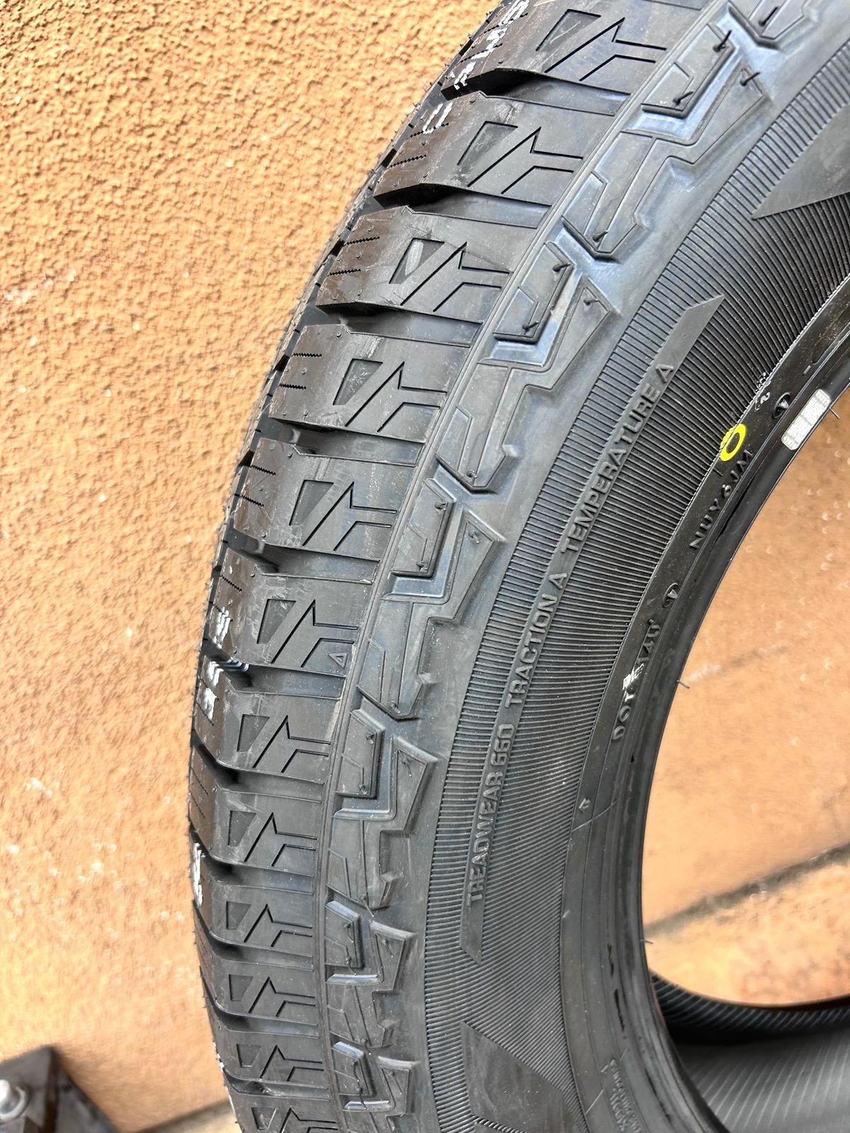

Rivian R1T R1S YOKOHAMA GEOLANDAR CV 4S | 275/60R20 - 116H - 660AA - 3PMSF cv-4s-test

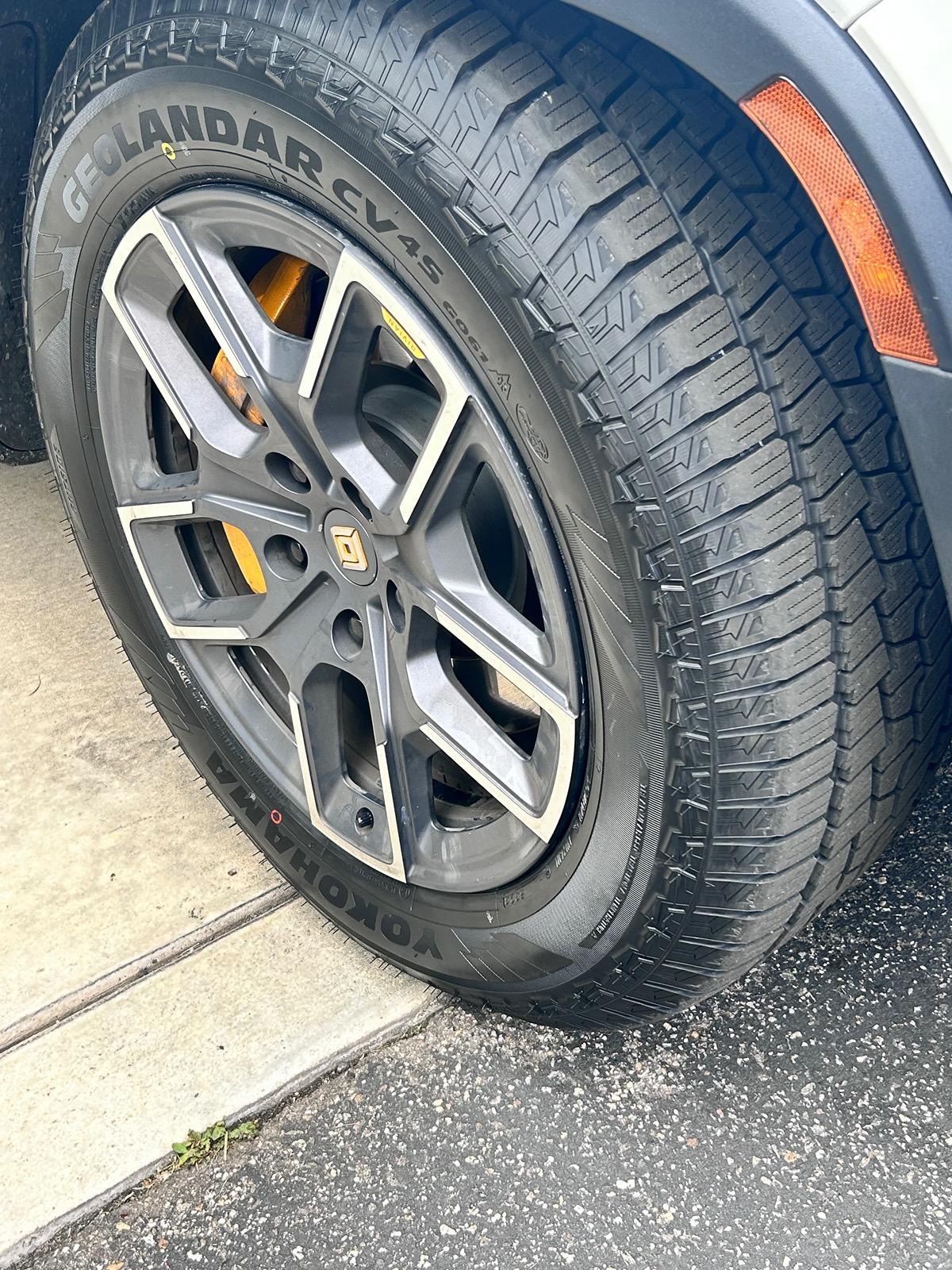

Rivian R1T R1S YOKOHAMA GEOLANDAR CV 4S | 275/60R20 - 116H - 660AA - 3PMSF 1718063834024-y
Rivian R1T R1S YOKOHAMA GEOLANDAR CV 4S | 275/60R20 - 116H - 660AA - 3PMSF IMG_4034

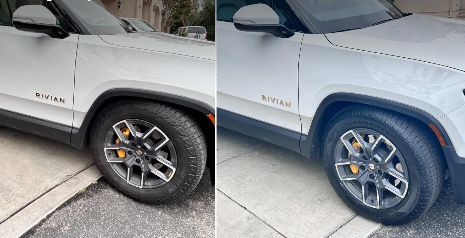

Initial thoughts:
Driving in Sport Mode is significantly improved. The “bouncy” feeling is essentially gone. Road feels more connected and overall a more stabilized and controlled driving experience. Pretty limited data but so far seems it’s at least as efficient as OEM 20” Pirelli. More to come but wanted to share first impression.
Rivian R1T R1S YOKOHAMA GEOLANDAR CV 4S | 275/60R20 - 116H - 660AA - 3PMSF IMG_3549
Rivian R1T R1S YOKOHAMA GEOLANDAR CV 4S | 275/60R20 - 116H - 660AA - 3PMSF IMG_3545
Rivian R1T R1S YOKOHAMA GEOLANDAR CV 4S | 275/60R20 - 116H - 660AA - 3PMSF IMG_3544
Rivian R1T R1S YOKOHAMA GEOLANDAR CV 4S | 275/60R20 - 116H - 660AA - 3PMSF IMG_3542

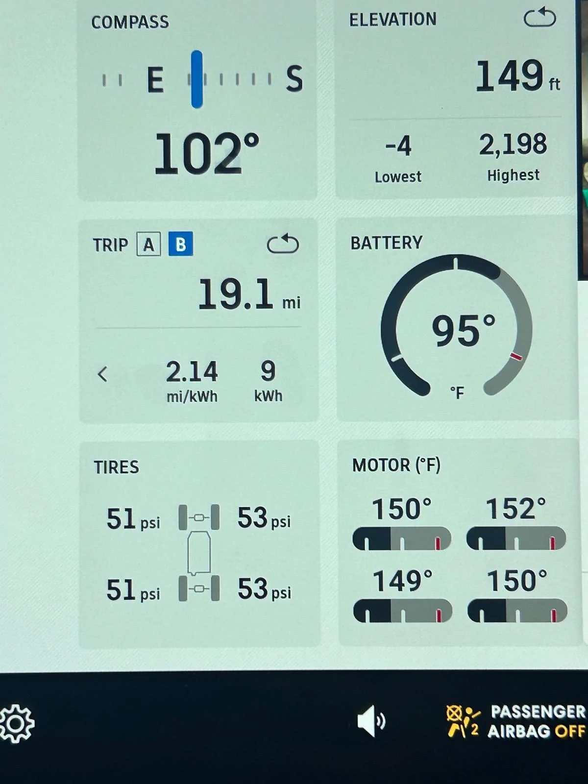

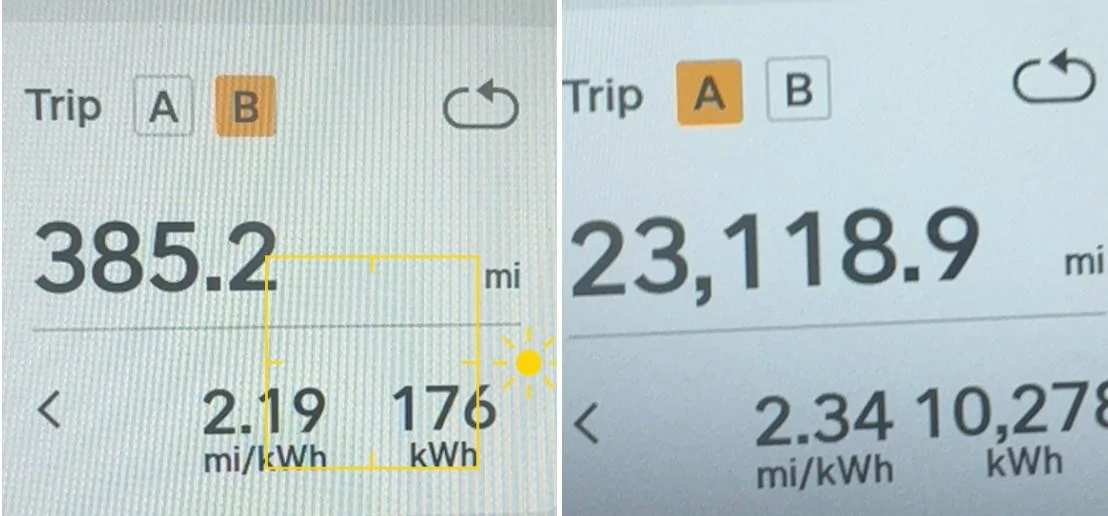

At 65 mph the Geolandar CV 4S was 2.14 MPK, 55F and no wind in All Purpose. Tires are new so hopefully will improve. Guessing they will be about 5% more efficient than the OEM.
No distance adjustment was needed. At 40 mph they are around 5% more efficient. The better ride/handling is the best part for sure.
Rivian R1T R1S YOKOHAMA GEOLANDAR CV 4S | 275/60R20 - 116H - 660AA - 3PMSF IMG_3554
2,581
3,422
At 65 mph the Geolander CV 4S was 2.14 MPK, 55F and no wind in All Purpose. Tires are new so hopefully will improve. Guessing they will be about 5% more efficient than the OEM.

What is frame of reference, the larger OE ATs?
Yes 20” OEM, realizing how bouncy they were, driving in sport mode wasn’t possible, now it is. CV 4S seem like a great tire that checks all/most of the boxes…obviously not a hard core off road tire but neither was the OEM.
