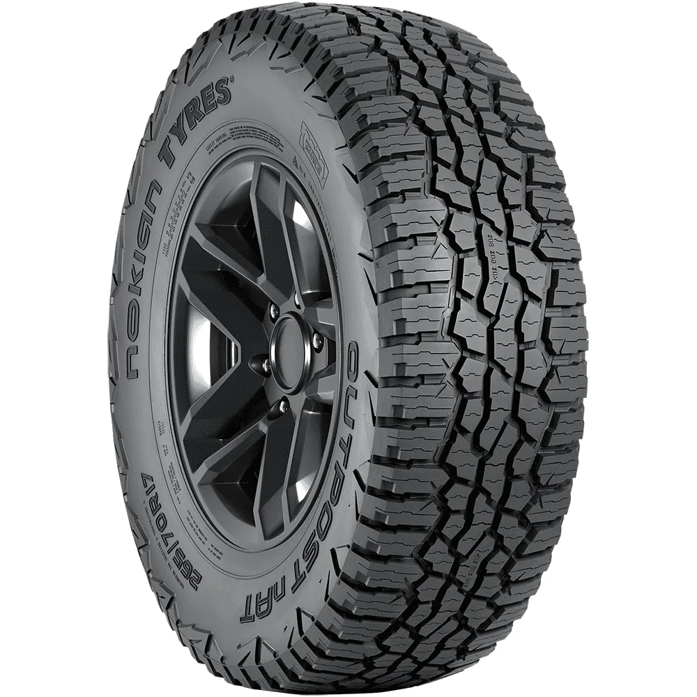

I ordered Atomic 20-inch Wheels [AWR1] and am moving from the 22-inch Rivian. I wanted more sidewall for light offroading and also a lighter wheel tire combo. I am going with the 275/60 20 with the Nokian Outpost NAT. The current 22-inch Rivian set-up weighs 83 lbs, and going with the Atomic Wheels and Nokian Outpost NAT, it will weigh 73 lbs.
TIRE SPECSTIRE SIZES
UNIFORM TIRE QUALITY GRADE (UTQG)
TreadwearN/A
TractionN/A
TemperatureN/A
SECTION WIDTH275
ASPECT RATIO60
RIM DIAMETER20"
OVERALL DIAMETER33"
RIM WIDTH RANGE7.5" - 10.0"
WEIGHT46 LBS
TREAD DEPTH18/32"
LOAD INDEX123
LOAD RANGEE1
MAX PSI80 PSI
SPEED RATINGUP TO 112 MPH
SIDEWALL DESC.RAISED BLACK LETTERING
WARRANTY60000
VPNT432880
GTIN6419440568393
Love the set up. Please post efficiency compared to your 22" when you get it. I'm thinking about this Nokian as well after my grabber HTS60 is done.

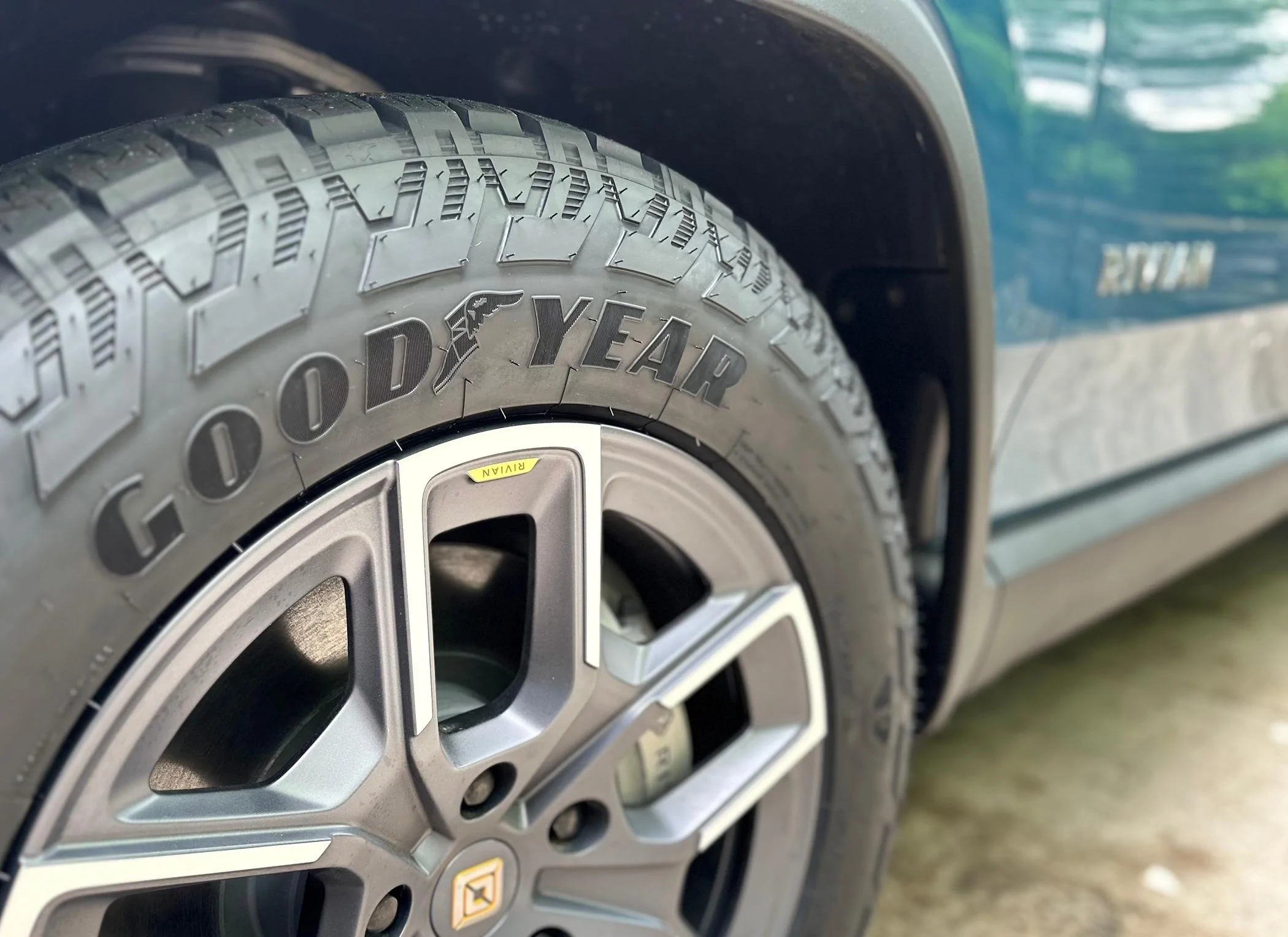

I work for Goodyear and am on the design team that worked with Rivian to develop the 275/60R20 Wrangler Territory AT for Rivian R1 Gen 2. In my opinion, it is a nice mix of efficiency, rugged looks and an all around great tire.
The new Goodyear 275/60R20 option was just recently released. Here is the link...
https://www.goodyear.com/en_US/tires/wrangler-territory-at/24354-73409564000000.html?back=tireFinder
Unfortunately, the image shown is currently not the new Rivian tire. I have raised this issue internally with my fellow Goodyear associates. Hopefully it will be addressed soon.
Tire Rack also has the the new Goodyear in stock. ...
https://www.tirerack.com/tires/tire...ckwall+Alternate+Design+3&partnum=76HR0WTATXL
As mentioned, this tire is brand new. Any reviews listed would be for Territory AT tires designed specifically for other vehicles.
Attached are some images of my R1T with the new Goodyear tire. I am a big fan of the truck and the tires!

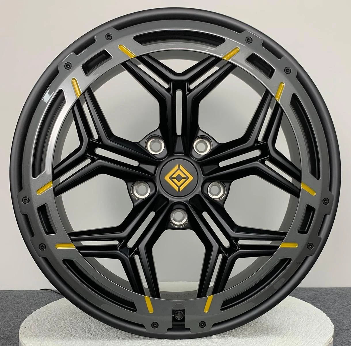

Guys, can you help me with the Atomic Wheels selection?
Some wheels are available in a 20x8.5" config while others 20x9". Does it make any difference?
Also, some of them have +48 offset (as OEM ones), and some have +45. Is there any real word difference? None of them will have a rubbing issue, but geometry-wise, is there any additional tire wear?
The goal is to replace 21" OEM. No off-roading. Planning to put Grabber or Wrangler Territory AT (for maybe light off-road in the future).
Stock size is 20x8.5, I would avoid the 20x9 unless you had a specific tire in mind and you were ok with not using the lowest ride height. Doesn't sound like you have a reason for 20x9 (unless you like/want a slightly wider stance).
Thank you! As for offset, does it make any difference: 45 / 48? Tire wearing?

45 instead of 48 mm offset shifts the tire 1/8” out, this is pretty negligible. I would keep 48 mm since that’s how Rivian designed it.
It’s only a 3 mm difference, making it almost OEM. This microadjustment gives a slightly wider look. The wheels do not sit flush because 3 mm is negligible. BMW owners, for instance, prefer aftermarket offsets with more than a 10 mm difference. Black Rhino offers ET38 for Rivians. Our ET42 or ET45 mm is nearly the same as OEM, but technically not. Honestly, it’s impossible to notice the difference between ET45 and ET48 with the naked eye.
Thank you. My only concern was the tire wear, not the external appearance
It won’t change. Many cars have several OEM options for rims and tires, which significantly differ from each other.
