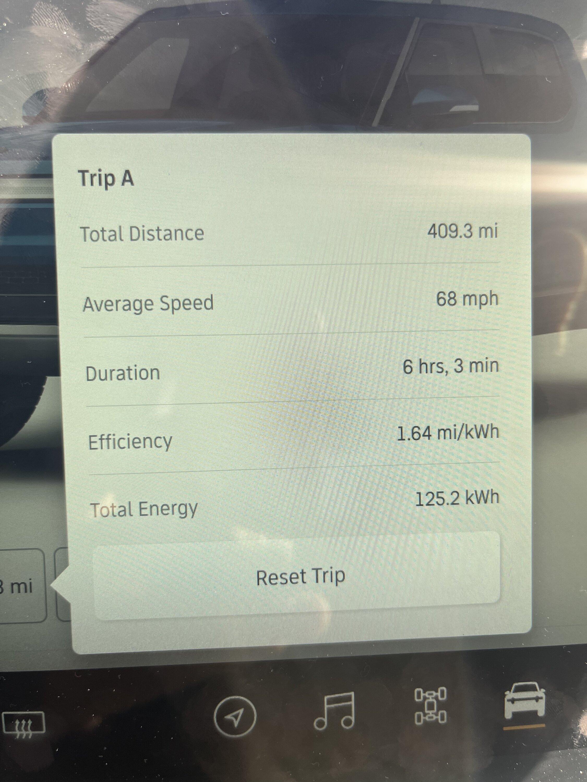

400 trip across KS/MO. Starting temp of 15F ended at 39F, with typical Kansas wind. Drove 68 mph on 20’s
averaged… 1.64 mi/kwh
Seems… not great. Even for the cold and wind. But maybe it’s just what to expect.

Being you averaged 68mph I am guessing on the highway you were going >70mph, maybe 75mph.
On the 20s at that speed with wind and cold this number doesn't surprise me at all. Looks like you are also dealing with the bug in your energy reported (400/125 != 1.68). On the highway above 70 even in summer you would be looking at 1.8-1.9mi/kWh.

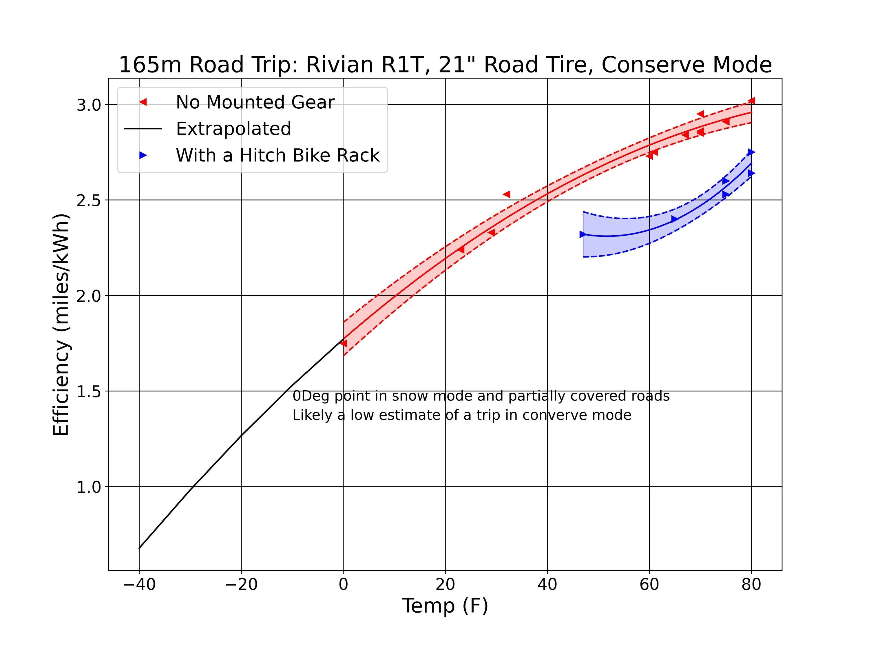

That is pretty low. My data on the 21" road tires in conserve mode is quite a bit better. My average speed on these trips is 54 mph. That's "average" speed. Half the trip on interstate, half on state highways.
Rivian R1T R1S 400 mi trip across Kansas/Missouri in R1T R1T efficiency vs tem
On the interstate it is 70 mph on cruse control. On state highways it's 55 with multiple slow downs through small towns. If you are doing 80 mph instead of 70 that has a very big impact.
I think OP's data is consistent with your curve right? If you take your 2.2 mi/kWh at 20F then subtract 0.33 (-15% for 20" ATs) and then 0.2 (~10% for AP vs Conserve) gets you to around 1.7 mi/kWh.

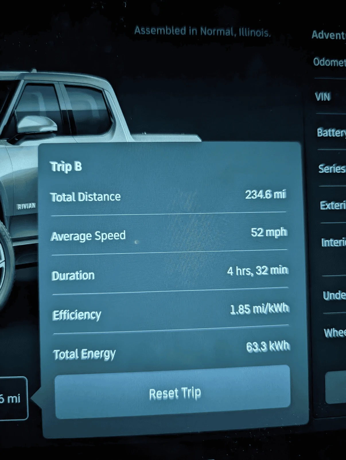

For comparison, I did a 235 mile trip yesterday in Illinois. First leg of ~80 miles was 2 lane highways and country roads. The remainder was interstates, at about 75-77 mph. Was hoping to make the whole trip with no charging stops but ended up being a few miles short and had to pop into Chase EVgo in Oakbrook Terrace IL (Chicago area folks this is a great location, restaurants available and I was charging at 215kwh, added 100 miles in 19 minutes even though I only needed about 10 miles to make it home. ). Temperature was 23 degrees most of the trip. First leg was efficiency of right around 2. The rest was 1.6 to 1.8. I charged right before I left to try and raise the battery temp. Overall pretty happy. Did a head to head comparison of the Rivian nav to a Google maps efficient route. They were very different, the Google maps plan had better arrival times by about 2 or 3 minutes. Abrp was off by about 10%, it did not predict a charge.
R1T, 22 inch wheels, conserve mode, climate set at 67, heated seats on at lowest level, I had a full charge, half a pack of cigarettes, it was dark and I was wearing sunglasses:)
Here are the stats I guess the total energy Calc is inaccurate.
