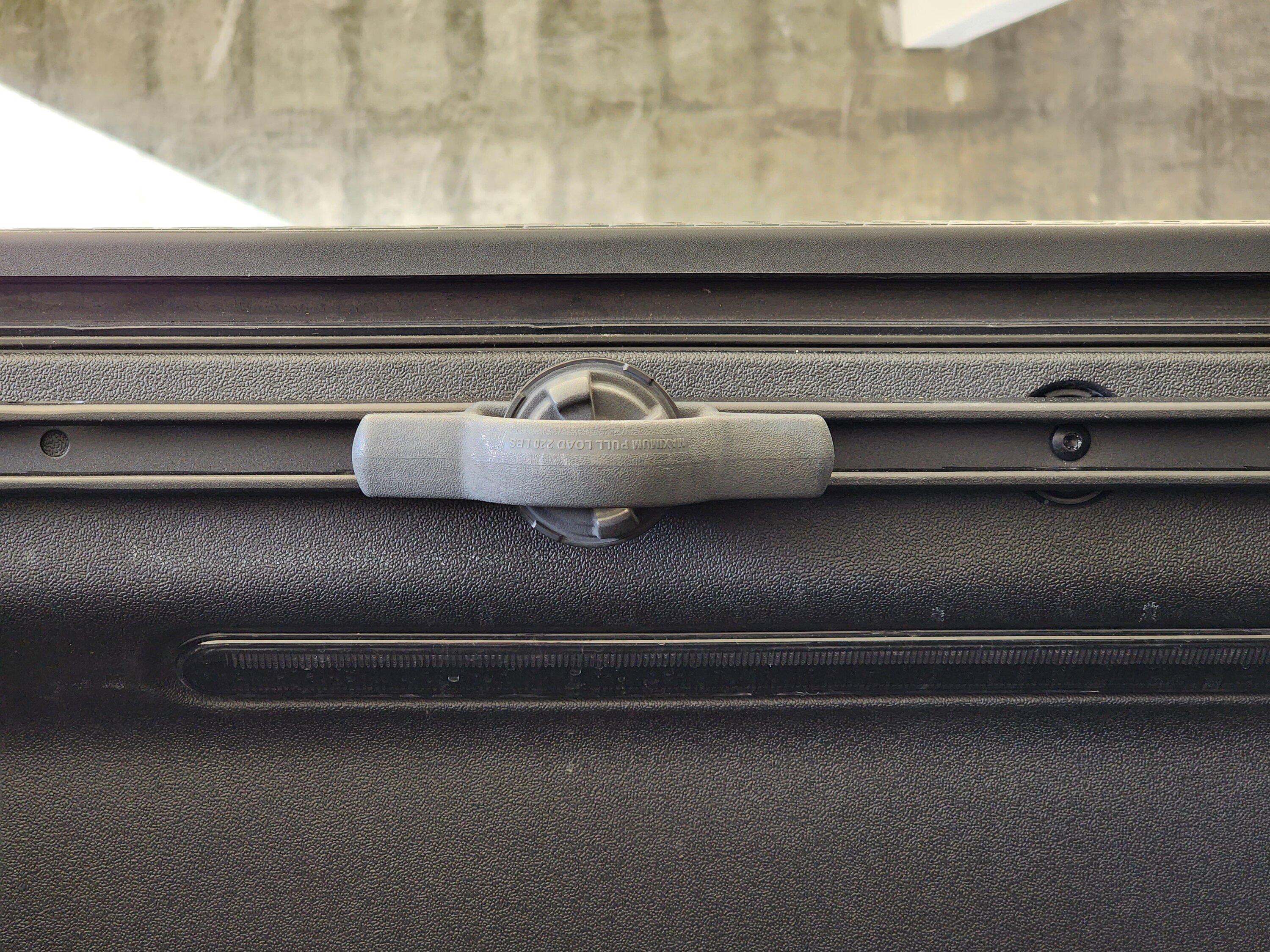

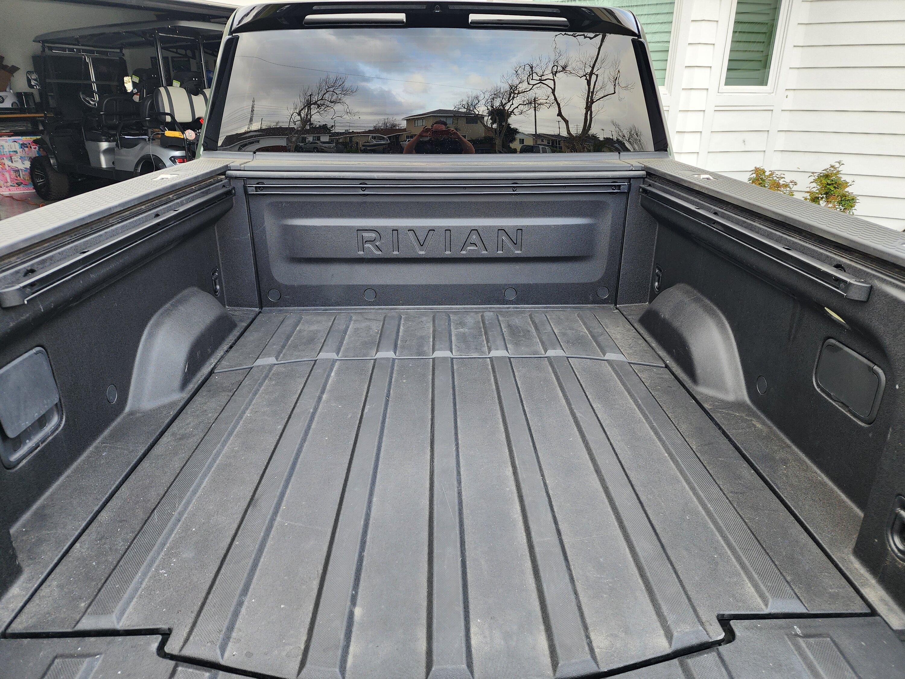

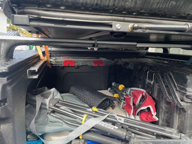

If you're looking to add some more tie down points this might be an option for you. I was missing the versatility of the rail system on my previous Tacoma. I do track days and have to haul a lot of gear with the tail gate down. I ended up buying the 3 tacoma bed rails, end caps, and m6 bolts from my local toyota dealership. Part numbers on the attached invoice. I purchased 2 extra m6 bolts, you only need 10. Cost me around 200 bucks all in.

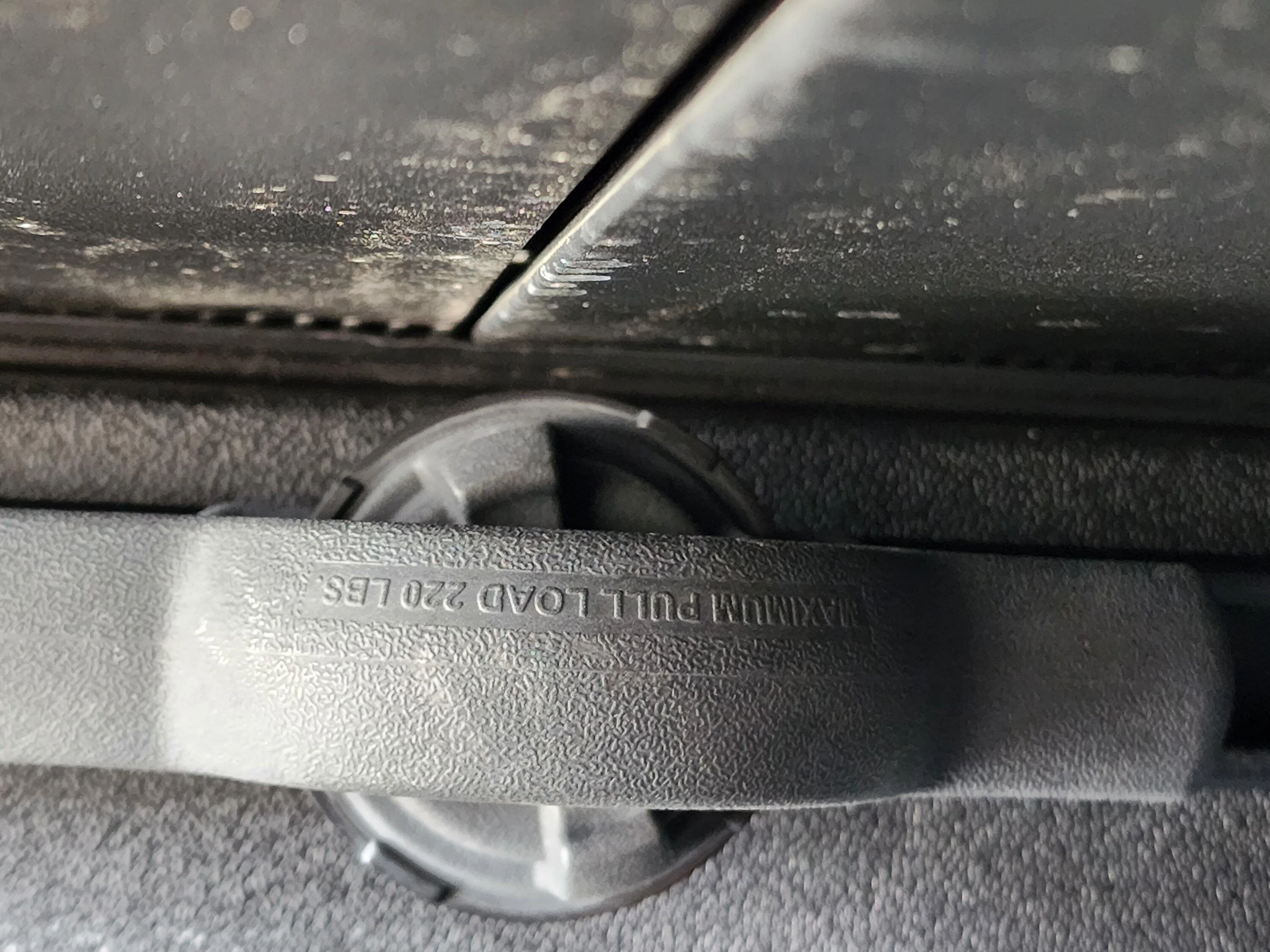

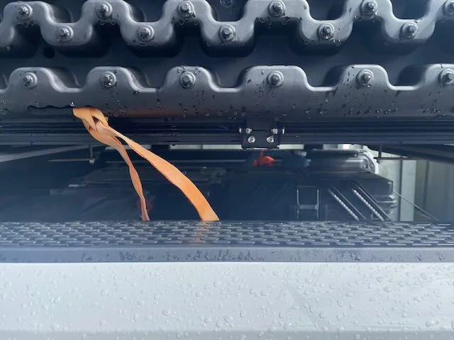

Mounting bolts use the 3 capped points on the side of the bed and 4 on the header. Discard the plastic caps, and 10mm bolts, re use the large metal spacers. All three rails were slightly too long, I cut them down with a grinder. You will also need to drill 2 holes on the side rails and 2 on the header rail. You can use 1 pre driled hole on the side rails and 2 on the header rail. My tonneau cover clears with plenty of space. I'm going to buy the tie down cleats off Amazon. The Toyota ones are 25 bucks each if you order from the dealership. Update, on my truck the tonneau just clears the oem toyota cleats. Pics added. The header rail is very close, sides have more clearance.
Really happy how it turned out, looks OEM with the black finish.

Side cleat clearance

Header rail clearance

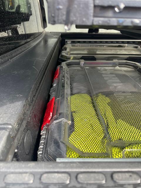

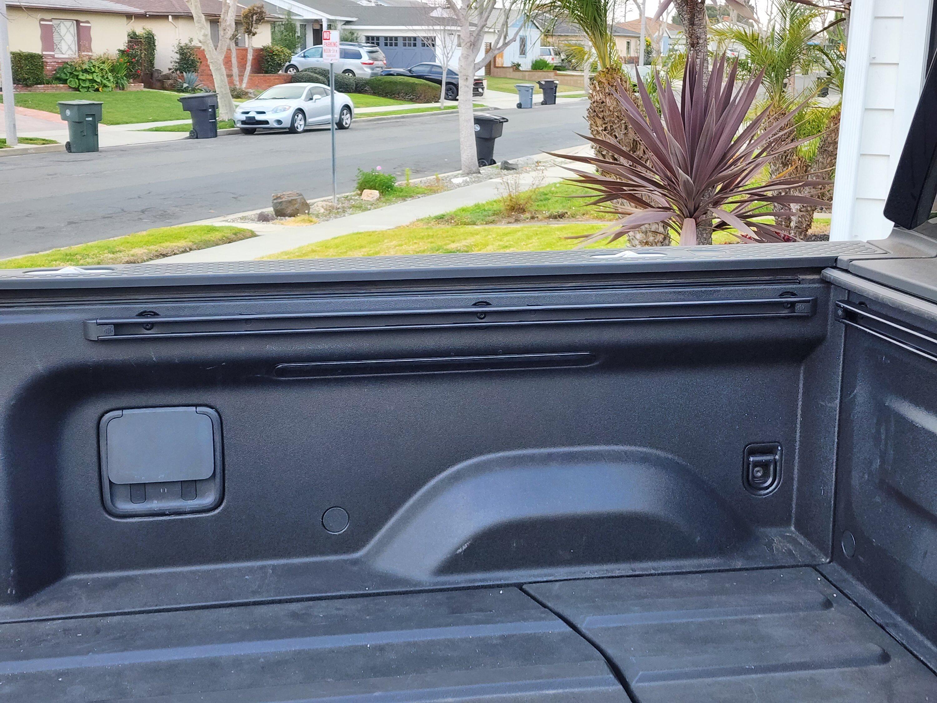

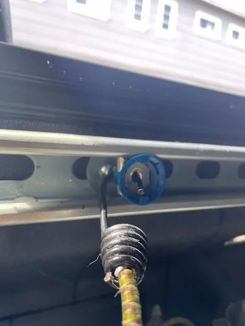

Currently in the rough in phase:
Will paint and get end caps eventually
Rivian R1T R1S R1T bed tie down rails installed (adopted from Tacoma) IMG_0669
Rivian R1T R1S R1T bed tie down rails installed (adopted from Tacoma) IMG_0670
Rivian R1T R1S R1T bed tie down rails installed (adopted from Tacoma) IMG_0672
The back of the bed walls have a slant that starts near the tailgate, so you cannot make the rail full bed length without some creative bending/ back grinding. I just chose shorter rails.
Rivian R1T R1S R1T bed tie down rails installed (adopted from Tacoma) IMG_0674

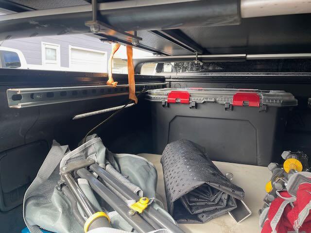

Will Be adding a back rail and some of the half strut on the tire cover for proper tie down points
Rivian R1T R1S R1T bed tie down rails installed (adopted from Tacoma) IMG_0675
Rivian R1T R1S R1T bed tie down rails installed (adopted from Tacoma) IMG_0673

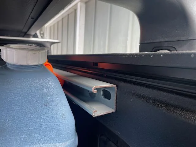

Haven't had the chance to run to the store but there are infinite unistrut tie down options,
a popular one is to just use a nut, plate and eye bolt. also, as stated previously he Nissan cleats (and all Nissan "Utilitrac" accessories work with it as it is the same dimensions.
I also like that this/the Nissan track is metal, iirc some of the taco tracks are a polymer, if that matters to anyone
This may actually open up the option to use the Nissan bed extender, will try whenever I get around to visiting my dad and stealing it off his
Rivian R1T R1S R1T bed tie down rails installed (adopted from Tacoma) IMG_0671
(sneak peak as the much more interesting project I'm working on (used unistrut scrap as well)
