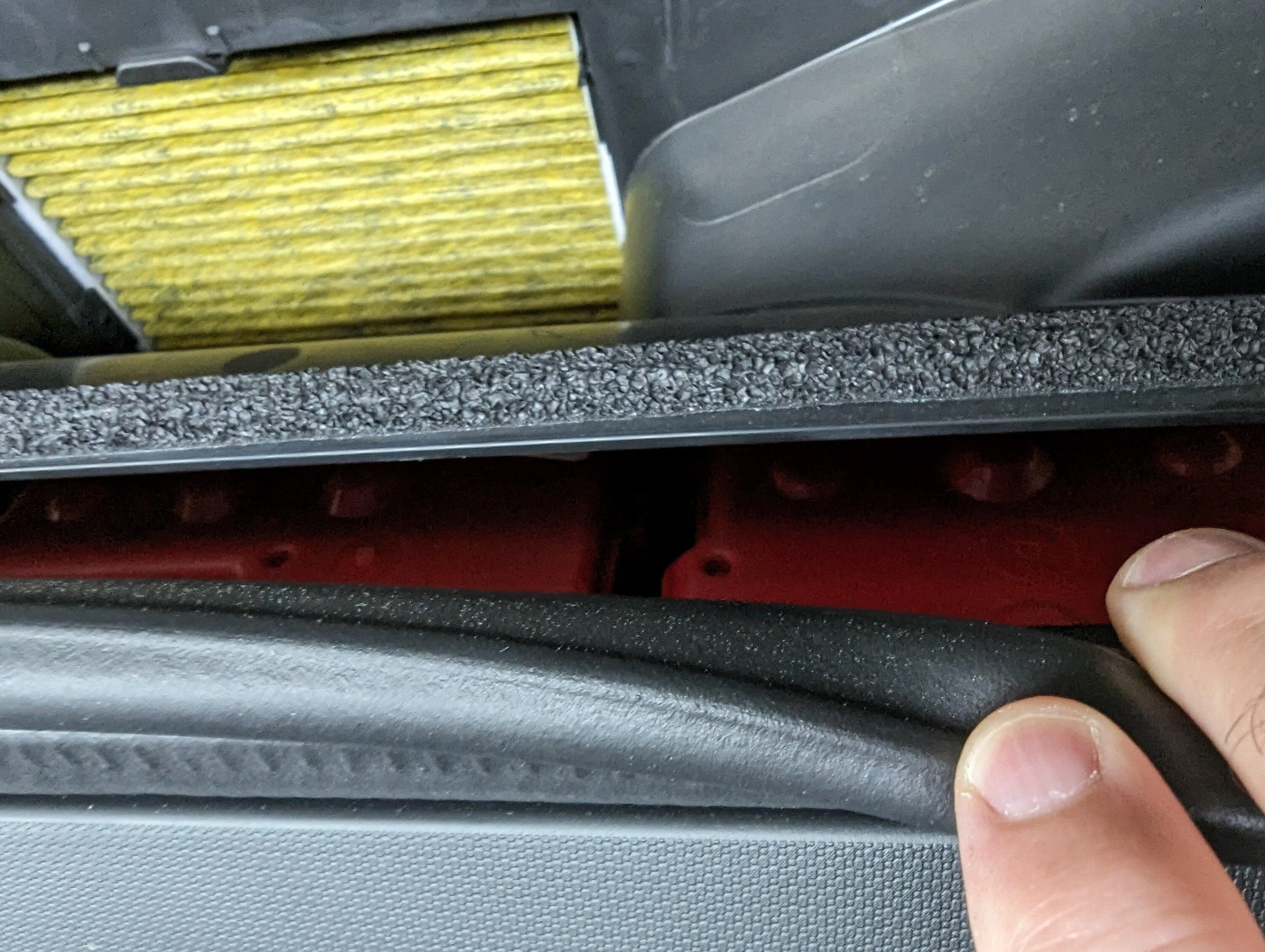

I appreciate the clarification. You made me stop being lazy and I just checked our R1S which was built in April. I can verify that it has 2 batteries.
Now, if only I could verify that I snapped the air intake cover back on properly. :giggle:
