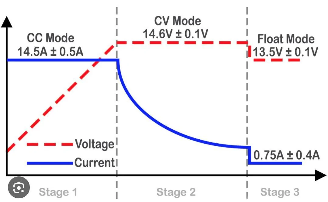

It's entirely possible to overcharge. When the chemistry is full up on electrons and can't take any more, that surplus force feeding... i.e. energy... has to go somewhere. Heat. Gas, i.e. chemical reaction and irreversible change to chemical composition; a "cooked" battery.
Physics does not work that way…if your battery is, say, already 15v and your charger can only supply max 14v, there is no way to “force” the electrons into the battery, no matter how powerful the charger is.
@UnsungZero_OldTimeAdMan is correct. It is entirely possible to overcharge if a modern smart charger fails, or an old school linear charger (those big heavy transformer/rectifer based units) is left connected too long.
Lead Acid batteries have a charge profile curve, and once the battery is fully charged, the voltage must be decreased - otherwise, heat and plate oxidation damage can occur.
A dead battery does not have any more, or less, electrons than a fully charged battery. The number of electrons in the battery/circuit is essentially constant (physics demands that). Charging increases the energy level of the exisitng electrons in the chemistry.
Since the charger is increasing the energy level of the electrons, that energy gets transferred into electrons in the battery. When the battery is fully charged, due to resistance, a small current will continue to circulate. The electrons can't absorb any more energy, so that energy gets dissipated as heat and can damage the battery. By reducing the voltage to float level, it maintains the proper energy level.

I was explaining why it's not possible to "overcharge" the battery to 19v. While your explanation is mostly true, still does not explain how that's possible. Assume the charger is faulty, energy got dissipated as heat, or gas due to chemical reaction, or whatnot, but won't increase the voltage to 19v.

Nobody posted here that their battery was overcharged to 19 volts nor was I implying as such. What they said was that the charging voltage was recorded by Rivian's logs as 19v. The battery had 19 volts applied to it during charging. That's considered overcharging - the recommended charge voltage/rate/duration for a 12 volt lead acid battery was exceeded.
Overcharge: The forcing of current through a cell after all the active material has been converted to the charged state. In other words, charging continued after 100% state-of-charge is achieved. The result will be the decomposition of water in the electrolyte into hydrogen and oxygen gas.
