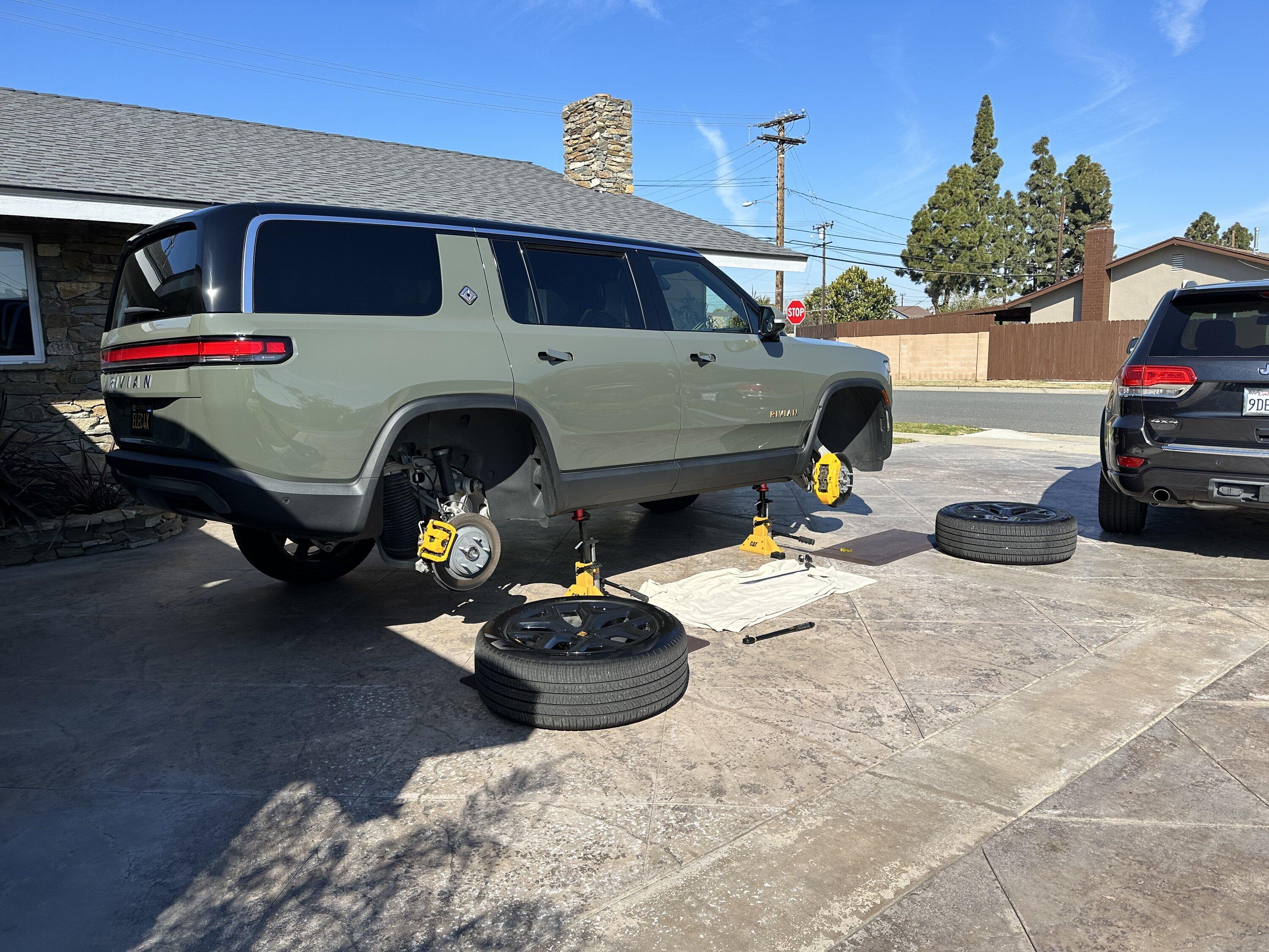

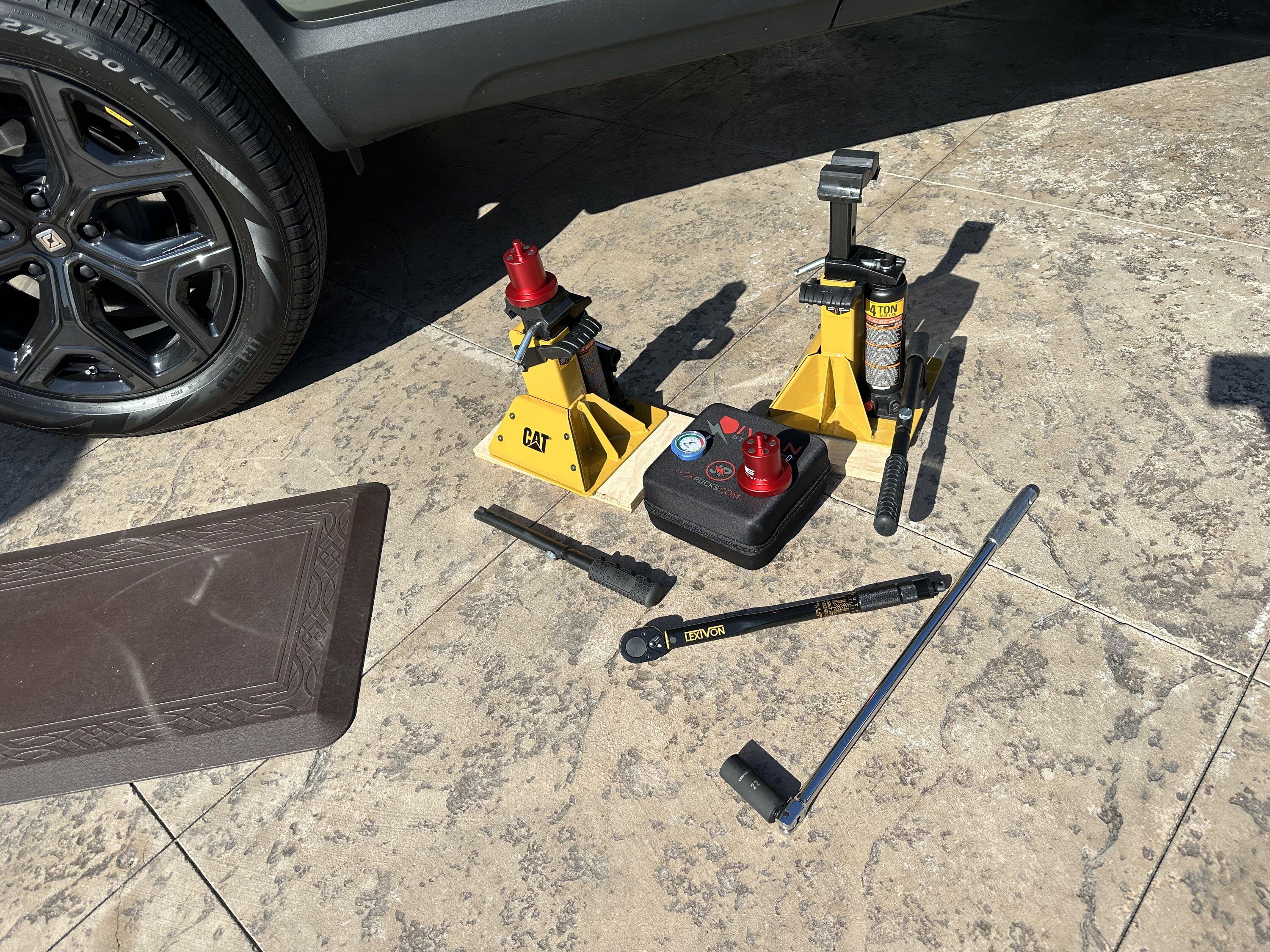

Thought I would share information on my first tire rotation at 6k miles. I have a couple of 4ton Jack stand/bottle jack combo units. They worked great with the pucks I purchased. It is a great time to clean off the brake calipers as well.
Here is what I used;

@SANZC02 , did you jack say, the front up first, then the rear, or did you jack a little in the front, then the rear, then the front…?
7,505
12,880
7,505
12,880
@SANZC02 , did you jack say, the front up first, then the rear, or did you jack a little in the front, then back…?
I did half and half, you can do it all at once but the whole side lifts up, it is pretty stiff. I just wanted to minimize the gaps so half in front, lifted the back, then finished the front.

Looks like you used a breaker bar and then a ratchet wrench, is that right? I wonder if the onboard air compressor would run an air wrench for taking off and mounting the tires?

Bottle jacks used by OP, for those who are interested:
https://a.co/d/jdAFohO
Thanks for sharing the link.
I also didn't know these existed, seems more compact too. Are there alternatives to consider, or is the Cat 4 Ton All-in-One Truck Jack a pretty good choice? Don't think Project Farm has this specific category tested!

Yes I used a breaker bar and torque wrench. I have an air compressor and impact wrench but unless I’m in a rush I prefer breaker bar so I don’t over tighten the lugs. Hard to tell with an impact wrench when over tightened as the torque wrench will not tell you if it is over 190 just that it is clicking that it is at least 190. I usually tighten mostly with breaker bar and finish with the torque wrench.
The air compressor does not have a storage tank or capacity to drive power tools. Most torque wrenches require high airflow, something like 8-9 CFM at 90-100 PSI.
