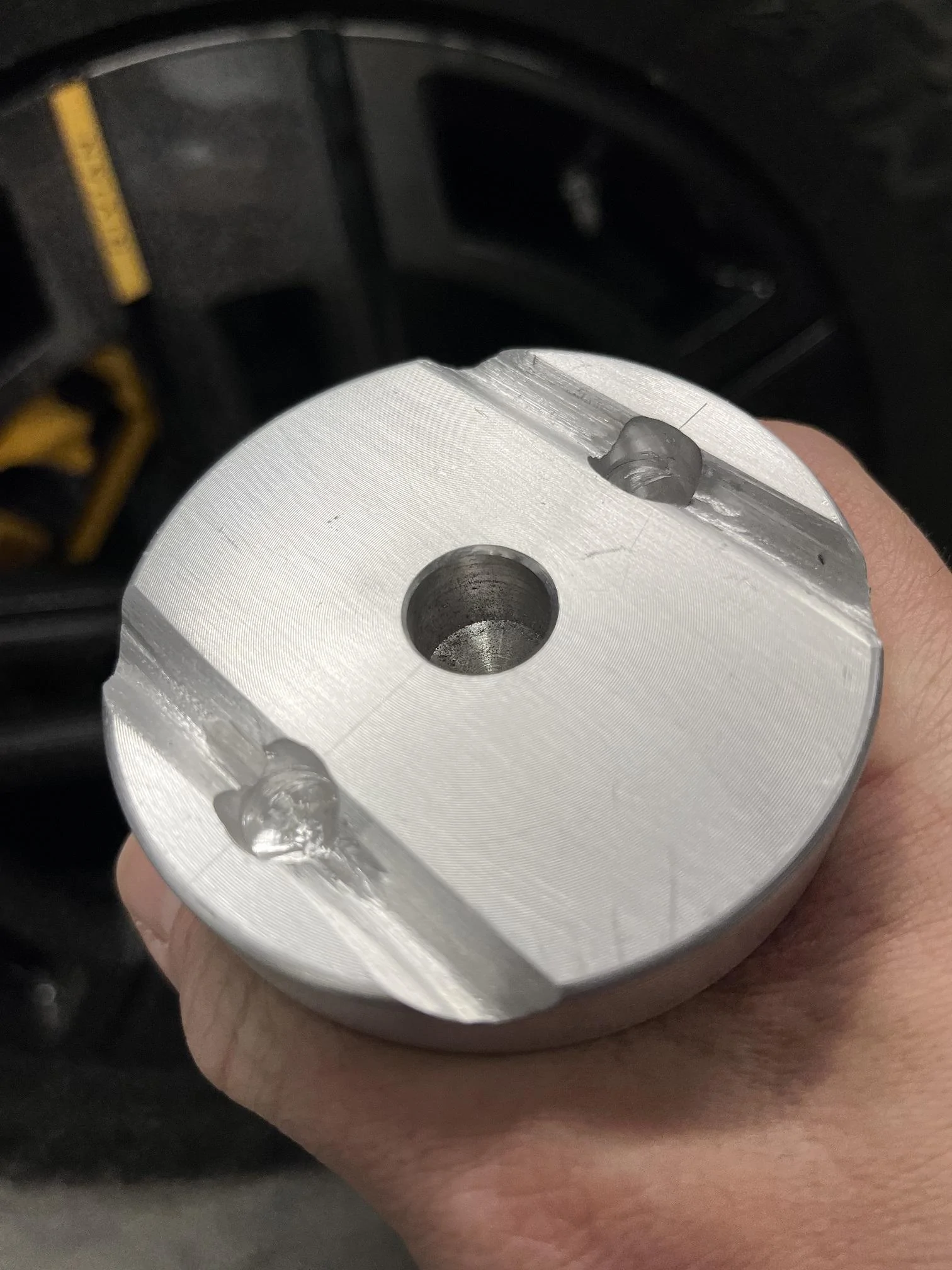

I went with this one: https://a.co/d/c6N28ZF @ $86
The puck is an EV1, modified to sit nicely on the stand. The base on these is massive and they seem pretty solid but I have not had a chance to try it yet. My next tire change will be swapping out the ATs for my 22s in a couple weeks.
Rivian R1T R1S First R1S tire rotation DIY experience jack2
Rivian R1T R1S First R1S tire rotation DIY experience jack1
EDIT:
The holes drilled in the middle of the slot really help the puck sit flat. The jack stand casting isn't perfectly flat (a bit of a peak towards the middle), but also I think it just helps to have the two contact points rather than one large point.

Great idea on making the slots in the Jack puck for stability. I have some rubber jack pads that I was going to use with this combo unit, but if they don't give me peace of mind while lifting, then I might try your solution! ??
