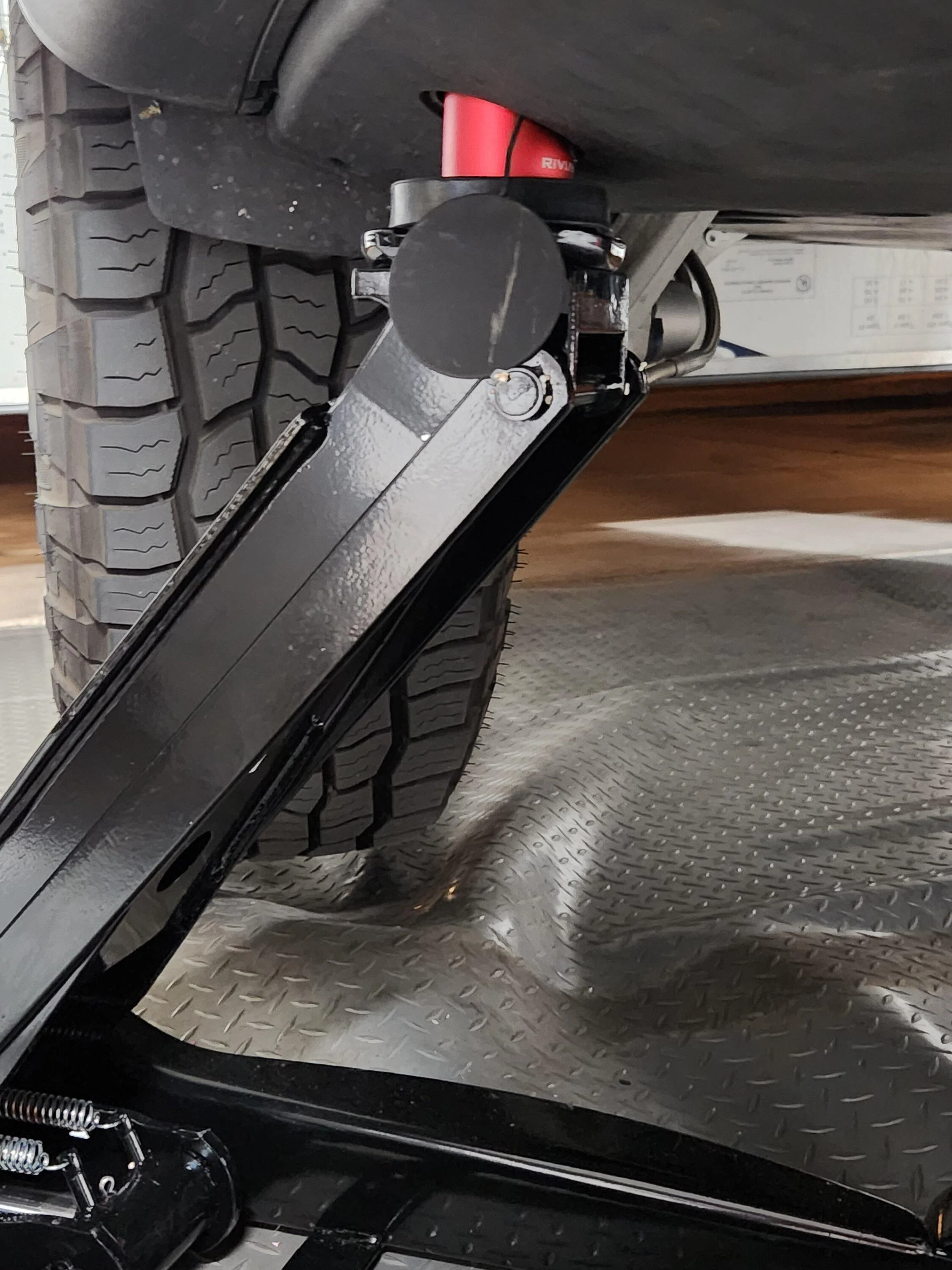

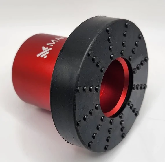

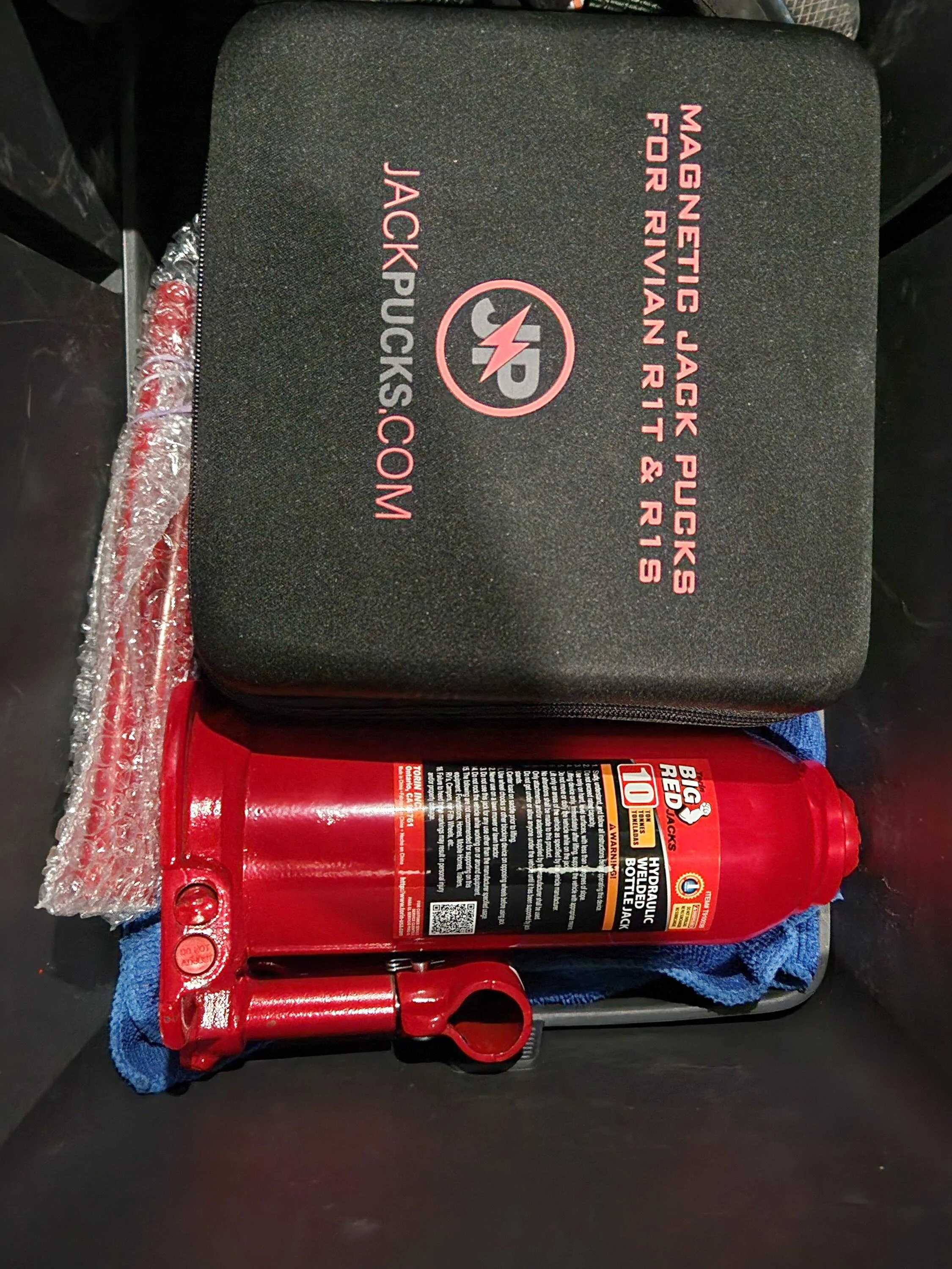

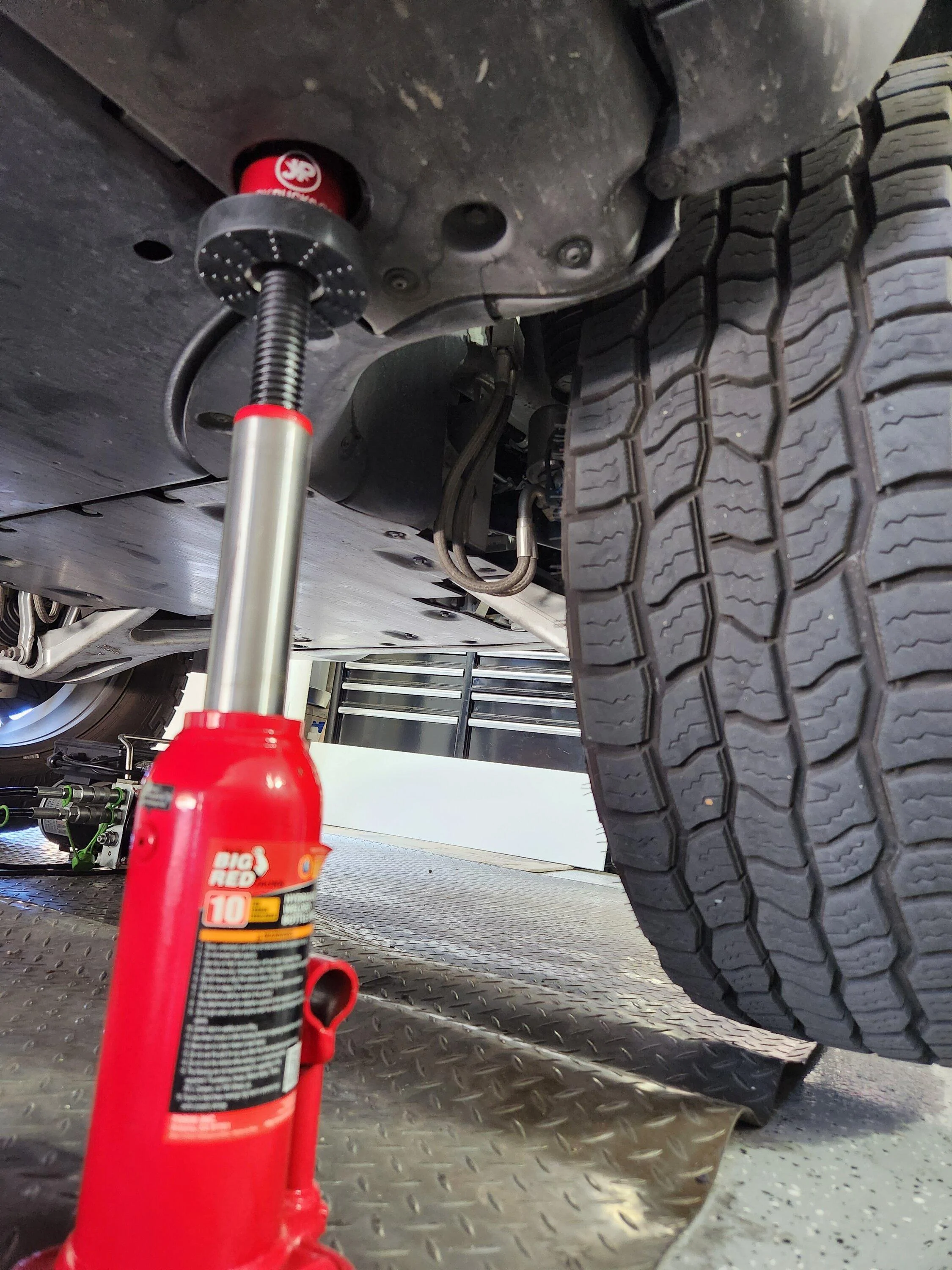

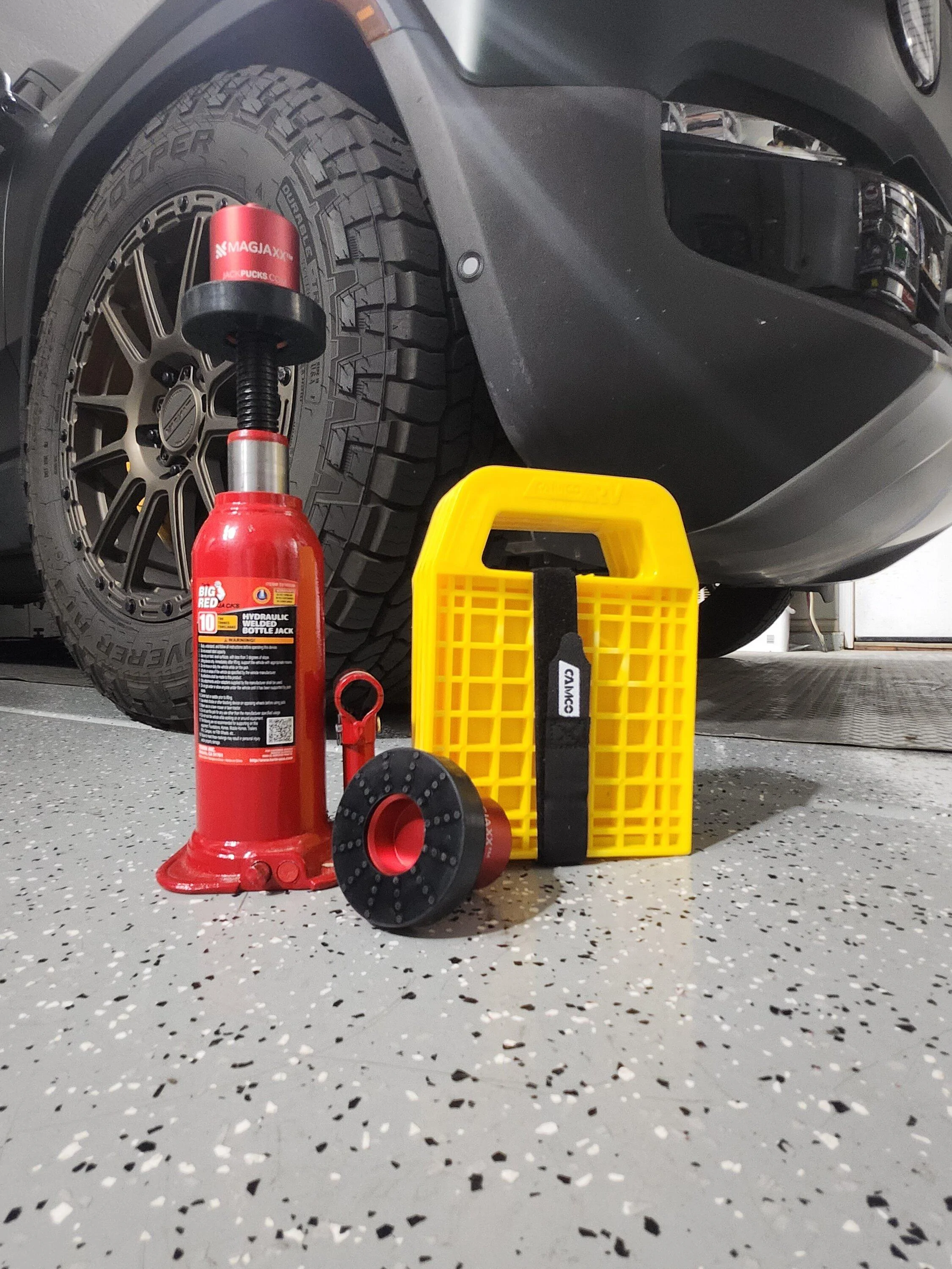

I use our magnetic jack pucks and one of two methods.
1. 10T Big Red Bottle Jack, which fits in the bottle jack port on our pucks and it is more than sufficient to get the front off the ground (pic) when in tire change mode (high position). The rear I use the Camco RV pads or a block of wood. I use the jack stands in the picture on left front and right rear lift locations.

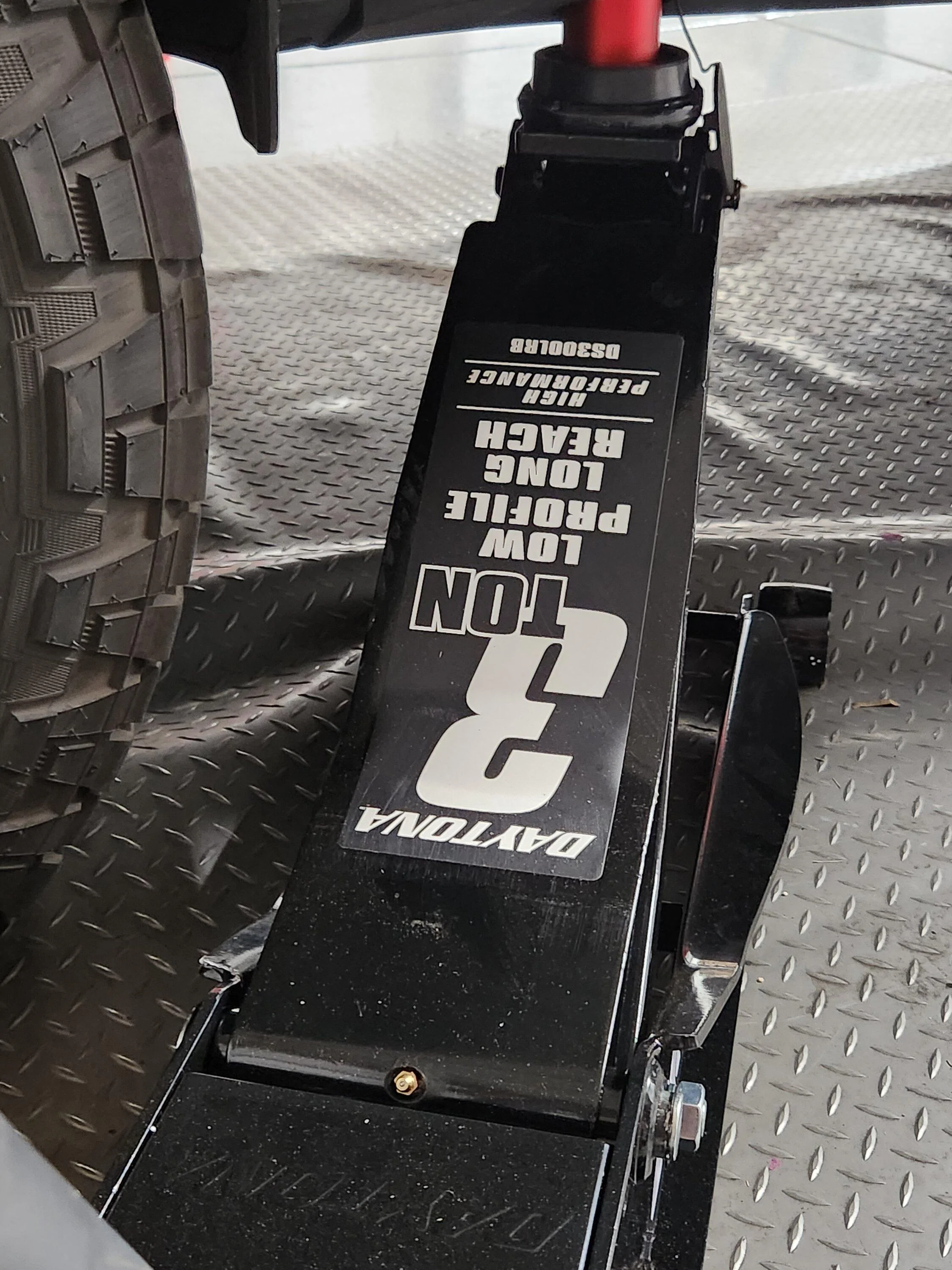

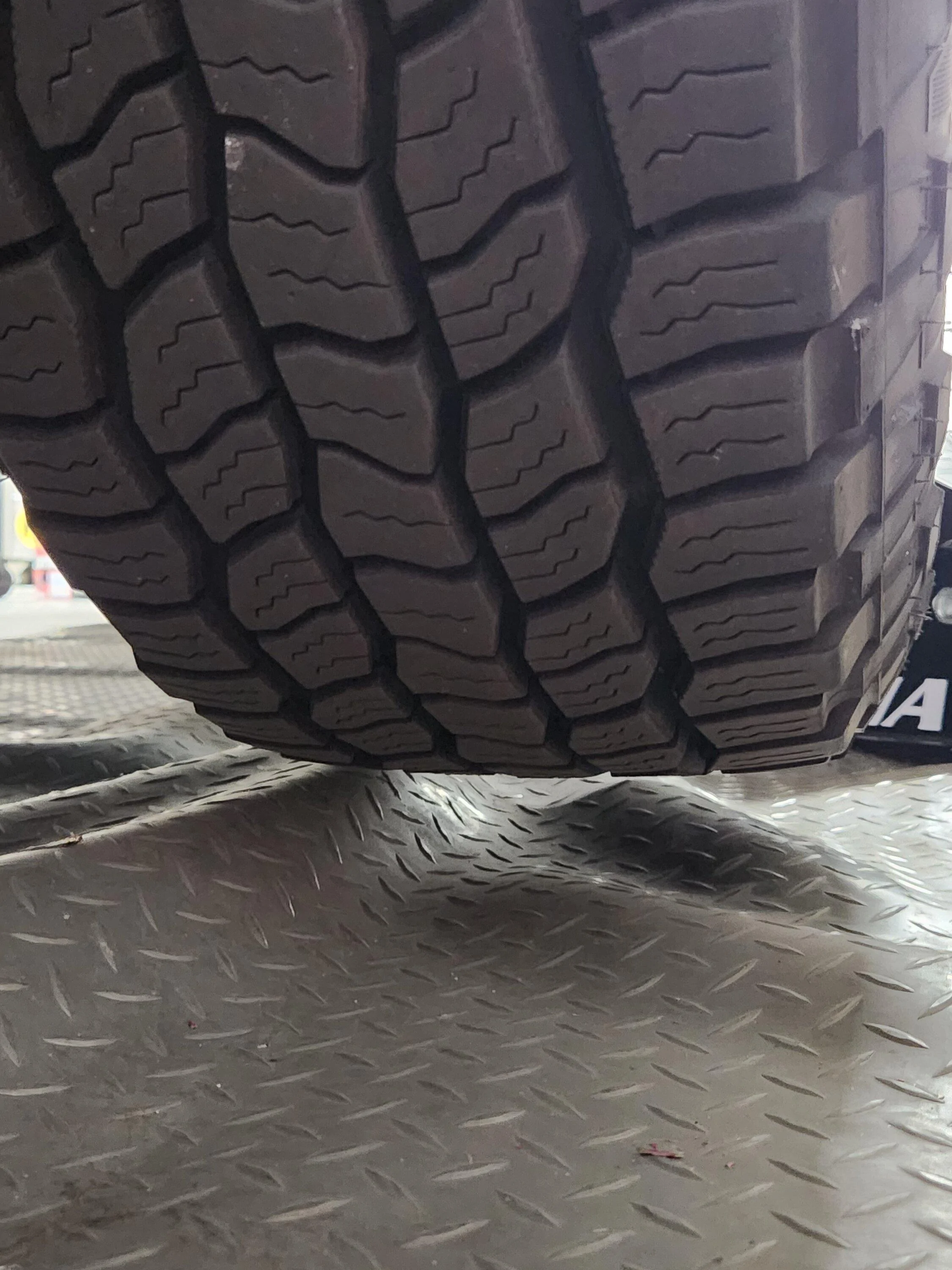

2. The HF 24 1/2" lift Dayton 3T floor jack. That thing is a beast and with our jack pucks can lift any R1 with any wheel set off the ground. I use two and then the two jack stands for support. Using the HF floor jack, as you can see in the picture the rear tire is 2.5" off the ground with another 2.5" of lift remaining on the floor jack. This is stellar.

No way in hell would I ever jack up my vehicle like that green R1S with metal jack pucks on a slippery U-shaped metal jack stand. Any tremor in the vehicle and you and it are toast.
When I would work under cars in my 20s in driveways we would have a minimum of one jack stand under each side of the axle plus a floor jack with light pressure somewhere else, like a differential or frame rail, just in case a jack stand failed catastrophically...and that was on 90s era mustangs which weight HALF as much as an R1T/R1S (3500lbs vs 7000lbs).
Safest bet is a hydraulic ram AND floor jack and do a single wheel at a time. At the very least throw the spare tire underneath next to where you are working so you won't get completely crushed.
If you are rotating your own tires it is worth it to buy a spare, allowing you to jack up just one tire at a time vs. two at a time.
I rotated my tires last weekend with the stock scissor jack which was sketchy even with a full size spare, but I wanted to familiarize myself with how good of a job it would do in a roadside emergency. Overall it gets the job done but is a suboptimal solution. On the trail I will be bringing a bottle jack and puck extension.
7,503
12,878
Might be hard to tell in the picture, the top of the Jack stands are actually hard non-slip rubber pieces. Outside of a decent size earthquake while it is sitting on those stands, it is not going anywhere.
