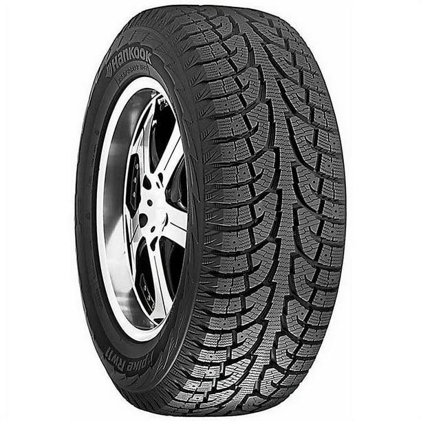

I'm going with the Hankook i*Pike LT winter tires matching OE size exactly at 275/65r20 (load index of 126/123). Will report back after I get them mounted up and tested
Rivian R1T R1S 20” Blizzak snow tires installed 8f1baed5-bd35-493a-9956-66c407f5289e.8d0fc7a535fd815b74b22a1fdd0e5cf5

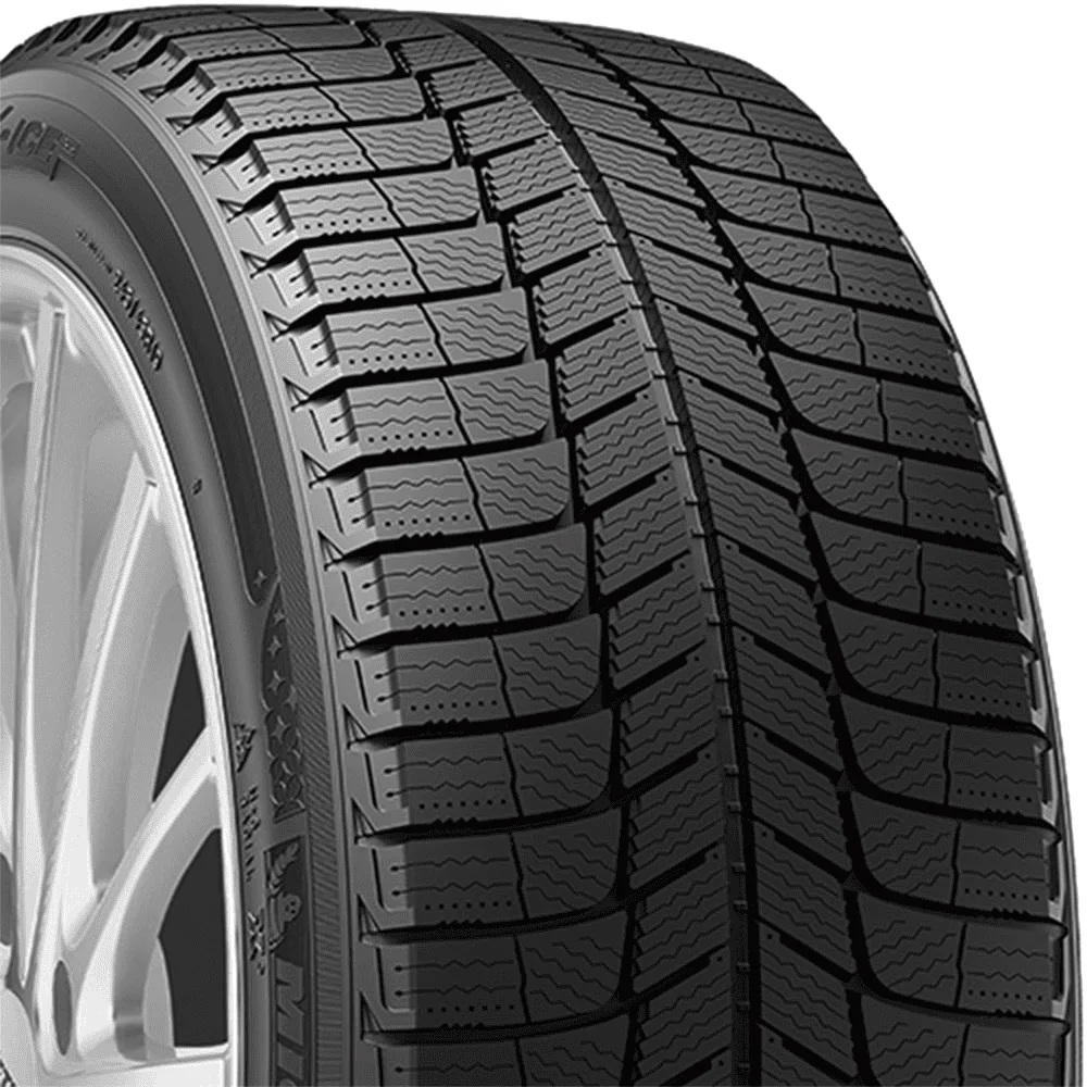

That looks very similar to the excellent Michelin X-Ice tire..
Rivian R1T R1S 20” Blizzak snow tires installed 1667860098381

PSA: I reached out to a Service Advisor at my local Service Center (2hrs away) last week who just sold me an extra set of AT wheels plus OE TPMS sensors. They even delivered them to my house at no charge while they were hitting some other appointments in the area. She was awesome, super responsive and helpful. She even got one of the techs on the phone to confirm that sensors will be auto-recognized by the truck after a couple minutes of driving (exactly like the installed sensors do). Get to know your local Service Advisor ;)
Nice, I had those on a previous vehicle and they were great also. Didn't realize they were an option in the 20" size.
X-ices have been my go-to winter tire for the last 6-7 seasons / 3 sets for best all around wear and handling in snow, wet and dry conditions....however they only make them in the 22" size for the Rivian, which I just couldn't get behind on the truck plus they're completely out of stock everywhere. Even though the 275/60r20 version is only ~3.2% smaller in diameter the Rivian tech said there is no way to re-program the truck for the smaller size, and then there's always the unknown of which other systems on the truck would get confused, and potential liability fight if there was some issue. If you don't mind having 22" rims on the truck then I'm sure it would be a very good winter option...if you can find them

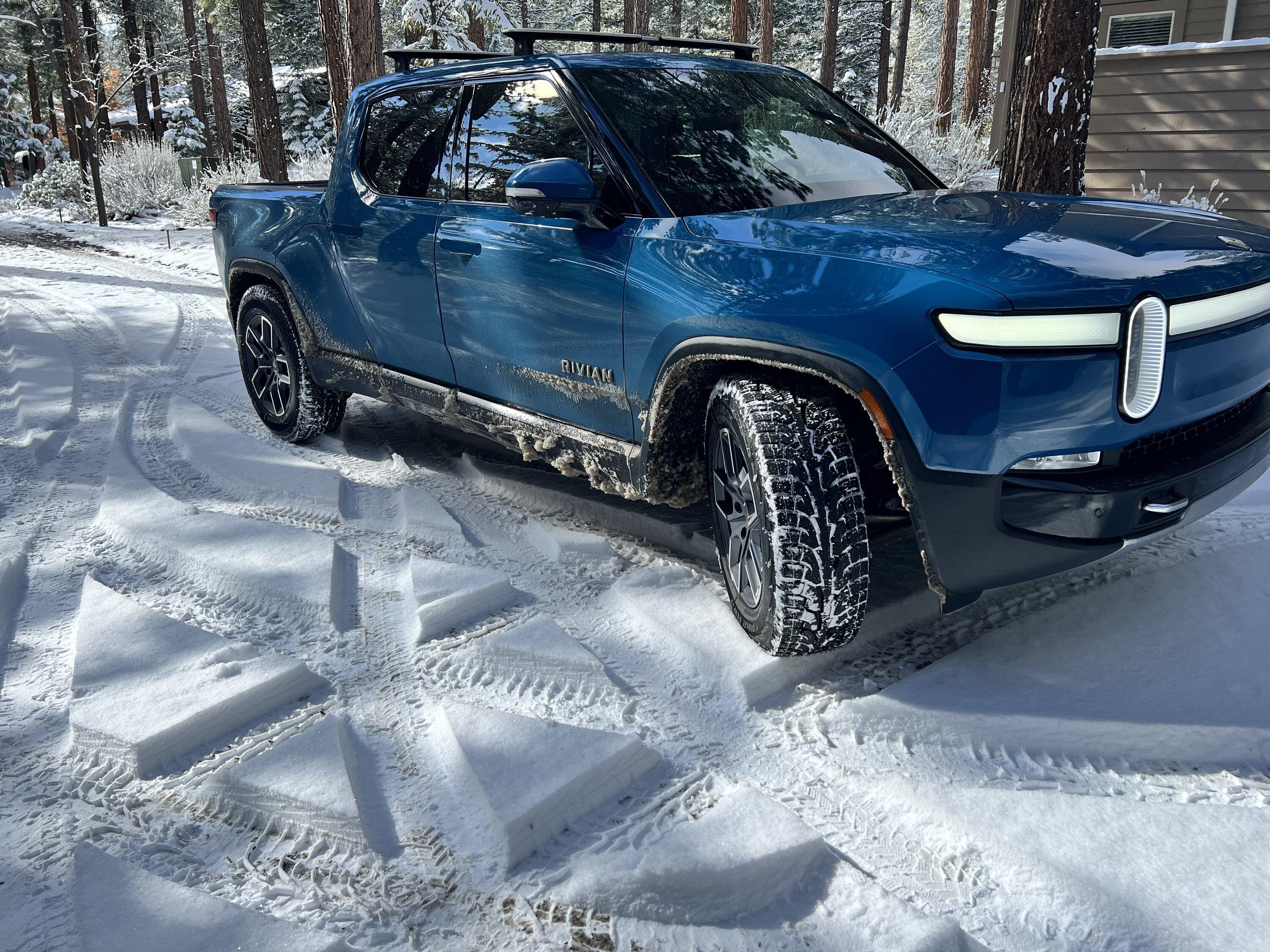

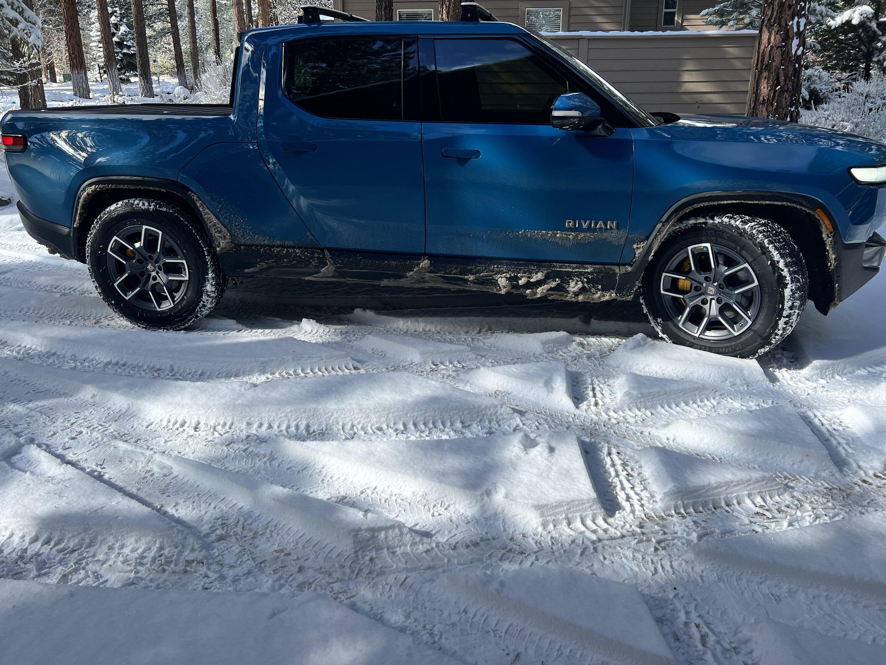

Got the Hankooks installed yesterday and fortunately the weather lined up so I’ve been able to spend a good amount of time on snow/ice and the performance Improvment is as expected: pretty hard to break them loose and when they do, they don’t wander much and want to hook back up quickly. I was on a particularly icy, fairly steep section (guessing ~10%) and going downhill faster than I should have been (~30mph) and could feel truck begin to drift and as soon as I backed off throttle slightly the tires hooked right back up. So far, pretty solid and I feel a significant improvement over the Pirellis on packed snow and ice
Rivian R1T R1S 20” Blizzak snow tires installed 1668382880064
Rivian R1T R1S 20” Blizzak snow tires installed 1668382924799
I’ve got nothing to add around dry pavement performance, ride quality, noise or efficiency as I’ve driven mostly on snow/ice so far, but from what I can tell so far they feel a lot like the OE Pirelli AT tires as far as ride quality.
Also, the 2nd set of OE TPMS sensors were recognized immediately by the truck with zero issues. The installers did have a hard time getting the bead to seat on the new rims. They had to lube the heck out of the bead and rim and inflate to 110-120psi ? to get seated. Probably due to the thickness of the tire being 10-ply / 126 load index
