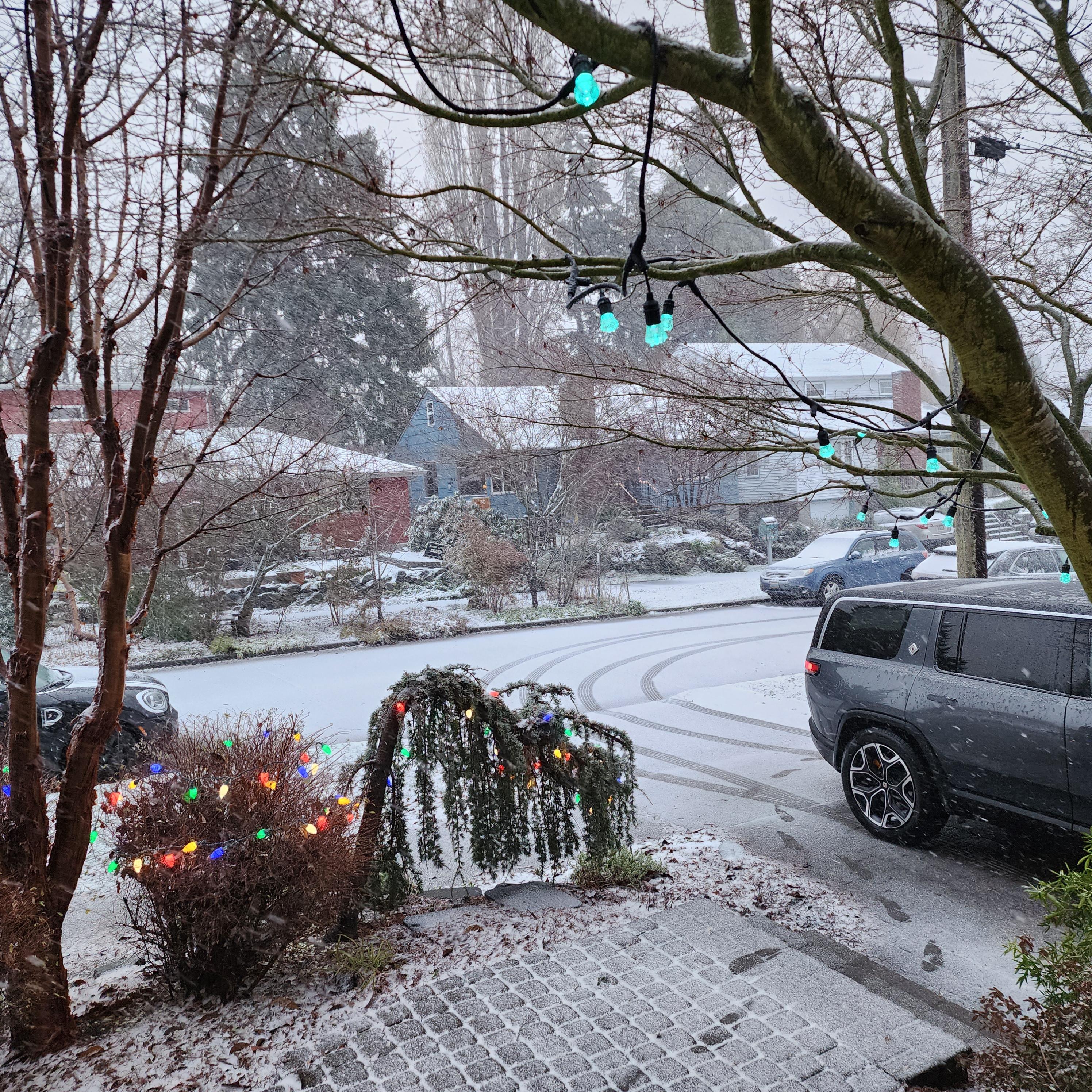

I updated my R1S last night. As it happens we have a decent amount of snow in Seattle today (unusual) Took snow mode for a spin and it's definitely a winner. Much more gradual acceleration and much less aggressive regen. Overall well executed with significantly increased control especially for a first attempt. Note my car has 22"
Rivian R1T R1S 2022.47.0 software update installed w/ SNOW MODE! 20221220_085601
