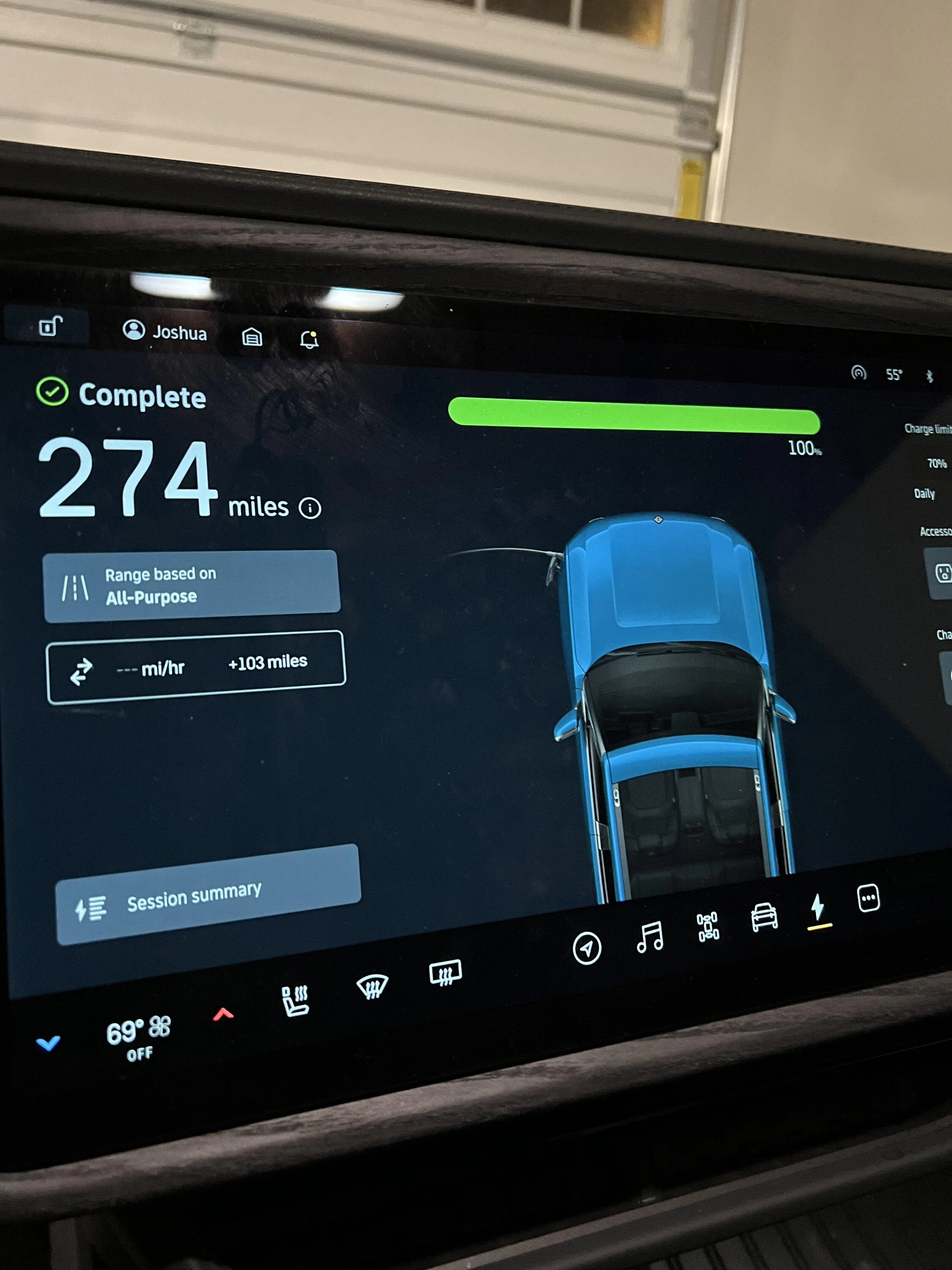

Oddly mine says 274 at 100% (20” AT) but then ~240 miles at 85% and ~200 miles at 70%. So confusing but I guess It has creeped up a bit from 270 or so it used to display at 100%.

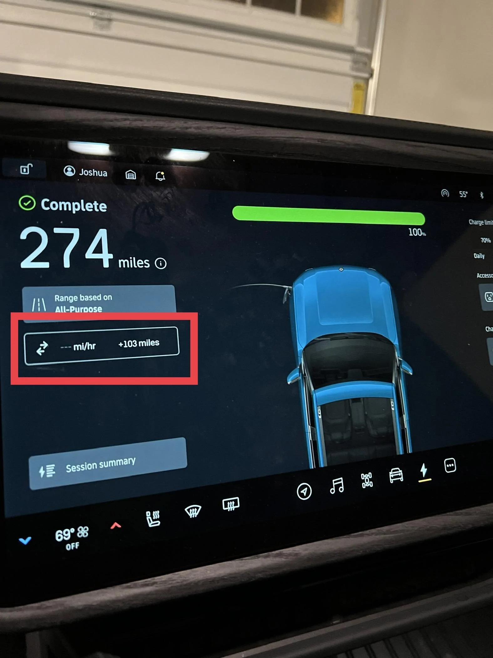

What’s this? Haven’t seen that on my truck.
Honestly, this is new to me but I will pay attention when I get back to driving and I will let you know if I can figure out what it is ?

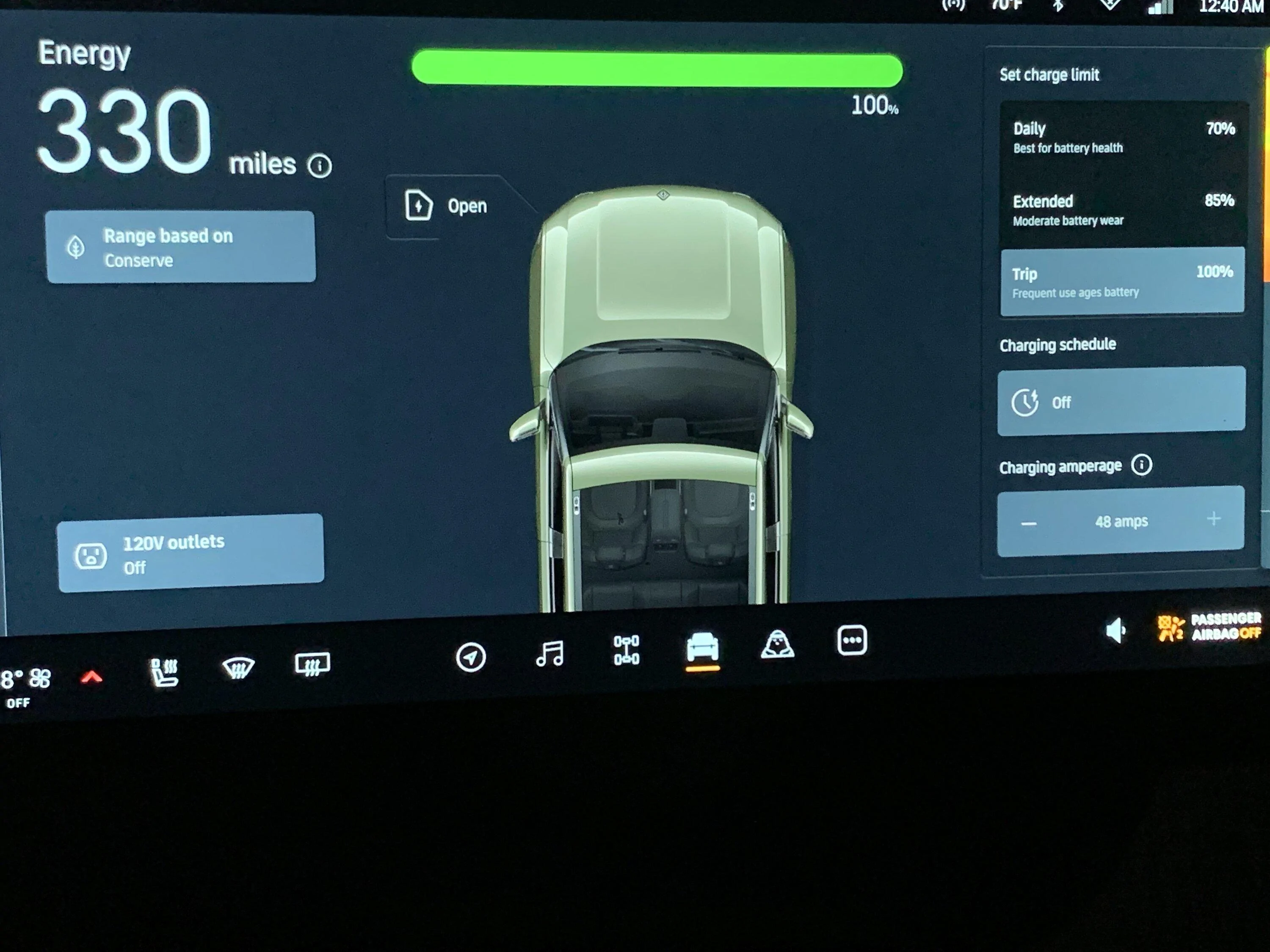

PS
Mine says 330 miles/100% on conserve mode. Your mileage 270/100% is in all purpose mode.
