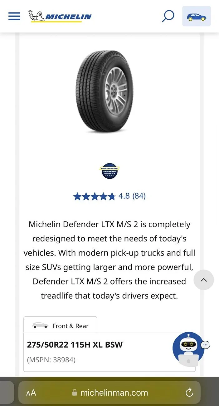

Did you install the 115 or 119?

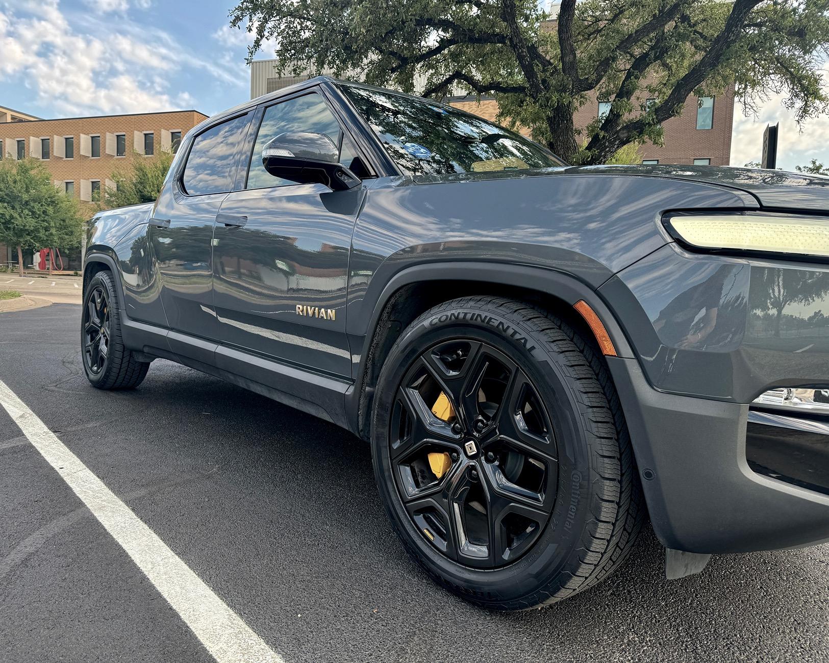

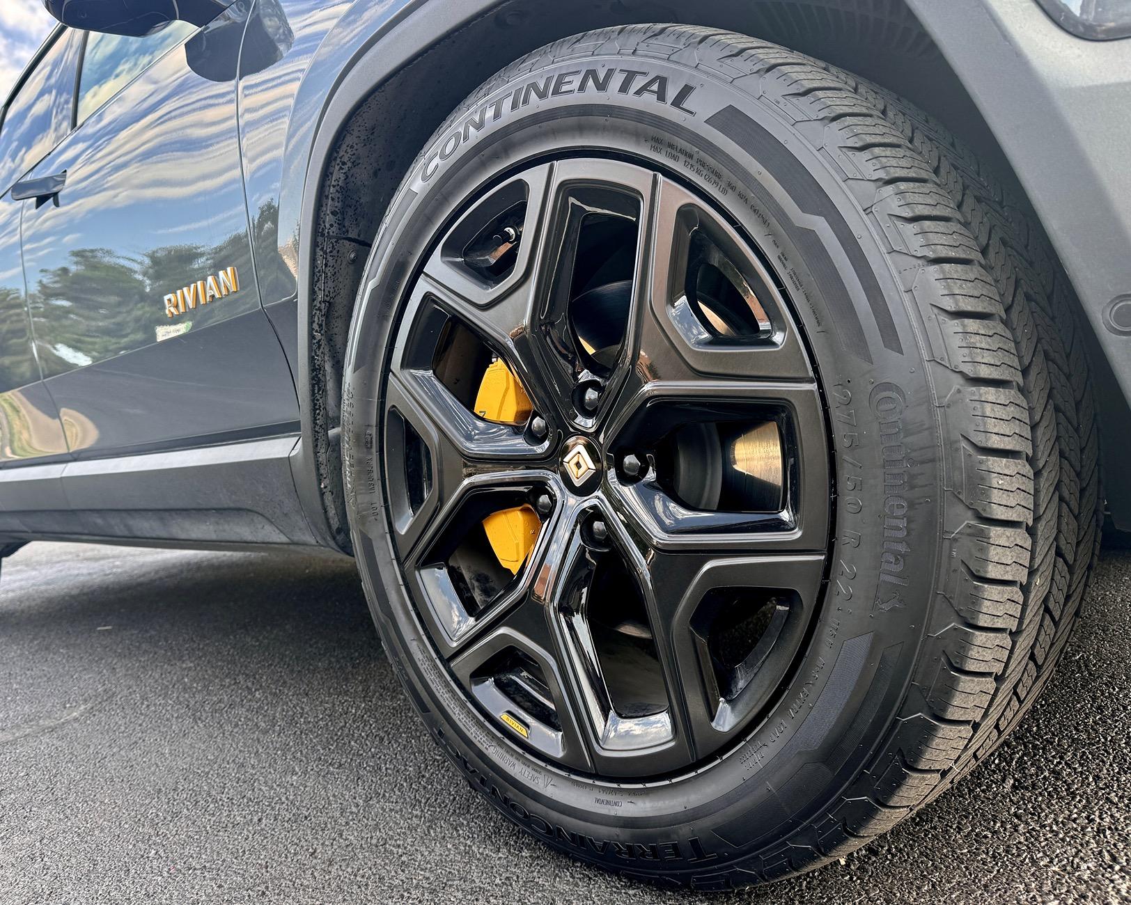

I just swapped out for the Continental Terrain Contact H/T yesterday. It might just be that new tire feel, but so far I am liking them much more than the Pirellis. I feel like I got a fairly decent price on them and Discount Tire did a great job swapping them out.
I reset a trip meter after getting them installed in hopes that I can get some fairly accurate efficiency information over time. Not much to speak of so far as I've only got about 20 miles on the new tires.
It’s been a while since you’ve had them on. How do you like them? Did TireRack advised you that the rating is lower on these tires?
