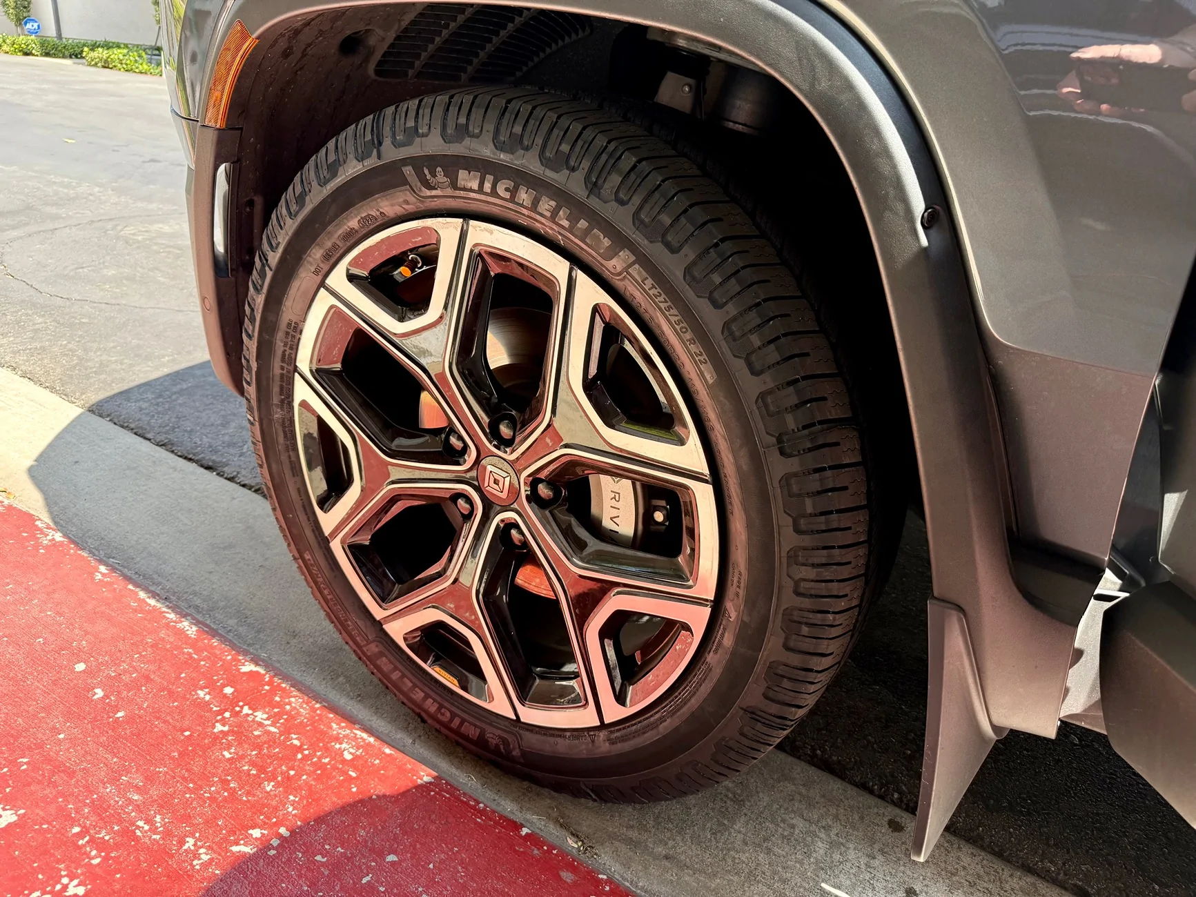

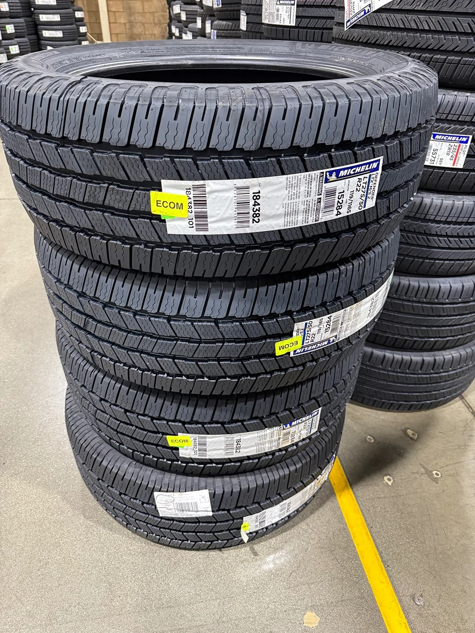

Costco is installing these for me right now as I go grab some dim sum lunch.

Surprised many of you are going with 119s.

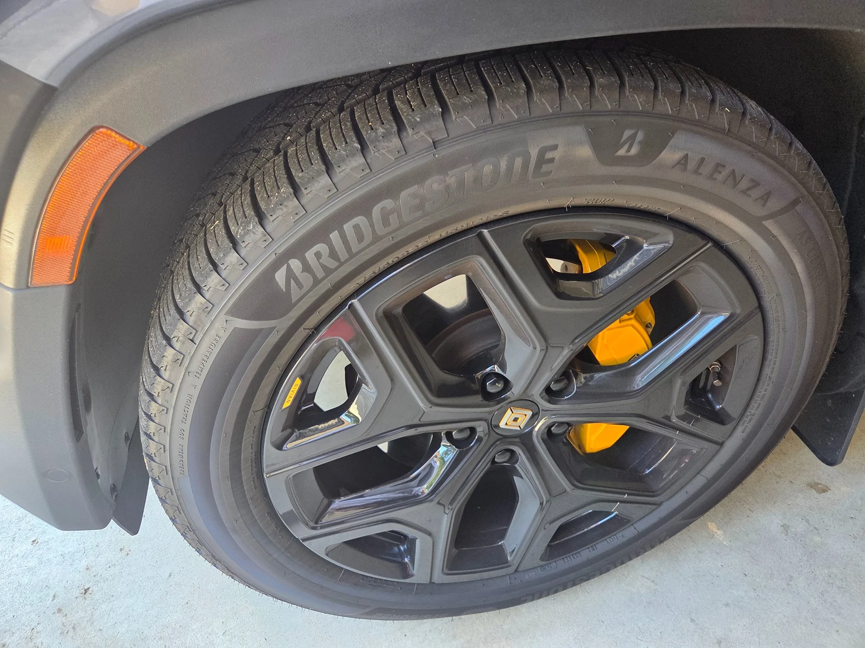

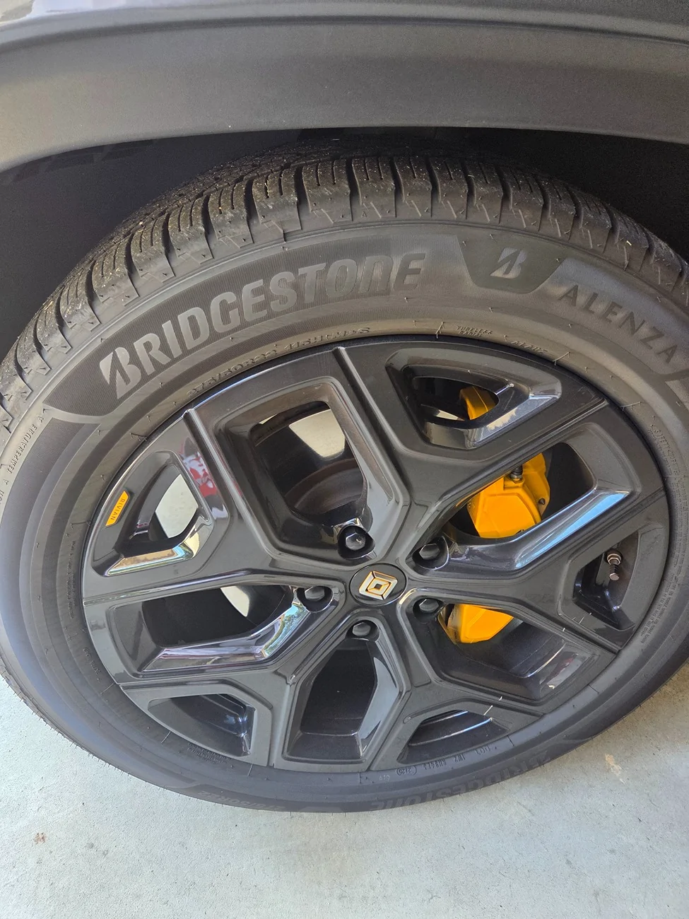

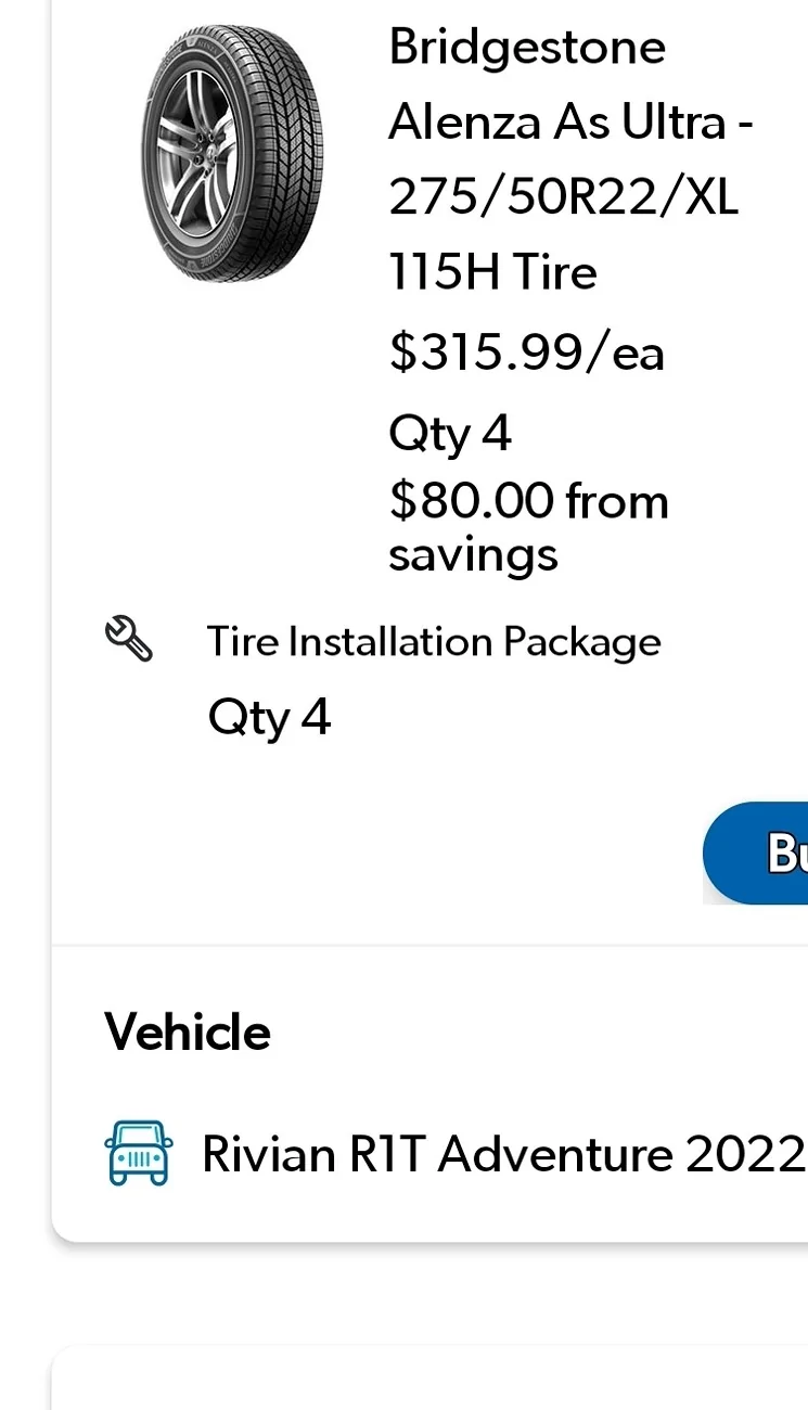

I forgot to post that bought these bridgestones back in June from Sam's club. I like them. The ride is smooth. I have put about 2,500 miles on them. My oem Pirellis were bald on the inside from riding the suspension in low. I don't do that anyway.

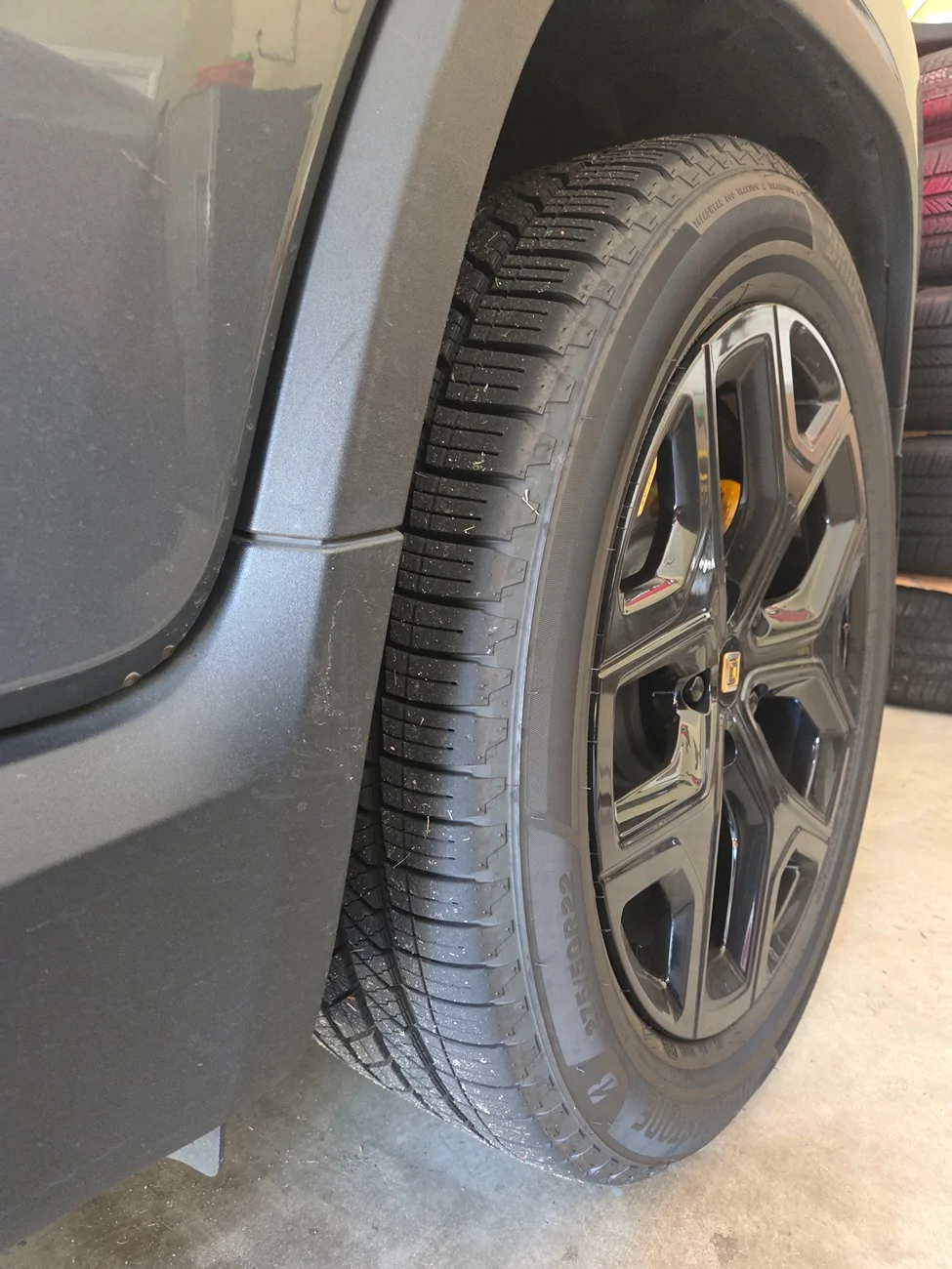

I had about 21k of the oem tires.
While the 115H is probably fine (it misses the total load rating with the 15% correction factor for P metric tires) many places will not install a tire with a lower rating than the factory. Because of this I went with the 119 tires as I don’t have enough weekends to get this done when factoring in travel and work.
