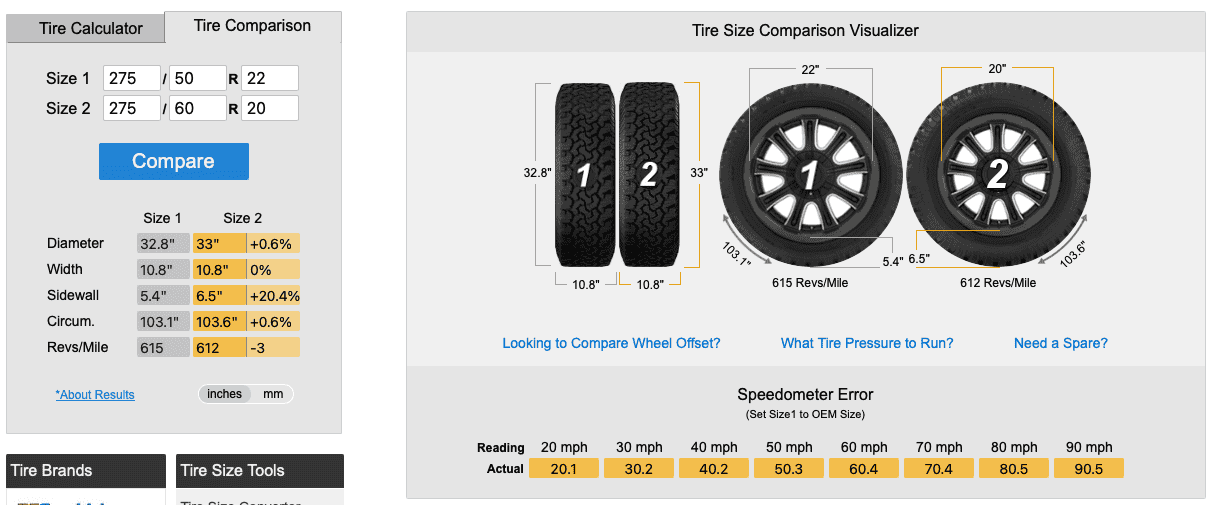

If you want a set of 20" for AT, then go with 275/60/20 AT. The OD is the same as the 22". There are plenty of AT choices for this size. This way, you don't have to worry about the speedo being off or needing to recalibrate at Rivian SC.
Rivian R1T R1S 22's vs. 20's - In depth discussion. 1700870869073
And for tire selection
