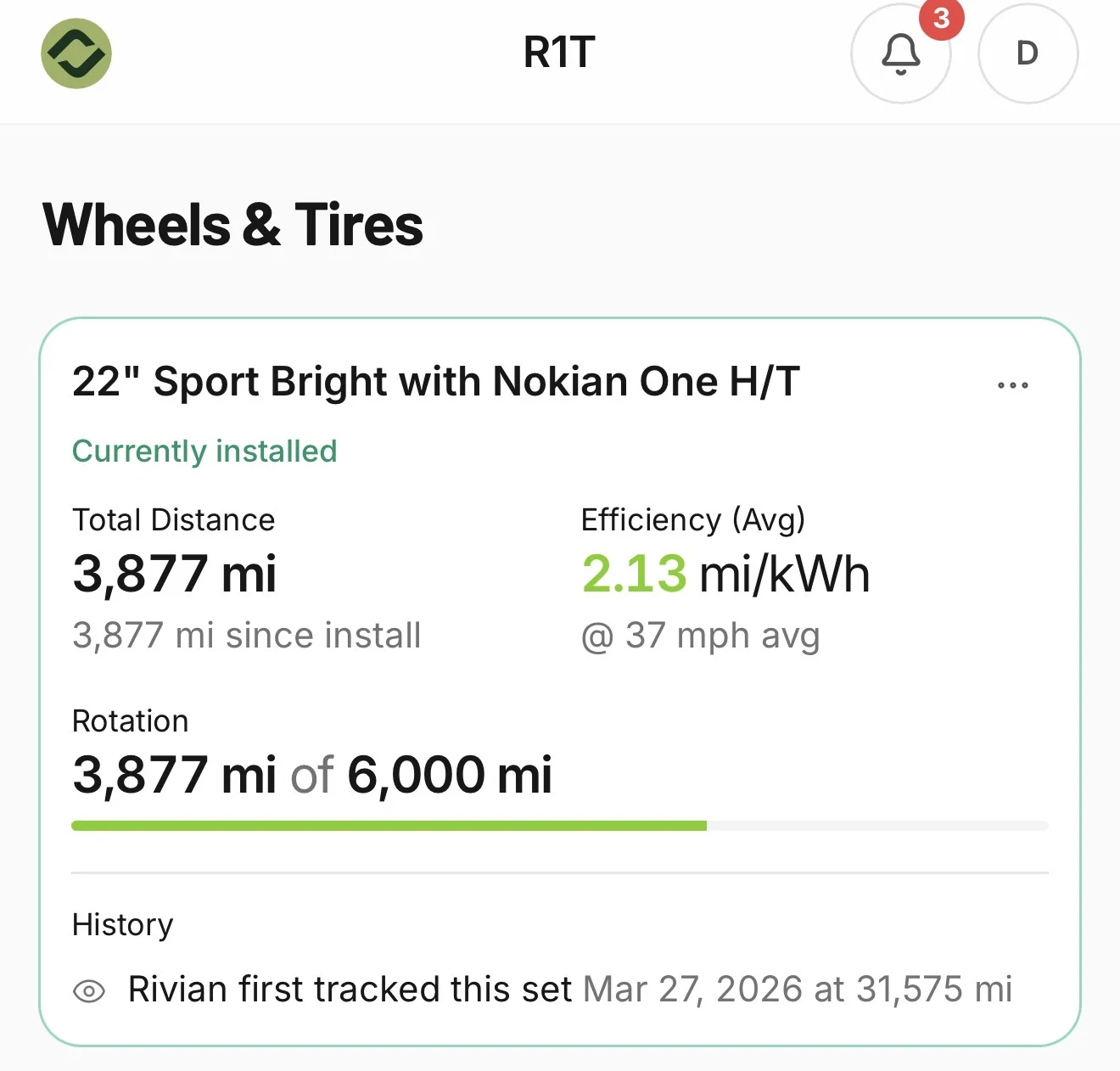

I’m on 22’s but I’ve seen 2.13 over almost 4,000 miles. It’s a slight improvement over the factory Pirelli’s scorpions I came from.

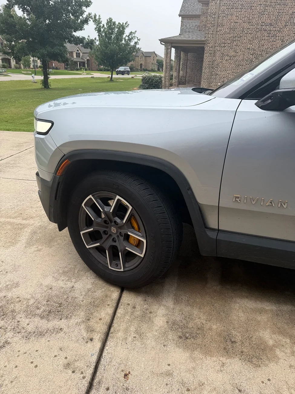

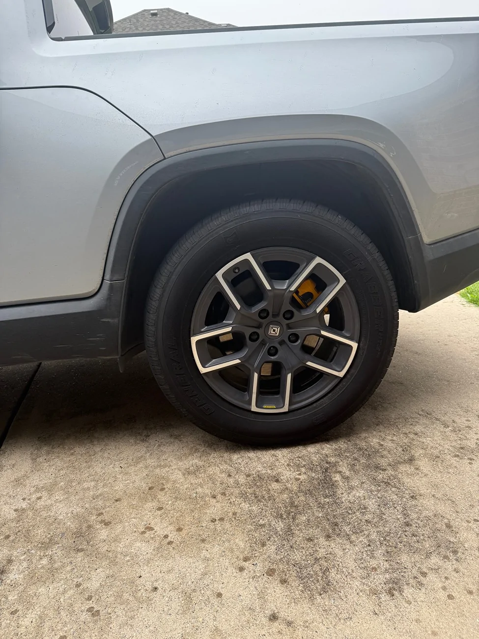

I need tire’s for my 20’s. Prioritizing efficiency. The General Grabber HTS 60 is tops on Rivian Tracker (https://riviantrackr.com/rivian-tire-guide/?size=275/60R20&sort=efficiencyGrade) and here (https://www.rivianforums.com/forum/...-wheels-and-33-tires-options-275-60r20.24561/) but everyone seems to be going with Wranglers or Hankook. What am I missing? They're super cheap too. Tread wear may be a knock but you’ll get prorated on the mileage warranty if you rotate.
Anyone with grabbers care to share their input? How about pics?

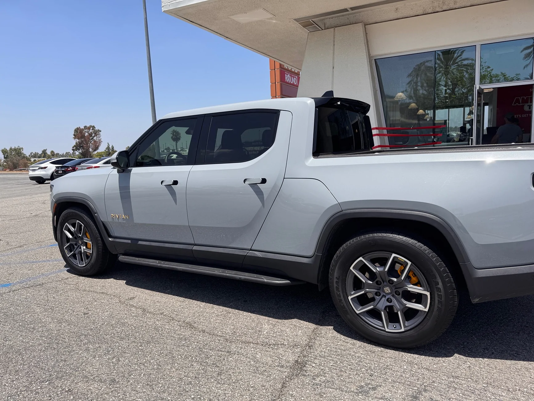

Just grabbed some new HTS60’s (275/60/20 116). First impressions is they are dead quiet and much nicer riding than the stock AT Pirellis. They look…fine. Not as cool as the AT’s but that’s the trade off. $922 out the door. Can’t be that.
