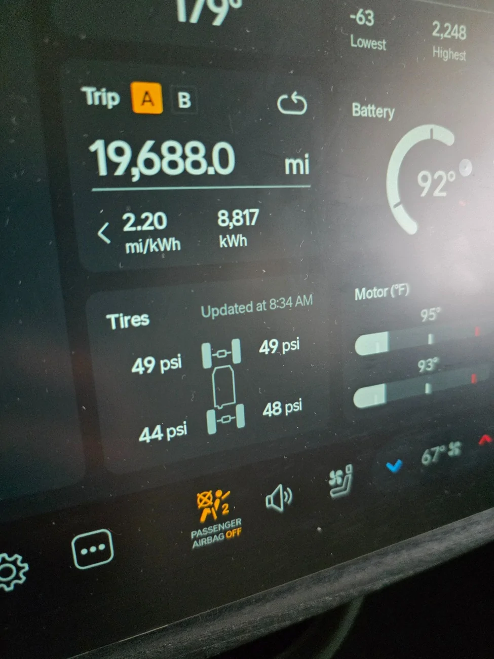

I noticed a low tire pressure and the location of the tire is in the front passenger side. The one on screen shows rear driver side .
How can I correct this? I have rotated the tires 2x already by rivian service.
I was able to double check tire pressure manually because I have a manual guage.
Rivian R1T R1S Tire pressure TPM location on screen not accurate. 20260713_130851

I don't believe there is a manual reset. Each valve transmits a signal to the TPMS. The TPMS determines location by signal strength and possibly other factors. Every time you drive this process is repeated. This is also why you have to drive a little to get a correct pressure reading.
