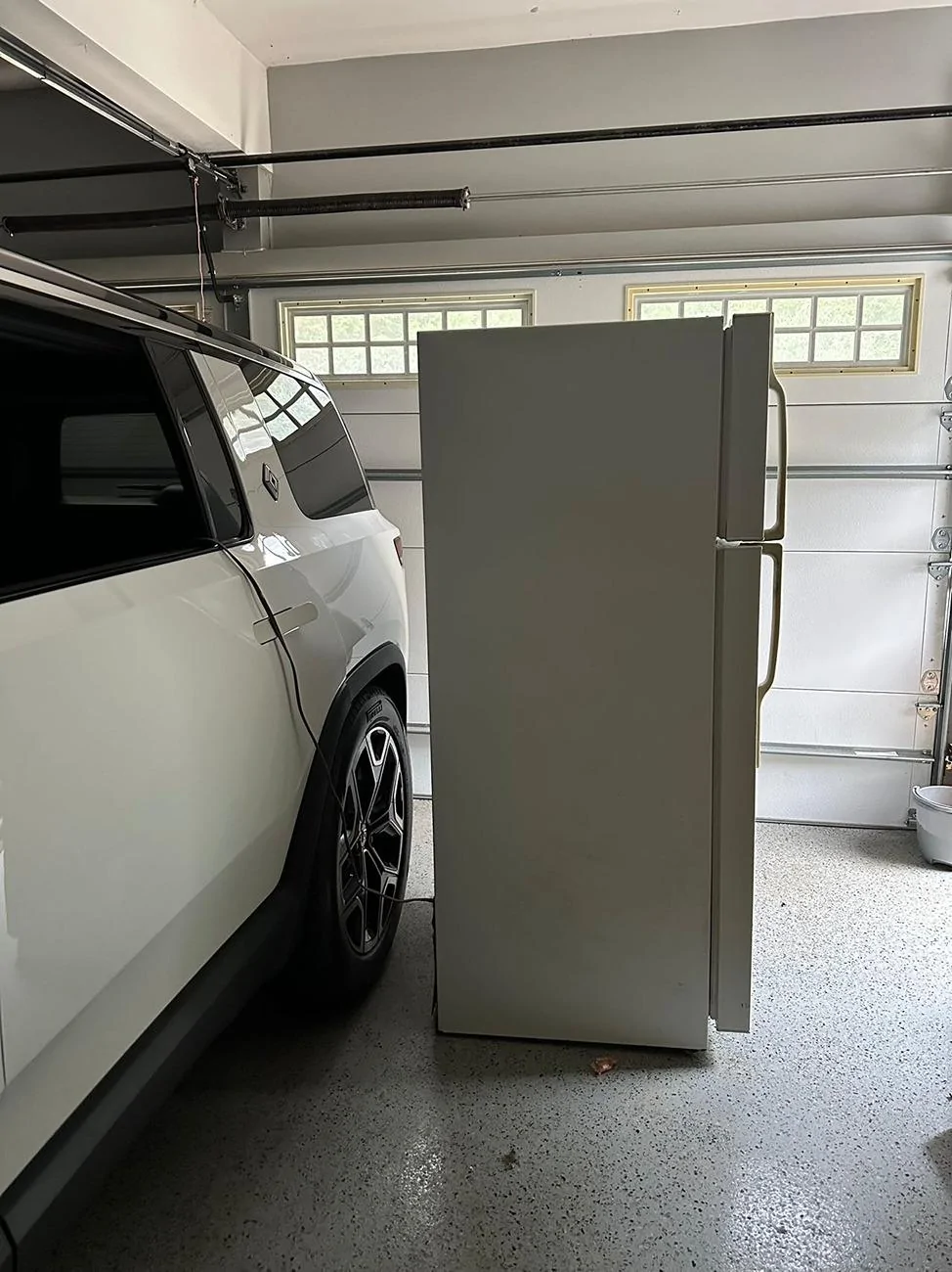

I purchased my R1S 3 weeks ago and left it in my garage with 80% charge. When the hurricane came up through Florida and then hit us in North Carolina we lost the ability to travel and electric. We were able to move the refrigerator in the garage close to the Rivian and in ran fine from the 110v outlet. We are also able to charge small battery power supplies. It has been a life saver.

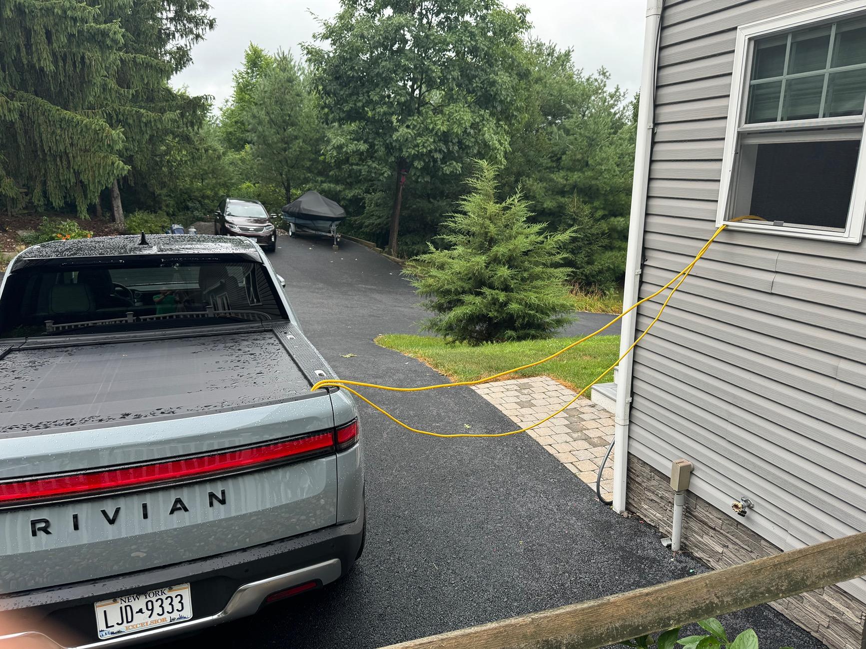

Did the same thing over the summer when we lost power for 3 days. Powered my fridge, freezer, wifi/modem and some lights and barely used any power (like 25% if I can remember).
