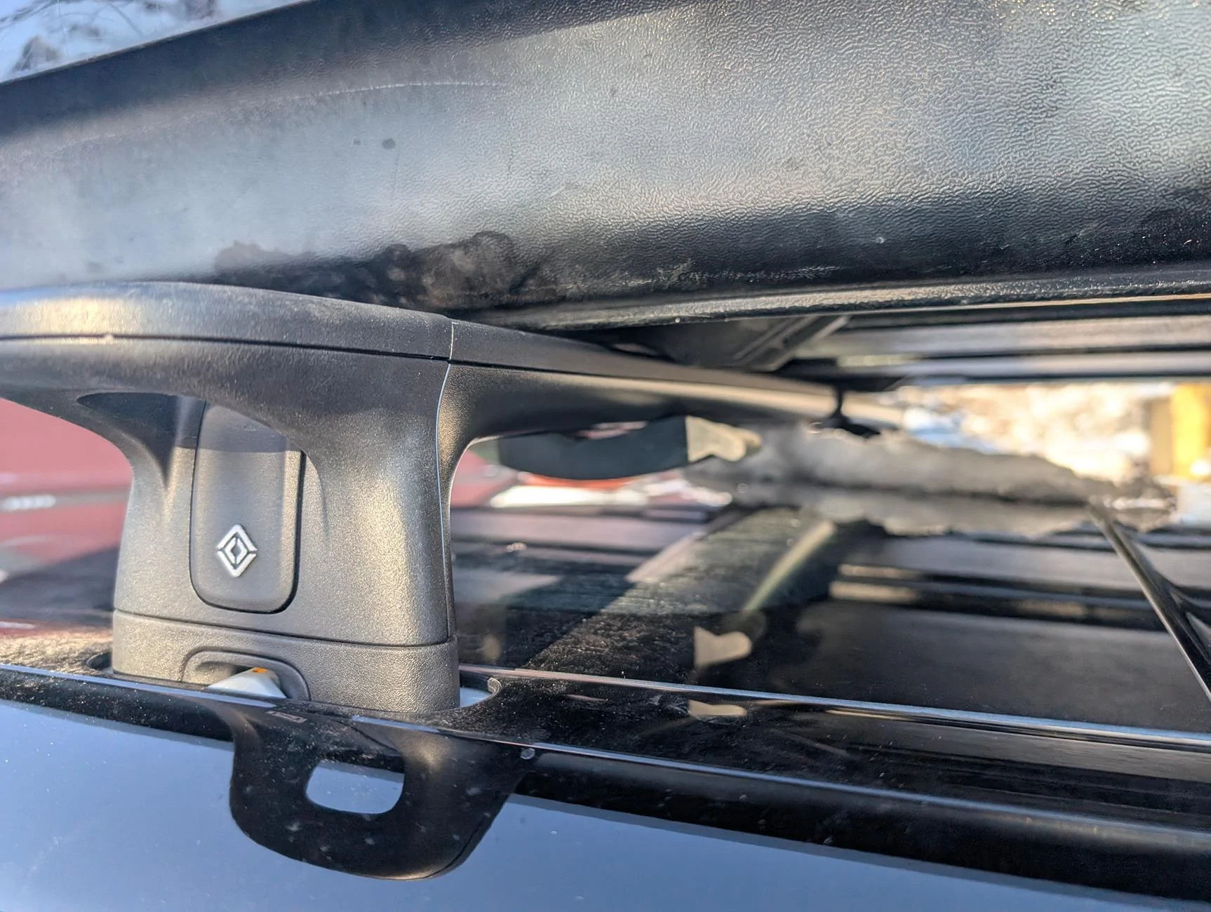

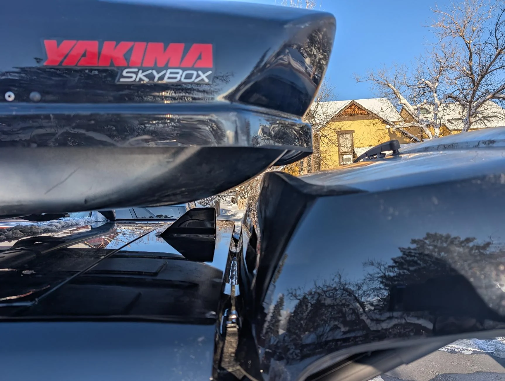

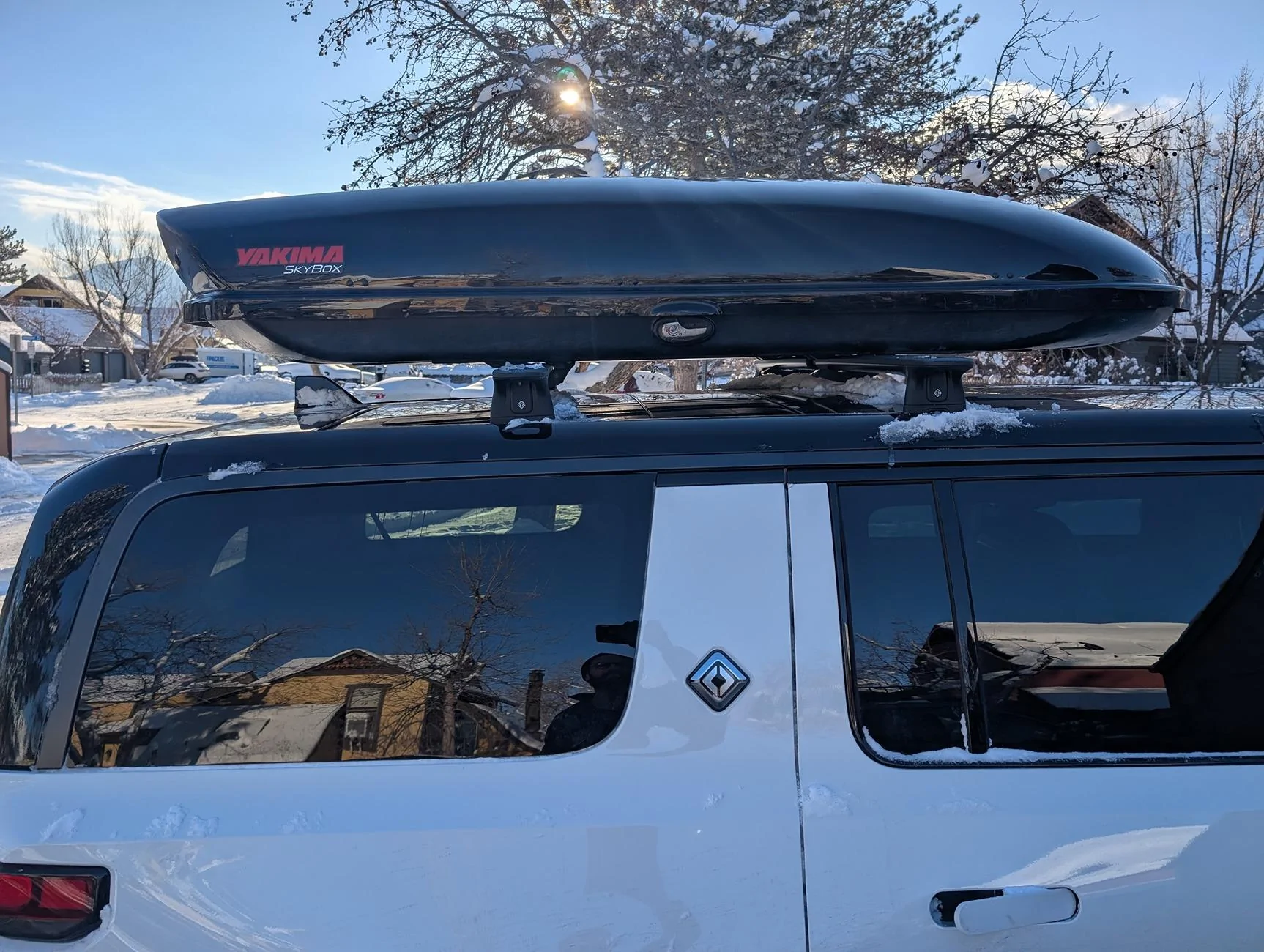

I did the same with my Yakima Skybox 21 on an R1S. Great call on the half inch longer bolts... while I think the standard ones world technically fit after you get it sized, it would be at the end of the thread which is sketchy. Only nuisance was I couldn't get galvanized bolts to thread and had to switch to stainless.
Note for anyone doing this with any Yakima roof box: the clamps don't entirely encircle the Rivian crossbars, but when clamped they are totally solid, definitely not going to budge. Yakima says as long as it's clamped hard you're good, and I have gone through the whole ski season so far without anything shifting.

As an update, I did actually experience some shifting in really high winds. Not when driving but when parked overnight. It was a little unsettling to discover, but it still felt solidly clamped, and I didn't have any issues subsequently driving 80mph on the highway for five hours. ?‍♂
