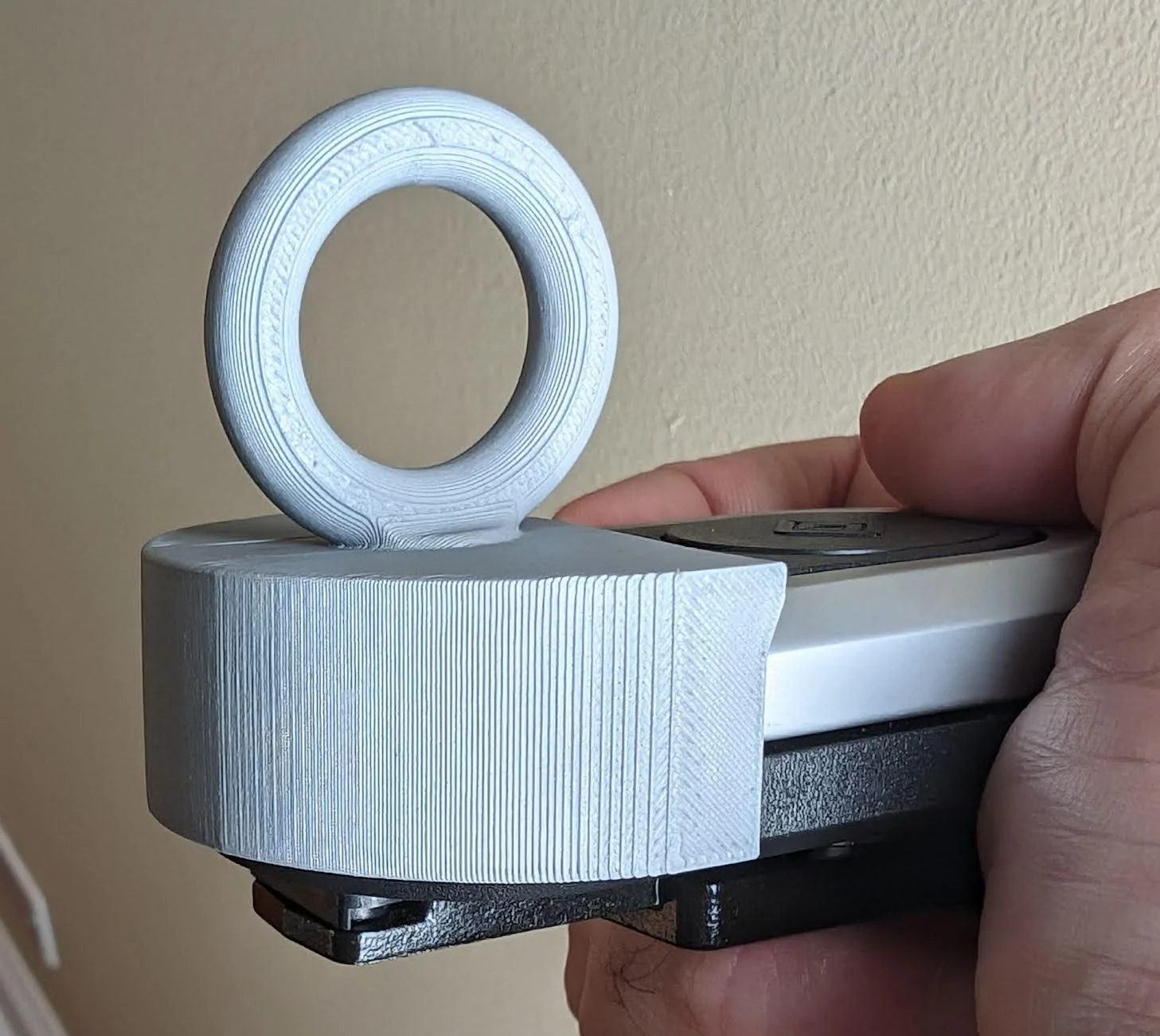

Thanks. Yes, I can import STLs and modify/remix.
Was already kind of thinking about your first one, with a print-in-place adjustment where it has a swivel for the hook. Maybe a mashup of yours with this one: https://www.thingiverse.com/thing:6193940
Just not sure if the swivel provides enough benefit until I print yours and try it out with an as-yet-not-purchased cargo net.
Yeah you might not need to, I find that these are easy enough to rotate in place (partially why I ditched the shroud once I had a cargo net to test with and rethink/simplify things) so as long as I was careful with where the support material ended up I had enough rotation with still good locking interaction without having to worry about it. But I could definitely see a use for a locked in peg orientation with an embedded swivel for certain accessories.
Either way, enjoy, change it up as needed and let me know what you end up doing with it. Also if you need something modeled up or 3D scanned (inside the vehicle) I can give it a go

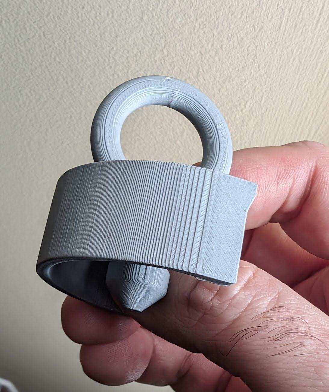

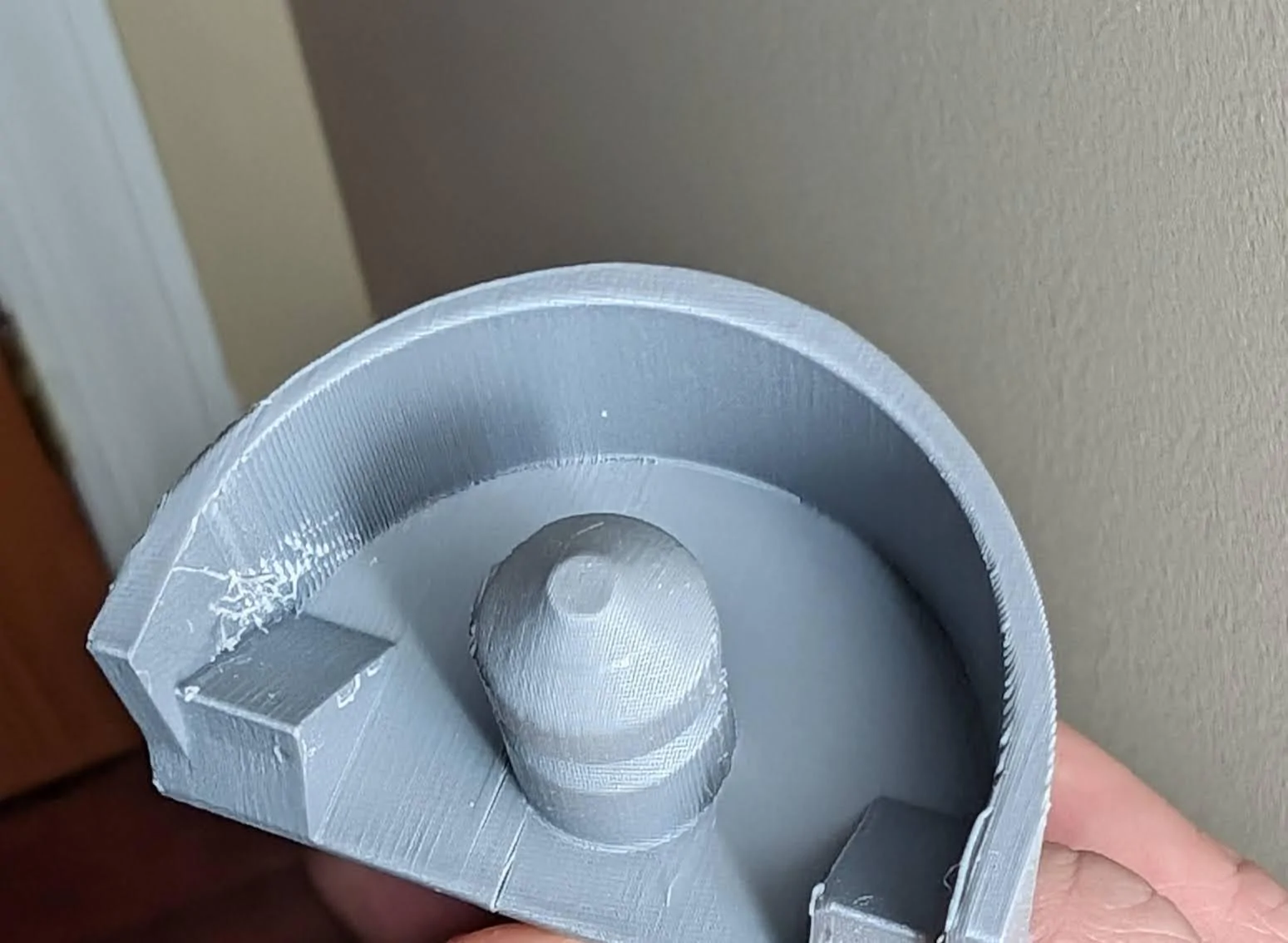

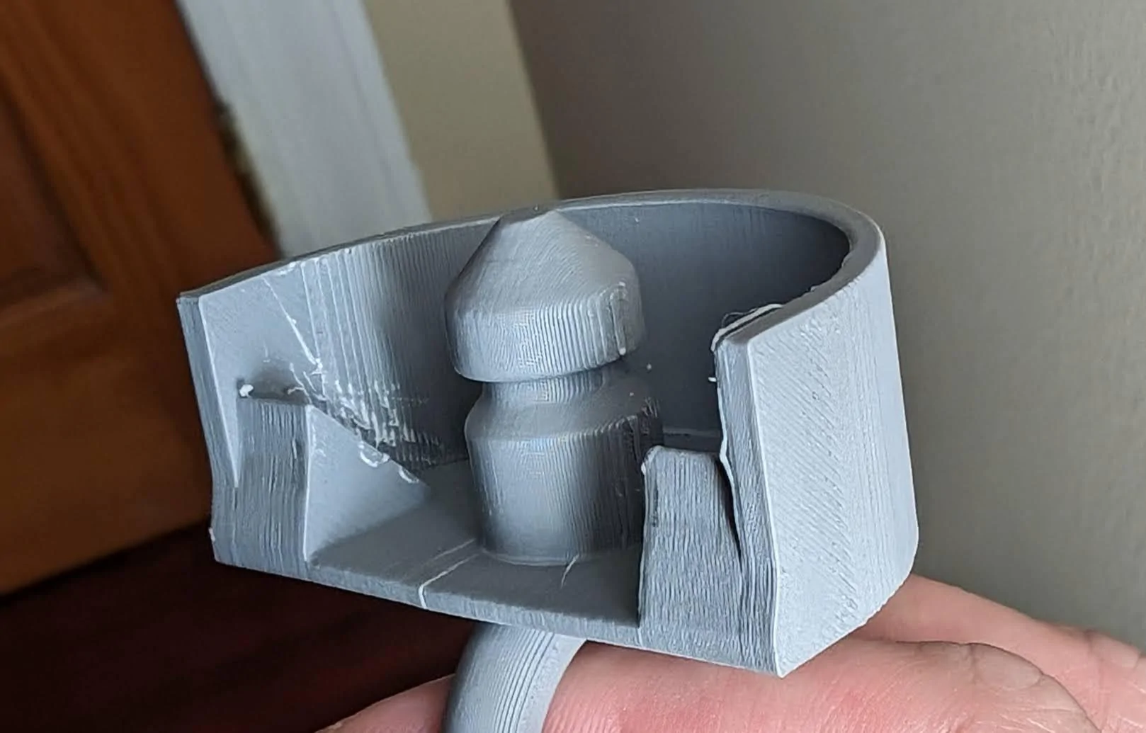

And a quick test print (didn't even fully clear the support material :D) of a fully locking part...
Locks perfectly in! Print orientation will be important as I was a little overzealous in testing twist resistance and started to split a print layer seam apart :D plus there's a lot of refinement yet to be done, but this was a great little experiment and I'll post the final results when I get the "surprise" cargo net at Xmas and can dial everything in.

What type of filament are you using? I'm guessing PETG or ABS? I'm curious about how it holds up under stress - any delamination or RUD (Rapid Unexepected Disassembly) issues so far?
Right now it's just PLA, I'm kinda just seeing how well it holds up, but I expect to have to print these again in something else at some point. PETG, or PC maybe - but willing to see how long PLA holds up.
So far, no issues. Net has been used a bit and when it's "idle" there's a bit of tension on the hooks but not a ton. Everything is good so far - I used a lot of infill and 2 extra walls just to beef them up a little bit
