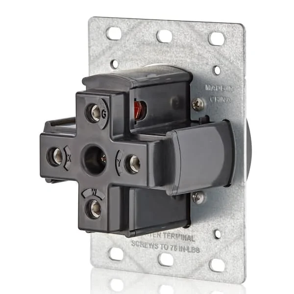

True, but there is a reason Hubble is the most highly recommended option. Plus, Hubble is made in the USA, while Leviton is made in China.

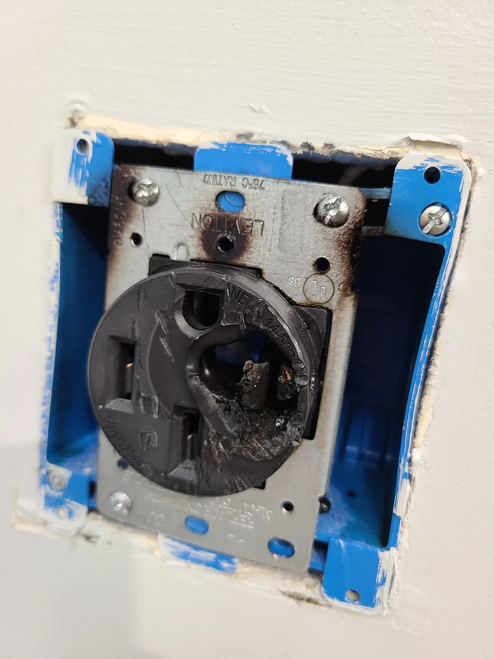

The temperature rating isn't nearly as important as the terminal quality. This one was rated for 75C.
Rivian R1T R1S 3rd party wall chargers ok or not? 20220302_211915

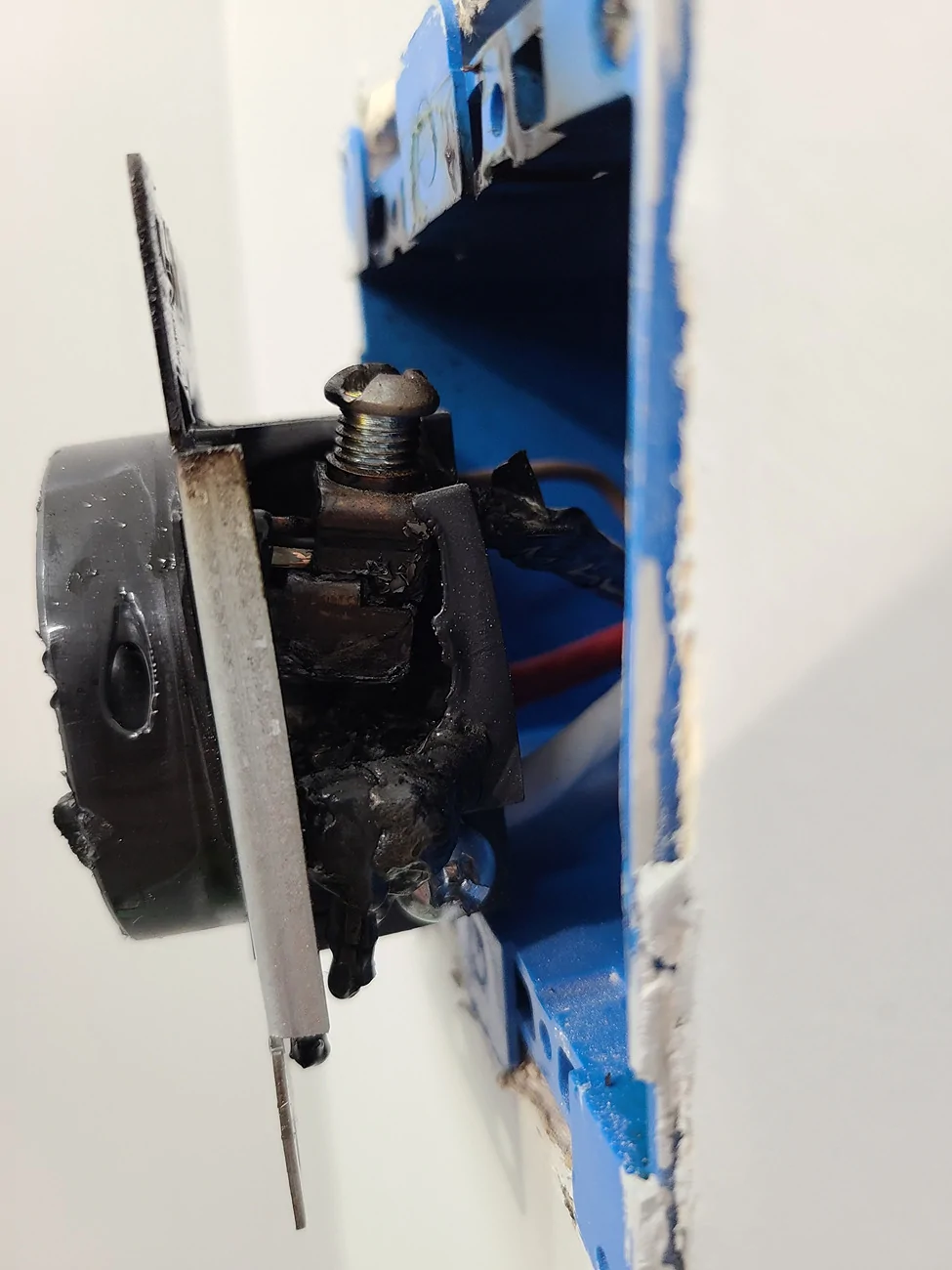

It used standard Phillips screws which limited how much torque you could put on them without the driver camming out. I leaned on them and tightened them down as hard as I could, but they still heat cycled themselves loose after 2 1/2 years.

The hex socket screws on the EV-rated receptacle let you put a torque wrench on them:
Rivian R1T R1S 3rd party wall chargers ok or not? 1767309300762-vx

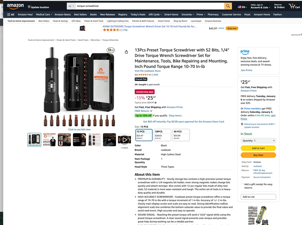

They're supposed to be torqued to 75 inch pounds which doesn't sound like much, but you really can't get a lot of torque out of a screwdriver.
