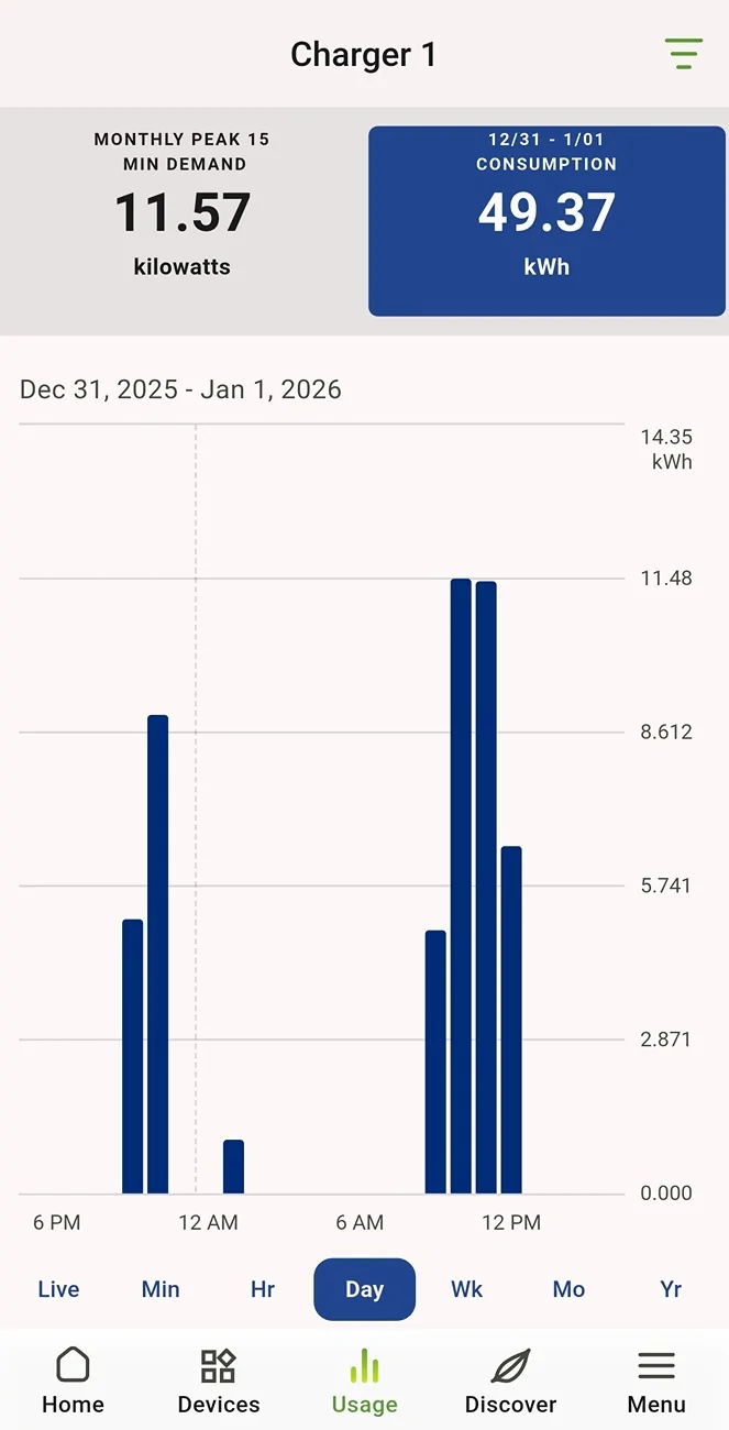

Another +1 for Wallbox : I’ve got a pair of them along with a current clamp on our houses main feed to enaure the total power draw never goes above 180A (we have a 200A service). Works fantastically well, I see it kicking in a couple of times a year when the dryer, oven, hob, pool and AC are all active - it drops charging down from 48A as low as 6 if it needs to.
While I have never had issues with current that I know of, I am intested in increasing safety with all the high current devices our homes have. I’m familiar with current clamp meters, but not familiar with a permanently installed current clamp that can adjust the Wallbox charging current. Would you mind elaborating on your setup?

+1 for the hardwired Emporia. I have Emporia sensors on all my circuits in the breaker box and it is very cool to know just how much power each circuit uses. I don't use the smart capabilities in the EVSE except for monitoring power.

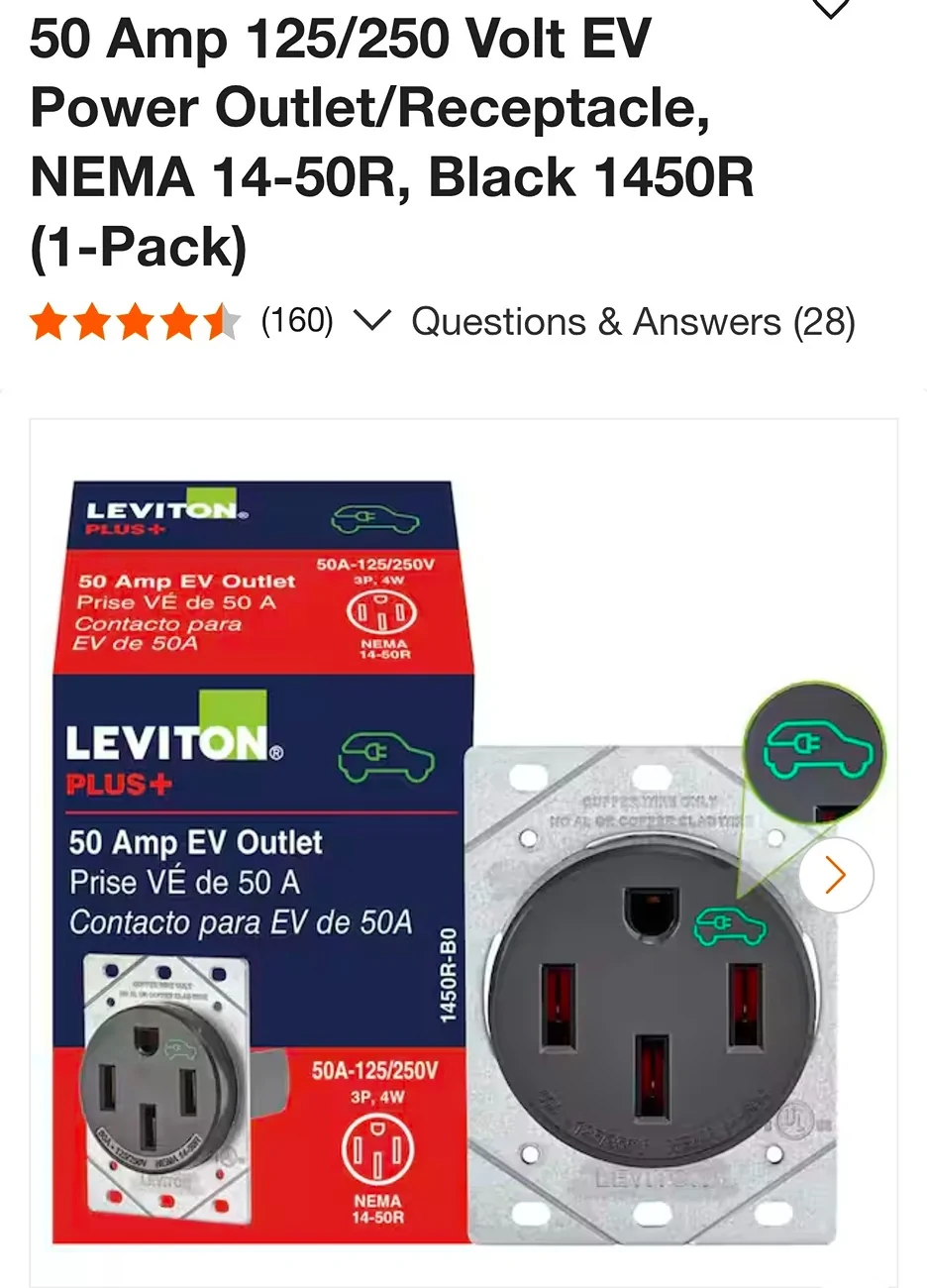

If you go with the 14-50 receptacle, it is imperative that you get a quality socket such as Bryant or Hubbell - not the $20 box store socket. And torque the connections.
The torque rating for these terminals is pretty high. I used a torque wrench on my Tesla UWC to tighten the hex-head terminals. The cheap 14-50R that melted used phillips screws, and gutentight wasn't quite gutenough.
In addition to the Bryant/Hubbell receptacles, Leviton makes a 14-50Rs rated for EVSE use. But coupled with the requirement for a more expensive GFCI breaker (no GFCI needed for hardwired EVSE) and the extra conductor for the neutral line (wire is expensive!), it can be noticeably more expensive to put in a good receptacle.
Home Depot sells the Leviton 14-50R outlet for $41 and it is just as robust as the ones sold by Bryant and Hubbell. It's the real deal.
No, it isn't. It's only rated to 60C, while the Hubble is rated to 75C.
Well, heck. It is very robust, though. Not like the cheap $15 ones.
