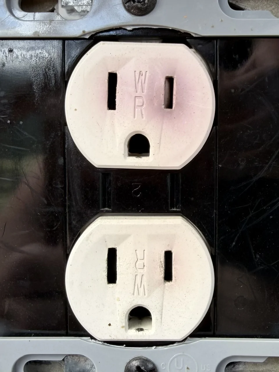

We recently bought a newish cabin and have been L1 charging with the Rivian portable charger on an exterior outlet maybe 30 times (always used the top outlet). Never noticed any excessive heat/errors, but I just noticed the outlet is visibly discolored now. Being newish and only using it to charge, I have is assume the Rivian charger is causing this. How concerned should we be? TIA

You need to replace that outlet now, before you use it again, and check the circuit to make sure the correct size wiring is used.
It's unlikely to be a problem with the mobile charger - if the mobile charger failed and was drawing too much power the breaker would trip (and check the breaker too for correct size - this should be a 15A breaker, and almost certainly should be a GFCI breaker by code). It's far more likely that a poor quality outlet was used, or the person who installed the outlet did a sloppy job of securing the wires. Not uncommon in new(er) construction.
It's unlikely to be a problem with the mobile charger - if the mobile charger failed and was drawing too much power the breaker would trip (and check the breaker too for correct size - this should be a 15A breaker). It's far more likely that a poor quality outlet was used, or the person who installed the outlet did a sloppy job of securing the wires. Not uncommon in new(er) construction.
Thanks, I'll check the breaker and swap out the outlet next time we're up there. Being exterior, should it be replaced with a GFCI?

I don't know what the rules are where you live, but I believe as an external outlet that would usually require GFCI and also probably a cover of some sort.

12+ amp continuous from a standard 120v receptacle is a LOT of heat. The wires are typically rated for 15A (at most 20A) and normally they have a sizeable buffer for continusous load. Over time it's not uncommon to get discoloration.
I've been doing L1 charging for over 9 years, including a year and a half on the R1. L2 finally coming in next week, but yeah, many a night I double-check to make sure the breaker on that circuit is OK :)
Yes, outlets do vary in quality. The connections have to be properly secured. Looping the wires around the screws properly and tightening the the proper torque, etc. Use the proper wire size on push in connections. The socket and plug contacts nead ro be clean and bright.
If the outlet is outside, it should be a GFCI or on a GFCI protected circuit. It should also be W rated. Look for a small W on the face. If it's not in a protected area, it needs a weatherproof cover. There are two types--one for temporary use and the other for continuous use. The difference is whether you are going to leave something plugged in and unattended on a semi-permanent basis.
Shouldn't that be a 20Amp breaker, gfci at the breaker or the outlet? And of course a weatherproof in-use cover.

Thanks for the responses! The pic is zoomed in too far to see it is in a weatherproof box (can fully close when plugged in.).
The outlet in the picture is a 15A outlet, NEMA 5-15. A 20A outlet looks different. I think code allows 15A outlets to be used on a 20A circuit, but the wire would have to be sized for 20A in that case.
With a burned outlet I personally would just get an electrician to do the work, for peace of mind. I think we all are capable of screwing in a new outlet we picked up at Home Depot, but in this case I think it's important to check to make sure the circuit is safe.
I think it's most likely just a bad outlet, maybe due to corroded or loose internal contacts, which resulted in a higher resistance at the contact between the outlet and the plug. The higher resistance converts the power to heat, and the plastic gets discolored. The fact that its discolored means that there's more heat than it was designed for, which is bad, and there could also be some internal melting you can't see. That will only progress, and eventually worst case cause a fire.

I"d get an electrician to take a look at the wiring leading to the outlet and also replace that outlet with a GFCI and weatherproof cover. Even so, I wouldn't recommend pulling more than 10-12 amps continuous and if you're there for a while it never hurts to turn it off for an hour in the middle of your charging session limiting it to 3-4 hours at a stretch. heat soak is a thing.
Right answer is probably have the same electrician wire up a proper NEMA 14-50 (or even 14-30) at 240 volts. 24 amps at 240 volts will give you 5.7kw instead of the 1.44kw you're getting now while frying your outlet.
