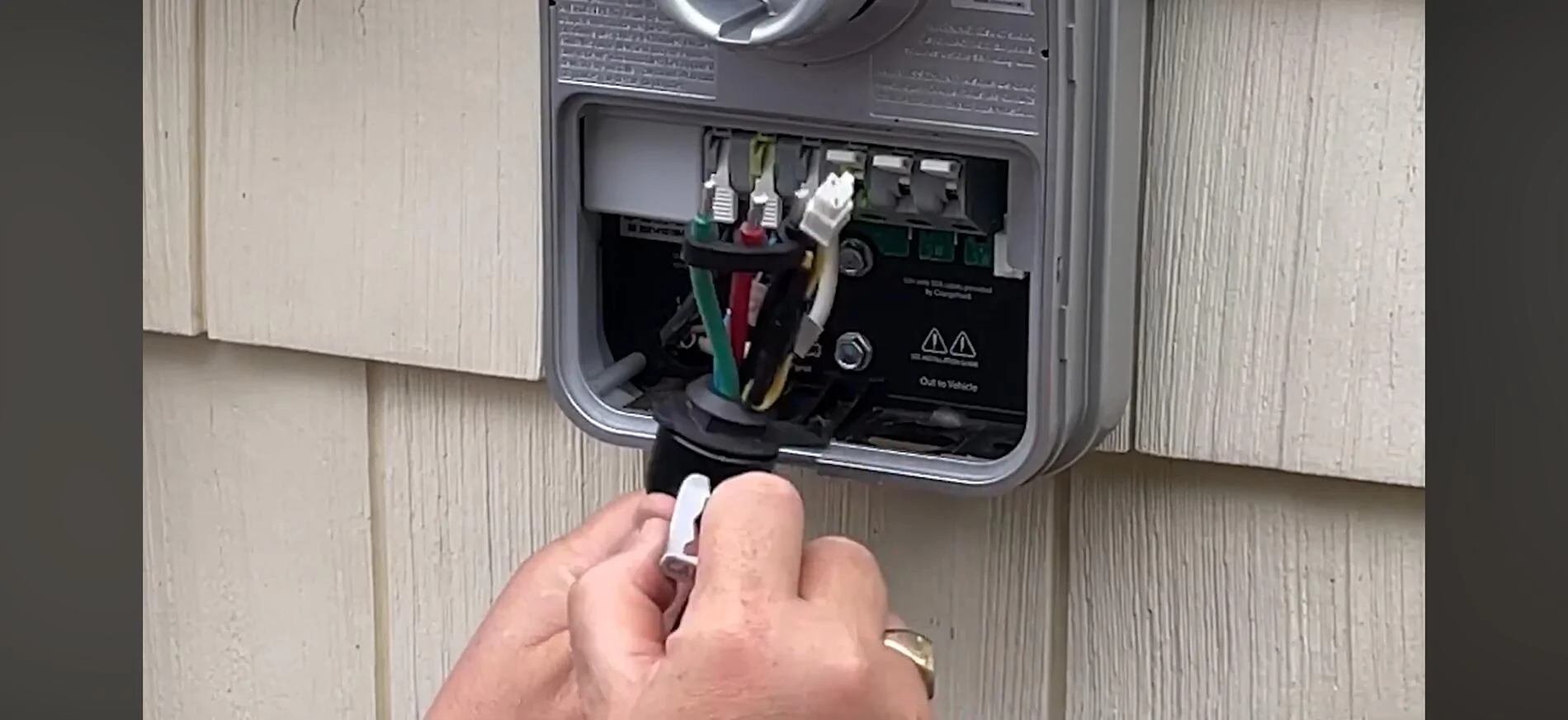

Ok just looked up NACS and J1772..... they each have 5 wires, biggest two are hot1 and hot2. Smaller ground wire. Then two tiny signal wires. So switching a J1772 cable to NACS would require 5 connections in the EVSE.

Ah yes, thanks for correcting me.
Pulled this from a YouTube video. 5 wires indeed. Definitely looks like 2 hots and a ground + 2 signal wires to a custom connector.

There's a control pilot and proximity pilot. One to tell the car how fast to charge and one to verify the connector is connected and it's safe to energize. The ground is there to protect in case there is high voltage leakage into the car body. The power leads supply either single phase or split phase to the car.
A lot of J1772 handles don't wire the 5th wire (proximity) back to the EVSE, they just loop it from the ground wire, with the switch, and back into the connector. I suspect Rivian is doing this too, because they're only showing one pilot cable getting wired into the box.
In the EU, they use it so the station can identify the capability of the cable plugged into the station, since it's popular to just have a socket on the station and bring-your-own-cable.
I think it should be trivial to replace the J1772 cable with a NACS one, but I have no reason to bother trying, personally.
