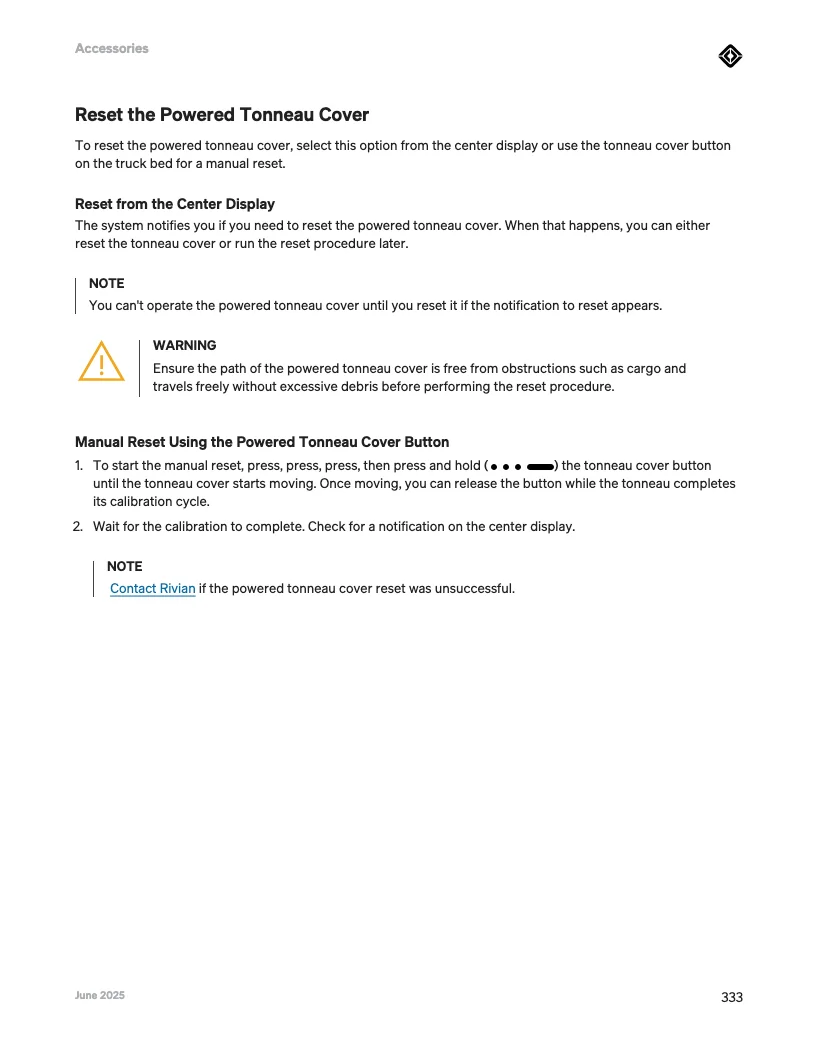

Well, it just outright lied to me. I decided to finally open a ticket for my PTC, as it started to misbehave (doesn't open all the way, makes a bit of a grinding sound when it tries, closes all the way, then tries to keep going, makes a grinding sound, then decides something is in the way (even though it's at the stops) and complains and backs off. I had to hit the button to "stop it closing" when it was actually at the stops, but the system would always claim it was still open a bit.)
It walked me through a bunch of "pick a number" answers. I answered them, it said it would open a ticket, and summarized what I tried. One of the answers was "Were you prompted on the infotainment screen to do a calibration, and did you do it?" No, I did not, because I never saw such a prompt. The summary was "you tried a calibration and it did not work."
I told it "you say I tried a calibration, I did not, because I never saw a notification to do so."
It then replied "I told you how to do a manual calibration."
NO YOU DIDN'T!
"Yes I did."
"No, you didn't. Please tell me how to do it."
"Oh, sorry, here's how to do it."
That solved it. (The way is to open it, then rapidly "press the tonneau button four times, and hold it down on the fourth press until the calibration starts.")
8,785
12,044
Isn't this in the Owner Guide? reset procedure.

Huh. I didn't find it when I looked, but maybe I was looking in the wrong spot.
Hard to search if on iOS browser (or I'm just not aware of trick) and easy to miss things. Keyword search is much easier in desktop browser.
