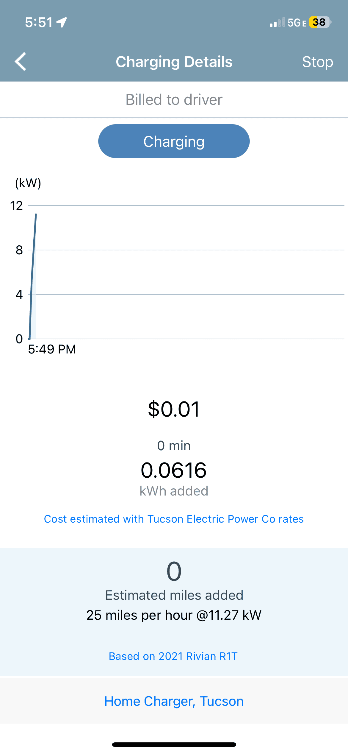

Ima jump on the 48a train. Great seeing these 11+kw rates.
Rivian R1T R1S 48A vs. 40A for home charging?? IMG_9278
