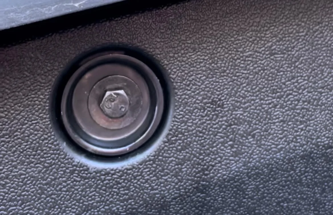

Been asking for an owner to pull the round disk in the bed to check for bolts/nuts for a month and no one responded.
Thanks to you I can see that I can attach some L track and front wheel chocks behind the bed!

Thought I replied….here you go. 10mm head.
